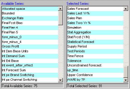

The Business Modeler displays the Available Series and Selected Series lists.
Select the series that should be available in the component.
Move all series that you want into the Selected Series list, using any of the techniques in “Working with Lists”.
Remove any unwanted series from the Selected Series list.
When you are done specifying series, click Next.

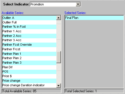

The Business Modeler displays the Select Component Indicators for Series window. Here you specify which series should have indicators to indicate associated promotions or notes.
Within a worksheet, a user can attach a promotion (in the case of Promotion Effectiveness) or a note to a given item-location combination, at a given date. If a series has been configured as using an indicator for that particular promotion or note, the series will be displayed with an indicator in all worksheet cells that correspond to that item-location combination and date.
You can associate an indicator for any general level at the lowest level (that is, any general level that do not have child levels).
The default associations are different for different kinds of series. Sales series have notes indicators by default. Promotion series have both notes and promotion indicators by default.
This configuration affects all users of this component. No further fine tuning is possible.
To associate indicators with different series, do the following for each general level:
In Select Indicator, select the general level, either Note or Promotion.
Move all series that should use the associated indicator into the Selected Series list, using any of the techniques in “Working with Lists”.
Click Next.

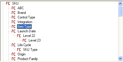

The system displays all the levels and indicates the current permission settings in this component.
The following icons indicate the permissions:
| FC | Full control (including permission to delete members) |
| W | Read/write access |
| R | Read access |
| X | No access |
For each level that you want to change, right-click the level and select the appropriate permission:
No Access (the user does not have access to this member; this option is equivalent to not including this member in the filter)
Read Only (the user can view this member but cannot make any changes)
Write (the user can view or edit this member)
Full Control (user can view, edit, create, and delete within this member)
System Default (use the default permission controlled by the DefaultLevelSecurityAccess parameter.
Note: By default, this configuration affects all users of this component. To fine tune permissions for a given user, see “Creating or Modifying a User”.
Click Next.

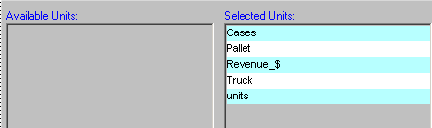

The system displays the Available Units and Selected Units lists.
Select the units of measure that should be available in the component.
Move all units that you want into the Selected Units list, using any of the techniques in “Working with Lists”.
Remove any unwanted units from the Selected Units list.
Note: This configuration affects all users of this component. No further fine tuning is possible.
Click Next.

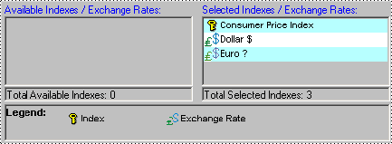

Select the indexes and exchange rates that should be available in the component.
Move all indexes and exchange rates that you want into the Selected Indexes and Exchange Rates list, using any of the techniques in “Working with Lists”.
Remove any unwanted indexes and exchange rates from the Selected Indexes and Exchange Rates list.
Click Next.

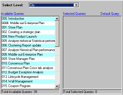

The next dialog box allows you to associate public worksheets with levels.
This association is used in two ways:
Within the Members Browser, a user can use the right-click menu to open any of these associated worksheets directly from a member of the level (via the Open With menu option). In this case, Demantra opens the associated worksheet. The worksheet is filtered to show only data relevant to the member.
A worksheet can include an embedded worksheet that shows details for the member that is currently selected in the worksheet. Specifically, within the worksheet designer, users can add a subtab to a worksheet. The subtab consists of any of the worksheets that are associated with a level included in the main worksheet. The embedded worksheet is filtered to show only data relevant to the member.
At this point, do one of the following:
To continue without associating any worksheets and levels, click Next.
To associate a worksheet with a level, do the following:
Click the level in the Select Level dropdown menu.
Double-click the worksheet in Available Queries list, which moves it to the Selected Queries list.
Move other worksheets from the Available Queries list to the Selected Queries list, as needed.
Decide which worksheet in the Selected Queries list should be the default worksheet for this level. For that worksheet, click the Default check box. When the user right-clicks and selects Open, this is the worksheet that will be used.
When you are done on this screen, click Next.

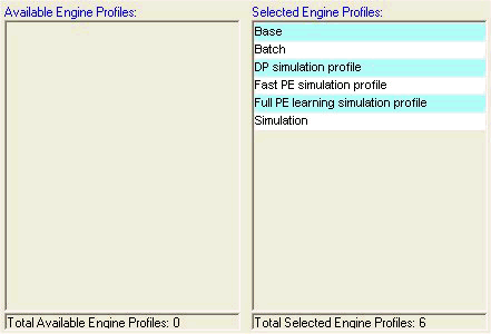

If you are using the PE Analytical Engine, the system displays engine profiles that could potentially be used within this component. The Business Modeler displays the Available Engine Profiles and Selected Engine Profiles lists.
Select the engine profiles that should be available in the component. Profiles can be used only with the Promotion Effectiveness engine.
Move all profiles that you want into the Selected Engine Profiles list, using any of the techniques in “Working with Lists”.
Remove any unwanted profiles from the Selected Engine Profiles list.
When you are done specifying profiles, click Next.
