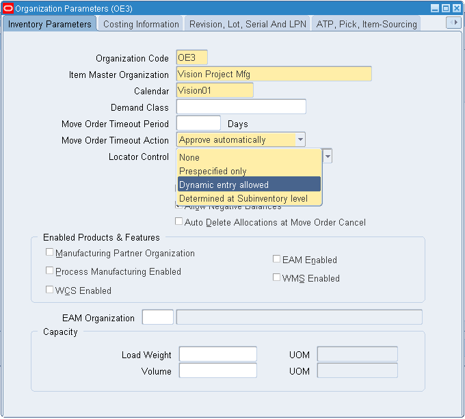

Inventory Parameters
For Seiban-Based Manufacturing, Locator Control should be defined as dynamic entry allowed in Inventory parameters for both the OEM and MP organizations.
To set up Seiban inventory parameters
  1. From the Inventory responsibility, navigate to the Organization Parameters window.
    the picture is described in the document text
    You use locator control to identify project inventory.
  2. Save your work.

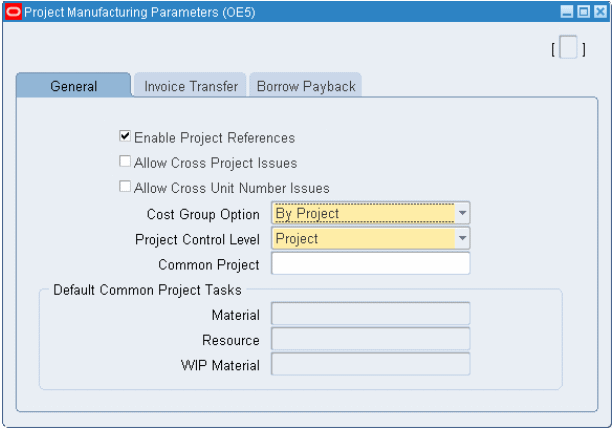

Project Manufacturing Parameters

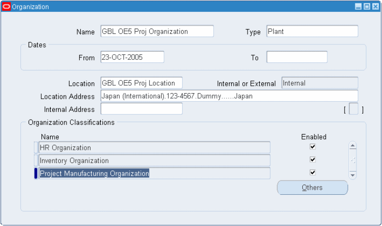

Define the OEM and MP organizations as Project Manufacturing Organizations by adding Organization Classification as Project Manufacturing for both.
  1. From the Inventory responsibility, navigate to the Organization window.
  2. Navigate to the Project Manufacturing Parameters window, and click the General tab.
  3. Select the Enable Project References indicator.
  4. Set Project Control Level to Project.
  5. Save your work.

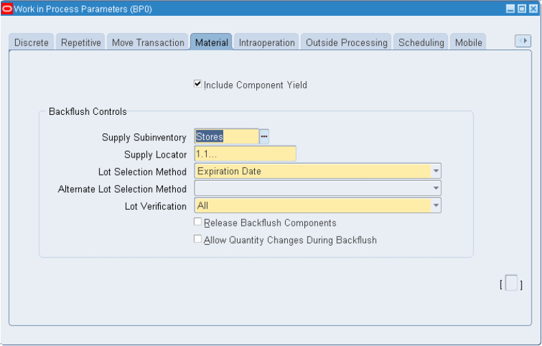

To define WIP parameters
Seiban-Based Manufacturing uses locator-controlled subinventories for inventory transactions. To support the simulation of discrete jobs in the MP organization, supply subinventory should be a locator-controlled subinventory. Interlock Manager creates WIP jobs with this subinventory as component subinventory for back flushing. The Auto Receive concurrent program also receives components into this subinventory for simulation.
  1. Navigate to the Work in Process Parameters window.
  2. Select the Material tab and associate Locator Controlled Subinventory as Supply Subinventory. In addition, associate Supply Locator leaving Project/Task as blank. (For details about Locators in PJM, refer to the Oracle Project Manufacturing User's Guide.)
  3. Save your work.

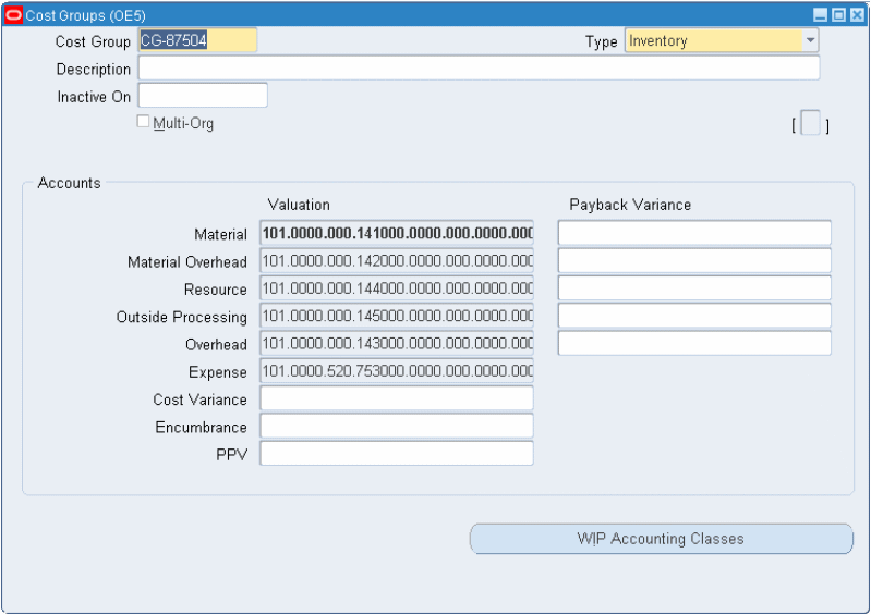

Defining Cost Groups for MP Organizations
You must define Cost groups and associate a WIP accounting class (defined at the time of creating the WIP parameters for MP organizations). This action is required for simulating WIP jobs by project numbers, and it is part of the Project Manufacturing (PJM) setup.
See: Oracle Project Manufacturing User's Guide
The MP organization is a zero-cost organization, and transfer to general ledger is set to No. Cost group setup is required to facilitate the simulation of assembly manufacturing in the MP organization using discrete jobs and project numbers. This setup does not have financial implications.
To define cost groups for MP organizations

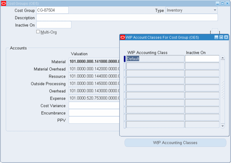

  1. From the Cost Management responsibility, navigate to the Cost Groups window.
  2. Define the cost group with Type set to Inventory. You can use any existing cost group.
  3. Click WIP Accounting Classes to define WIP Accounting Classes for this cost group (use the same WIP accounting class defined at the time of defining WIP Parameters of MP Organization). The WIP Account Classes for Cost Group window appears.
  4. Save your work.

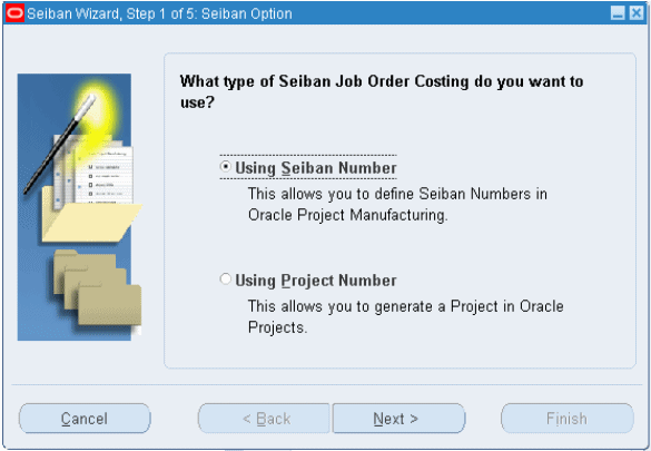

Defining Seiban Numbers
Before you plan and execute subcontracting in Seiban-Based Manufacturing environments, you define project numbers.
To define Seiban numbers

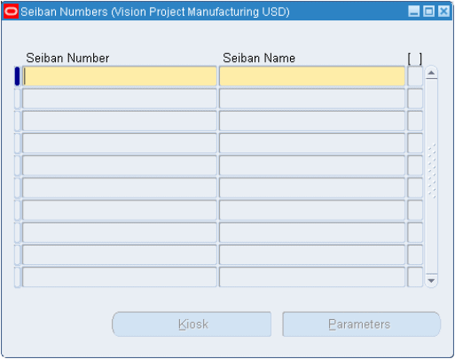

  1. From the Project Manufacturing responsibility, navigate to the Seiban Wizard.
  2. Select the Using Seiban Number indicator and click Next. The Seiban window appears.

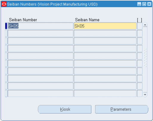

  3. Enter Seiban (project) Numbers.
  4. Save your work.

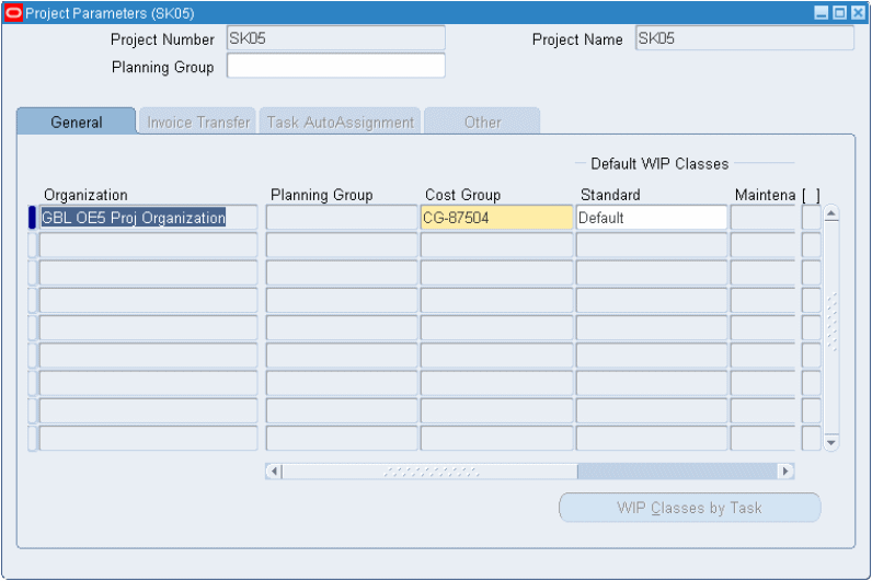

  5. Click Parameters to define the parameters for the Seiban Number (project). The Project Parameters window appears.
  6. Select the General tab and enter Inventory Organizations that use the project numbers. In this scenario, the OEM and MP organizations should be included.
  7. Associate a cost group, which was defined in the previous procedure.
  8. Associate a WIP Accounting Class. This value should be same as the WIP accounting class associated with the WIP parameters of the MP organization.
  9. Save your work.

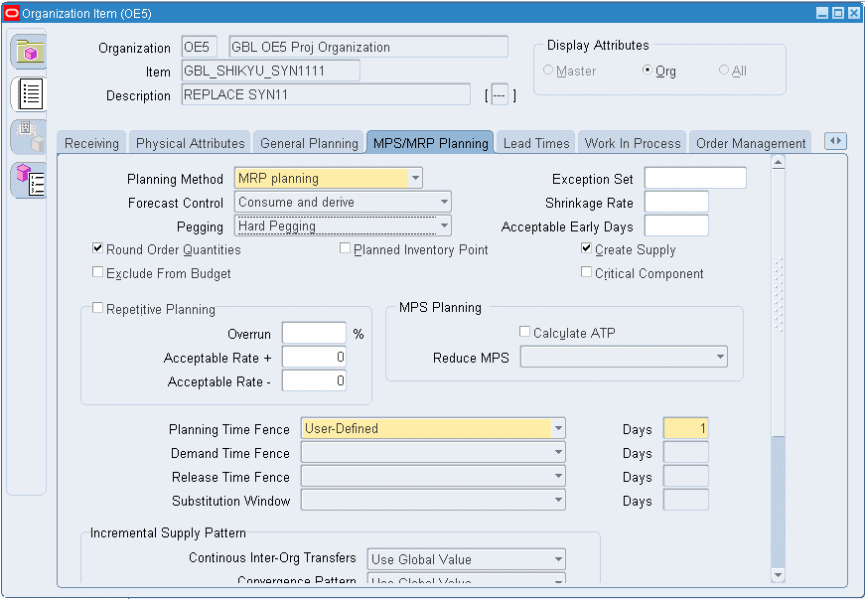

Organization Items
In Seiban-Based Manufacturing, outsourced assemblies and components must be defined as hard pegged items for planning and execution using Seiban numbers.
To define items as hard pegged
  1. From the Inventory responsibility, navigate to the Organization Item window.
  2. Select the MPS/MRP Planning tab, and set the attribute Pegging to Hard Pegging. This information is used to for planning the demand and supply by project numbers.
  3. Save your work.
    All outsourced assemblies and subcontracting components should be defined as hard pegged in both OEM and MP organizations.

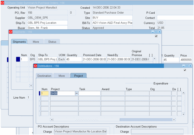

Note: Subcontracting Orders and Replenishment Purchase Orders of the pre-positioned components should always have one Shipment and Distribution for every purchase order line. Multiple shipments and distributions are not supported. When you create subcontracting orders and replenishment purchase orders manually, you can create multiple purchase order lines. However, only one shipment and distribution is allowed for each purchase order line. Interlock Manager discards purchase order lines if it has more than one shipment or distribution for each PO line, and it will not process them.
