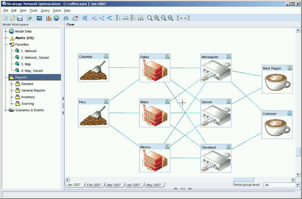

Click to jump to top of pageClick to jump to parent topicAn Example of Building a Report
When building a report query, you need to know what you want to show in your report. In this example, suppose you want to produce a report which displays the flow of all the coffee brands from all of the distribution centers to all of the customers. You could get this information by going into the model and manually performing individual arc queries. However, you would have to do many individual arc queries in each period. This could be very time consuming, not visually appealing, and prone to human error, especially in large models.
An example of building a report
Now that you have decided what information you want to see in your report, you need to figure out where that information is located in your model. You determine that the information you want to extract resides in arcs which flow from StorageDemand nodes into Demand nodes. Next, you construct a report query which will extract data from all the arcs that flow from StorageDemand nodes into Demand Nodes.

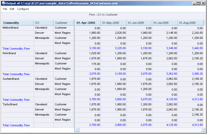

When you run this report, the Data Editor appears, as seen here below:
The Data Editor
Strategic Network Optimization extracts the requested information and puts it in a table format in the Data Editor. From here, you can save or export this report. When using the Data Editor, you can copy and paste data from one cell to another. You can copy from and paste to multiple cells by using Shift + arrow keys or Shift + left-click at the end of a range of cells. You can use Ctrl C , Ctrl V, or select copy and paste from right-click menus.

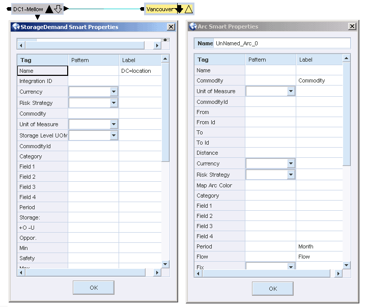

To set up a report query:
  1. In a report query, right-click a node or arc from which you want to extract data.
  2. Select Node Properties or Arc Properties.
  3. In the Report Properties window, enter a heading for each field from which you want to extract data in the Label column.
    Data is extracted only from fields that have a heading in the Label column. Extracted data appears in the Data Editor under the headings that you enter.
    You can also enter report overrides in the Label column. Report overrides enable you to extract information about items that you cannot find directly in a report query. For example, you can use report overrides to find the total amount of commodities flowing into or out of a node.
  4. If you want to extract data only from nodes or arcs that meet certain criteria, enter search expressions in the Pattern column.
    You can use any search expression that you can use for Find functions.
  5. Click OK.

Click to jump to top of pageClick to jump to parent topicReport Overrides Example
The following example demonstrates how to do use report overrides to extract sourcing information from your model. Suppose you have three plants (P1, P2, and P3) represented by three block nodes, and three distribution centers (DC1, DC2, and DC3) represented by three block nodes.
All three plants ship to all three distribution centers, and you want to find the following information:
The following table shows what you need to do to extract this information. This table includes using a combination of the regular report information and overrides. Enter this information in the report query for the nodes that represent distribution centers:
Information wanted
In the Label field, enter:
Name of product that is shipped
Product=commoditydescription
Period in which it is shipped
A label. This value is from the Period data field.
Location (or name) of the plant
Plant=location
Location (or name) of the distribution center
DC=location
The amount of commodity that is shipped to one distribution center
A label. This value is from the Flow data field.
Total amount of all the commodities shipped into one distribution center
TotalShipment=inflow

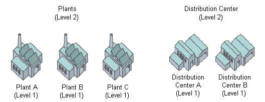

Click to jump to top of pageClick to jump to parent topicParent Block Levels in Report Overrides
In some report overrides, you must specify the level of the parent block in which you are interested in. For example, specifying the override Name=blockname:2 extracts the name of the block two levels higher than the current node. If no such block exists, the name of the highest block is used.
Nested blocks are numbered from the innermost to the outermost level. For example, in the diagram below, each rectangle represents a block. Individual plants and distribution centers are level 1 blocks, plants and distribution centers are level 2 blocks, and facilities in South is a level 3 block. To determine the longitude of the facilities in South block, you could run a report query for a node in the Plant A block, and enter longitude:3 in the Label field.
Example
For example, consider the following Properties window. The Tag ov (blockname:1) is specified in one of the blank rows.
When the report query is applied, the resulting Data Editor shows both the name of the node (with the label NAME) and the block node to which the node belongs (with the label BLOCK).
