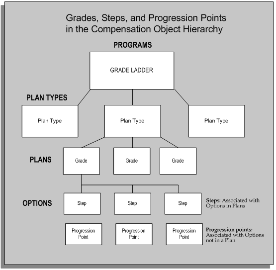

The following graphic illustrates the grade ladder structure within the Compensation Hierarchy.
