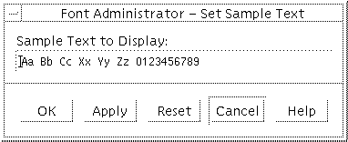

To set the default sample text:
Select Set Sample Text from the Options menu.
On the Set Sample Text dialog, click in the text box and type the desired text.
Click OK or Apply to save the sample text setting.
