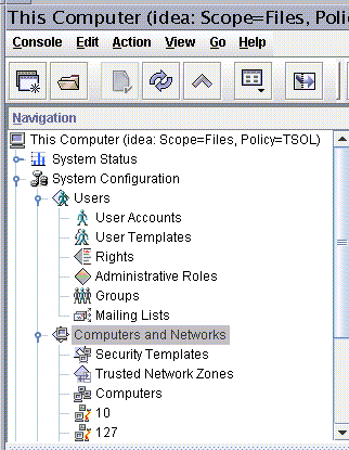

Figure 4-1 shows a This Computer (this-host: Scope=Files, Policy=TSOL) toolbox. Trusted Extensions modifies tools under the System Configuration node.
![]() | Caution - Do not choose a toolbox that has no policy. Toolboxes without a listed policy do not support Trusted Extensions. |

The following figure shows a This Computer (this-host: Scope=Files, Policy=TSOL) toolbox. Trusted Extensions modifies tools under the System Configuration node.
Figure 4-1 Trusted Extensions Tools in the Solaris Management Console
