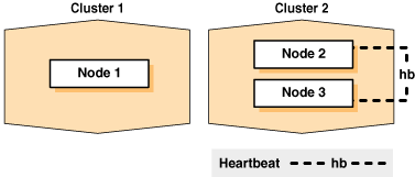

This section explains how to create a cluster by cloning a successfully installed Oracle Clusterware environment and copying it to the nodes on the destination cluster. The procedures in this section describe how to use cloning for Linux, UNIX, and Windows systems. OCR and voting disks are not shared between the two clusters after you successfully create a cluster from a clone.
For example, you can use cloning to quickly duplicate a successfully installed Oracle Clusterware environment to create a cluster. Figure 3-1 shows the result of a cloning procedure in which the Oracle Grid Infrastructure home on Node 1 has been cloned to Node 2 and Node 3 on Cluster 2, making Cluster 2 a new two-node cluster.
Figure 3-1 Cloning to Create a Oracle Clusterware Environment
The steps to create a cluster through cloning are as follows:

Figure 3-2 Cloning to Add Nodes to a Cluster
Using Figure 3-2 as an example, the following procedure explains how to add nodes to a cluster using cloning. In this procedure, Node 1 is the source node from which you obtain the cloned copy, and Node 2 is the destination node, to which you copy the clone of Node 1:
