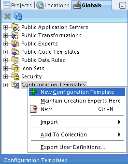

In the Globals Navigator, select Configuration Templates.
Right-click Configuration Templates, and select New Configuration Template.

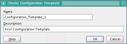

The Create Configuration Template wizard opens. Note that on every screen of the wizard, you have the option of clicking Help to get more information.
On the Name and Description screen, enter the Name of the new configuration template, and optionally, its Description.
Click OK.
The new Configuration Template appears in the right pane of the OWB console.

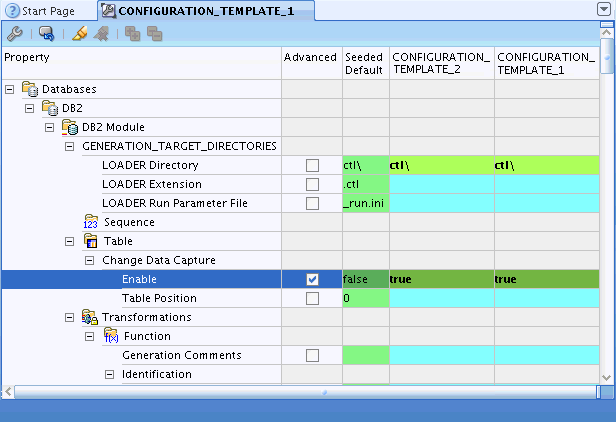

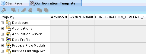

To edit the configuration values in a template, use the Configuration Template Editor, which allows you to set the configuration properties of objects to Advanced, and to override the existing configuration defaults.
Note that the configuration template editor can show the different templates side by side, to make it easier to compare and edit multiple templates.
To edit a configuration template:
In the Globals Navigator, under Configuration Templates, click the Manage Configuration Template Columns icon.
In the Select Templates window, select the templates you want to edit.
Click OK.
Click the Expand All icon.
Make changes to the side-by-side templates.

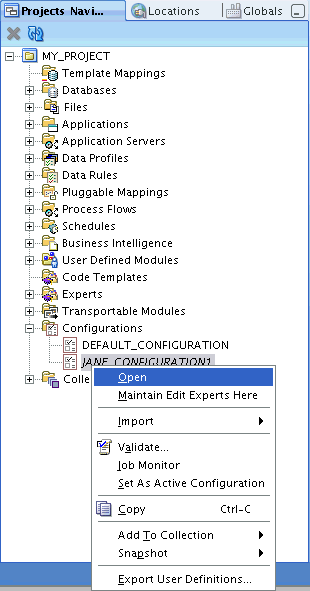

In the Project Navigator, select a project and expand its navigation tree.
Expand the Configurations folder.
Select a configuration.
Right-click the selected configuration; from the menu, select Set As Active Configuration.
All changes that you make to the configuration parameters of objects are saved in this configuration. If you switch to the previous configuration, these parameters show the settings of that configuration.
The Control Center service and Control Center Agent associated with this configuration are now set; they manage all future deployments or executions.

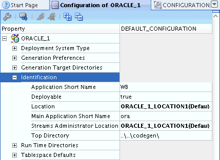

When you choose the Configure option for any object, it shows the set of configuration properties with the default values that are defined in the Configuration Template. You can expand the Property tree to see all properties.
Configuration defines the physical characteristics of data objects. These may include defining a tablespace and setting performance parameters in the configuration of a table.

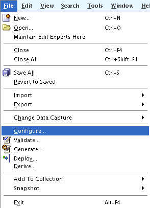

In the Project Navigator, select the object to configure.
In the File menu, click Configure.
The Configuration editor is displayed.
Select a parameter to display and edit its value in the right-side panel.
Click Help for additional information.
