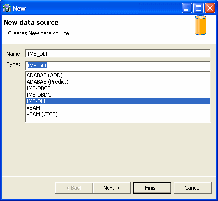

In Oracle Studio for IMS, VSAM, and Adabas Gateways, in the Configuration view of the Design perspective, open the binding of the system where the data is located.
Right-click Data Source and select New Data Source.
The New Data Source screen opens, as shown in Figure 5-2.
Specify a name for the data source in the Name field.
Select IMS-DLI from the Type list.
Click Next.
The Data Source Connect String screen opens.
Click Finish.
After defining the connection, you can set the data source properties.

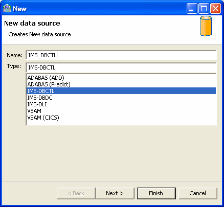

The New Data Source screen opens, as shown in Figure 5-3.
Select IMS-DBCTL from the Type list.
Click Next.

The IMS/DB DBCTL data source accesses IMS/DB data under IMS/TM.
To access IMS/DB data under IMS/TM
Copy the ATYDBDC
program from NAVROOT.LOAD
to an IMS/TM program library (such as IMS.PGMLIB
) with the name of the PSB used to access the IMS/DB data.
Define an IMS transaction to point to the program, using statements similar to the following:
APPLCTN PSB=ATYDBDC,SCHDTYP=PARALLELTRANSACT CODE=ATYIMSTM,PRTY=(7,10,2),INQUIRY=NO,MODE=SNGL,EDIT=ULC
The default transaction name is ATYIMSTM.
If you use a different transaction, the transaction name must be less than or equal to eight characters and you must specify this value in the imsTransname
data source property in the binding.
Set up OTMA, as described in the Oracle Connect for IMS, VSAM, and Adabas Gateways Installation and Configuration Guide for IBM z/OS.

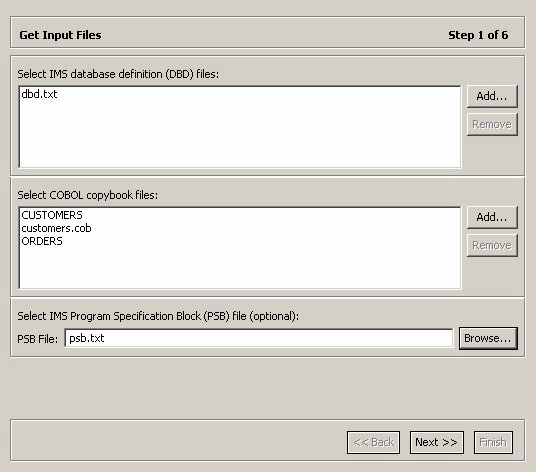

This section describes the steps required to select the input files that will be used to generate the metadata. The IMS/DB data source requires three types of files, DBD files, COBOL copybooks, and PSB source files. See Select the Input Files for an explanation of these files.
Perform the following task to enter the input files.
In the Configuration view, right-click the data source and select Edit Metadata.
The Metadata tab is displayed with the data source displayed in the Metadata view.
Right-click the Imports node under the data source and select the New Import menu option.
Enter a name for the import. The name can contain letters, numbers and the underscore character.
Select IMS/DB Import Manager as the import type.
Click Finish. The Metadata Import Wizard is displayed.

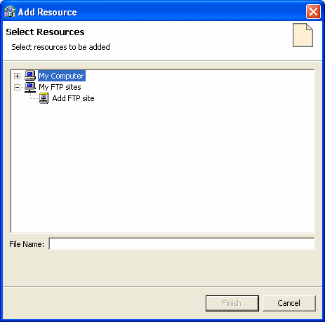

Click Add in the Import Wizard to add DBD files. The Add Resource screen opens, providing the option of selecting files from the local system or copying the files from another system.
Figure 5-5 shows the Add Resource screen.
If the files are located on a UNIX or Windows computer, do the following:
Right-click My FTP Sites and select Add.
The Add FTP Site screen opens, as shown in the following figure.
Enter the server name where the COBOL copybooks are located and, if not using an anonymous connection, enter a valid username and password to access the computer. The username is then used as the high-level qualifier.
Click OK. After accessing the remote computer, you can change the high-level qualifier by right-clicking the system in the Add Resource screen and selecting Change Root Directory.
Select the files to import and click Finish to start the file transfer. When complete, the selected files are displayed in the Get Input Files screen.
To remove any of these files, select the required file and click Remove.
Repeat the procedure for COBOL copybooks.
The format of the COBOL copybooks must be the same. For example, you cannot import a COBOL copybook that uses the first six columns together with a COBOL copybook that ignores the first six columns. In this type of case, repeat the import process.
You can import the metadata from one COBOL copybook and later add to this metadata by repeating the import using different COBOL copybooks.
Click Add in the Import wizard to add a PSB source file, if necessary.
The selected files are displayed in the Get Input Files screen, as shown in Figure 5-6.
Click Next to go to the Apply Filters task.

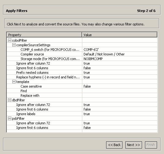

This section describes the steps required to apply filters on the COBOL Copybook files used to generate the Metadata. It continues the Select the Input Files task.
Perform the following task to apply filters.
Click Next.
The Apply Filters screen opens in the editor, as shown in Figure 5-7.
Apply filters to the copybooks, as needed.
The following COBOL filters are available:
COMP_6 switch: The MicroFocus COMP-6 compiler directive. Specify either COMP-6'1' to treat COMP-6 as a COMP data type or COMP-6'2' to treat COMP-6 as a COMP-3 data type.
Compiler source: The compiler vendor.
Storage mode: The MicroFocus Integer Storage Mode. Specify either NOIBMCOMP for byte storage mode or IBMCOMP for word storage mode.
Ignore after column 72: Ignore columns 73 to 80 in the COBOL copybooks.
Ignore first 6 columns: Ignore the first six columns in the COBOL copybooks.
Prefix nested column: Prefix all nested columns with the previous level heading.
Replace hyphens (-) in record and field names with underscores (_): A hyphen, which is an invalid character in Oracle metadata, is replaced with an underscore.
Case sensitive: Specifies whether to consider case sensitivity or not.
Find: Searches for the specified value.
Replace with: Replaces the value specified for in the Find field with the value specified here.
The following DBD filters are available:
Ignore labels: Ignore labels in the DBD files.
The following PSB filters are available:
Click Next to go to the Select Tables task.

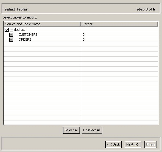

This section describes the steps required to select the tables from the COBOL Copybooks.
The following task continues the Apply Filters task.
From the Select Tables screen, select the tables that you want to access. To select all tables, click Select All. To clear all the selected tables, click Unselect All.
Figure 5-8 shows the Select Tables screen.
The import manager identifies the names of the segments in the DBD files that will be imported as tables.

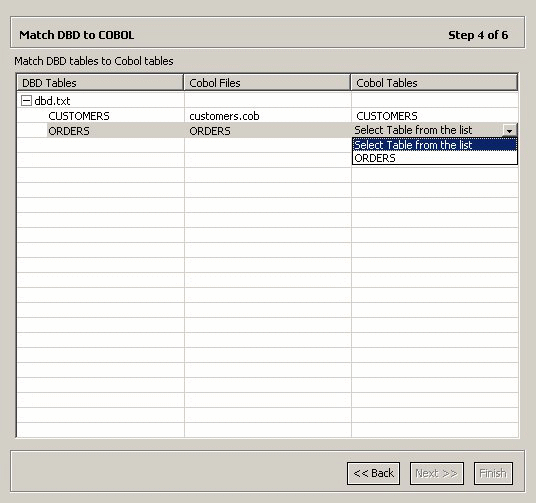

Click Next to continue to the Match DBD to COBOL task.
The Import Manipulation screen open.
This step lets you match the DBD file to your COBOL copybook. It is a continuation of the Select Tables task. Figure 5-9 shows the DBD to COBOL task that is displayed in the Editor.
Match each table selected from the DBD file with the COBOL copybook that contains the relevant table structure. Select the files and tables from the lists for each DBD entry.
Click Next to continue to the Manipulate the Imported Records task.

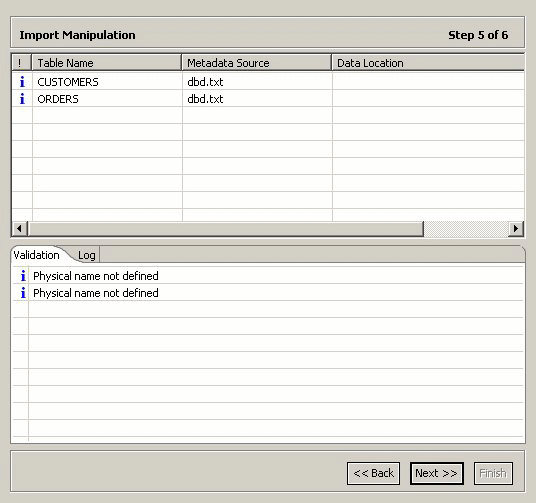

The Import Manipulation screen opens.
If required, you can now manipulate the imported records. This is an optional task.
This section describes the operations available for manipulating the imported records (tables). It continues the Select Tables task.
The import manager identifies the names of the records in the DDM Declaration files that will be imported as tables. You can manipulate the general table data in the Import Manipulation Screen.
Repeat the following step for all table records marked with a validation error. You resolve the issues in the Import Manipulation Screen.
From the Import Manipulation screen (see Import Manipulation Screen figure), right-click the table record marked with a validation error, and select the relevant operation. See the Table Manipulation Options table, for the available operations.
Click Next to continue to the Select the Metadata Model task.
Figure 5-10 shows the Import Manipulation screen.
The upper area of the screen lists the DDM Declaration files and their validation status. The metadata source and location are also listed.
The Validation tab at the lower area of the screen displays information about what needs to be resolved in order to validate the tables and fields generated from the COBOL. The Log tab displays a log of what has been performed (such as renaming a table or specifying a data location).
The following operations are available in the Import Manipulation screen:
Resolving table names, where tables with the same name are generated from different files during the import.
Selecting the physical location for the data.
Selecting table attributes.
Manipulating the fields generated from the COBOL, as follows:
Merging sequential fields into one (for simple fields).
Resolving variants by either marking a selector field or specifying that only one case of the variant is relevant.
Adding, deleting, hiding, or renaming fields.
Changing a data type.
Setting the field size and scale.
Changing the order of the fields.
Setting a field as nullable.
Selecting a counter field for the dimension of an array field. You can select the array counter field from a list of potential fields.
Setting column-wise normalization for fields with dimensions (arrays). You can create new fields instead of the array field where the number of generated fields will be determined by the array dimension.
Creating arrays and setting the array dimension.
The following table describes the available operations when you right-click a table entry.
