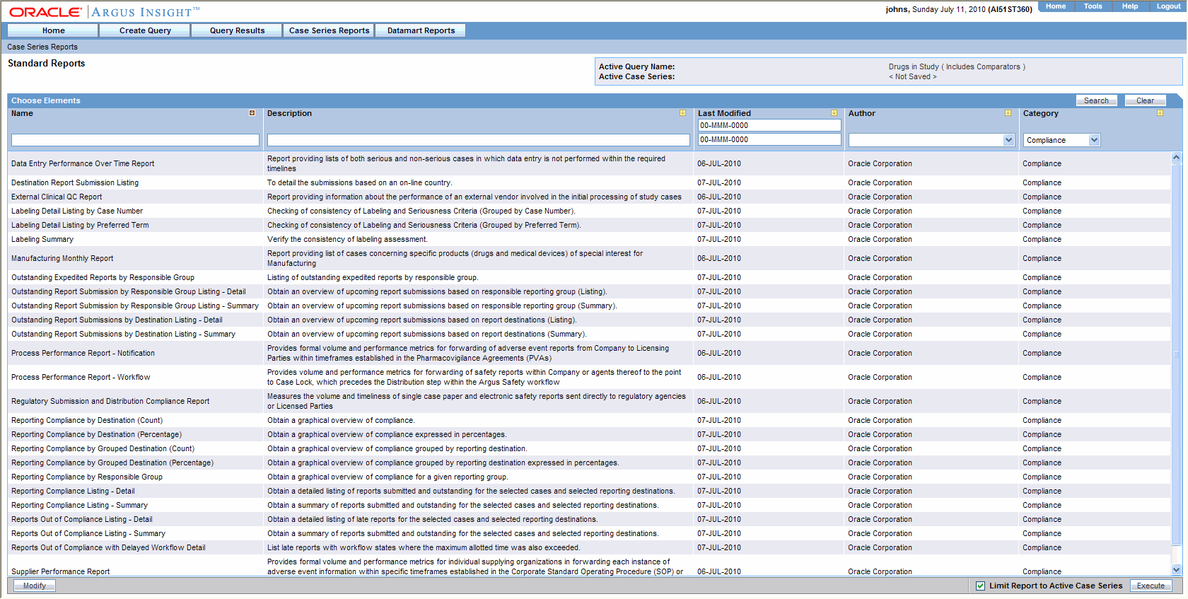

Use the following procedure to access the Reports page for any category. For instance, if you select Compliance Reports, execute the following steps:
  1. Select the Case Series Reports > Standard Reports >Compliance. The Standard Reports page displays a list of all the standard Compliance reports. The description of a report is displayed next to its name.
    Surrounding text describes stdcomp.gif.
  2. Select the report that you want to generate.
  3. Select the Limit to Active Case Series checkbox to generate the report on the Active Case Series.
    Select the Limit to Active Case Series checkbox before generating the report. This prevents the report from querying the entire datamart and slowing down the report output generation. Use the following procedure to view the Active Case Series, select Query Results > Case Series > Active in Argus Insight. If you want to make another Case Series active, select Query Results > Case Series > Library in Argus Insight. In the Case Series Library page that appears, check the Case Series you want to make active and click Make Active.

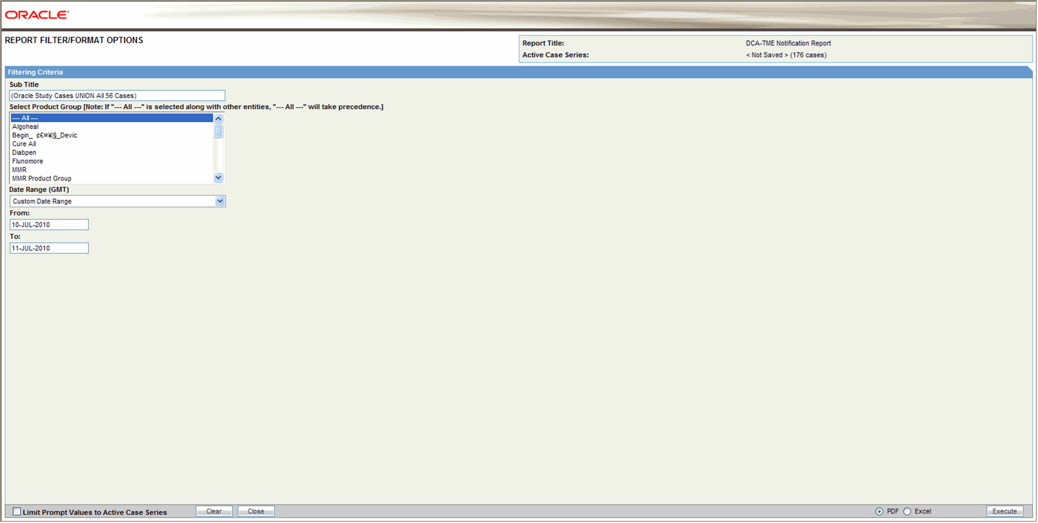

  4. Click Execute to generate the report. A new browser window displays the pre-filter options in the Report Filter page. The following pre-filter elements may be available depending on the type of information the report displays.
    Surrounding text describes prefilter.gif.
    • List box - this element lets you filter the report output by specifying a single value from the list; for example, the country of incidence, a regulatory authority, or a pre-defined date range. List boxes may also contain options for grouping the report output; for example, grouping by age group or product name
    • Multiple selection lists - this element lets you filter the report output by multiple values you select from the list; for example, license countries or report types.
      If All is selected along with other entities for a category, then all the items under that category are searched.
    • Text boxes - this element lets you filter the report output by specifying a numerical value for timelines or dates for date ranges. All the report pre-filter pages contain a text box for specifying a sub-title for the report
    • The Pre-filter page can display values in Prompts. By default, prompts on the Pre-filter page display values from LM tables.
    • By default, a checkbox called Limit Prompts Values to Active Case Series is displayed on the Pre-filter page. You can check this checkbox to generate pre-filter prompts and view values limited to the cases in the case series. This impacts only those prompts which are populated from case tables and corresponding LM tables exist for that prompt.
    • Custom prompts created by the user for ad-hoc reporting do not have the option of displaying values in prompts from LM tables. Custom prompts always display data as per the conditions (SQL) that were defined during the creation of the prompts.

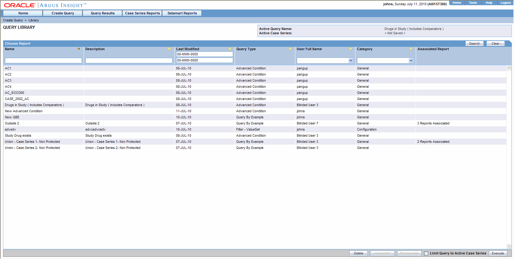

On clicking the Associate button from the query library, only one report is selected. If a different report is chosen for the query, the system prompts the user is to change. The system permits the user to associate many reports with a single query.
  • The user can select any query from any library (QBE/Filters/AC) and click Associate.
  • The user can use the Query Library and the Associated Query Library to schedule an association.
  • Since multiple reports can be associated with a single query on these Query pages, the Execute button does not open any pre-filters page after generating the case series.
Surrounding text describes ql.gif.

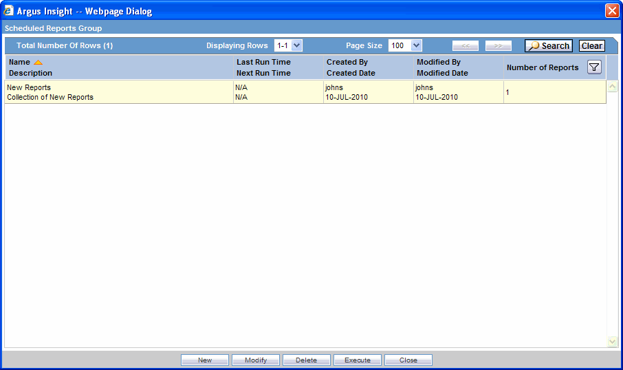

When you select a query and click Associate, the Scheduled Report Groups window is displayed.
Surrounding text describes sched.gif.
This window includes the following features:
  • This window displays information about all the report groups scheduled by the logged-in user.
  • Sorting and Search functionality is available for all columns.
  • Pagination is also available.
  • Each group can contain one or more reports. "Group" means that all the reports are scheduled at the same time.
  • This window has the following buttons:
    • New: Redirects the user to the Report Scheduling page with blank values. The system presents the context menu to enable the user to choose Report Association Only or for Scheduling.
    • Modify: Redirects the user to the Report Scheduling page and enables the user to modify an existing scheduled report group.
    • Delete: Deletes a selected scheduled report group.
    • Execute: Closes the window and executes the query in parent window to show case series and launch pre-filter for the selected report on this page. This button is enabled on if the scheduled report group has a single report.
    • Close: Closes the window without any other action.

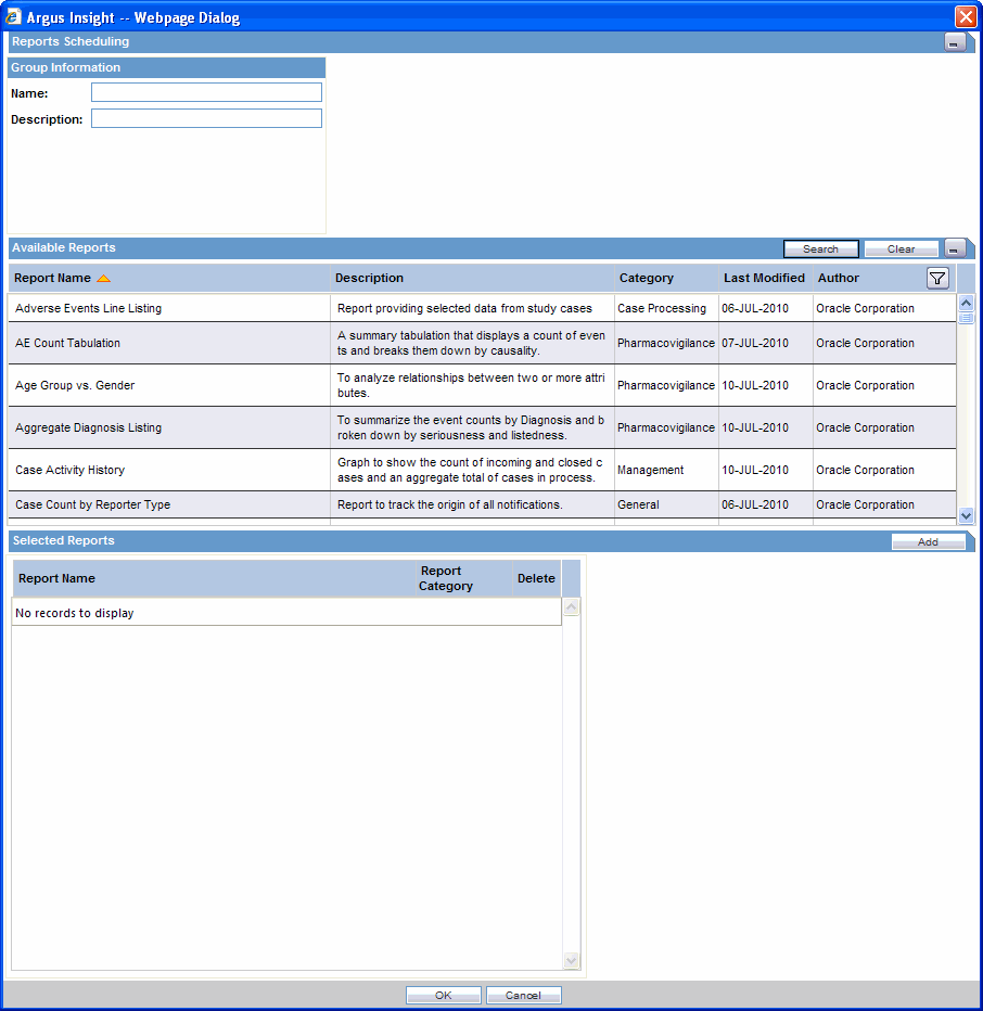

  • This the main scheduling page in Insight. On this page, user can select any number of reports for scheduling.
  • The Reports Scheduling page has four (4) sections as follows:
    • Group Information: The user provides the group name and description.
    • Schedule Information: The user provides the scheduling frequency.
    • Email Information: The user provides e-mail information for the receivers.
    • Available Reports: The user selects the reports to schedule. Select any report and click Add to add the report to Selected reports. The user can select multiple reports and add them at the same time.
    • Selected Reports: Reports associate with the query (as per the selection by the user from Available Reports section) are listed in this field.
      • User can remove a selected report by clicking the X button against report's row in the grid from the Selected Reports section.
      • Sorting and Search functionality is available for all the columns in the Available Reports Section.
      • Pagination is also available on the Available Reports Section.
    • The system does not permit the user to save a schedule without entering the pre-filter information for each report. The system uses the value in the Pre-Filters Configured? Column in the Selected Reports section to detect whether the pre-filter configuration is complete.
    • The user can enter pre-filter information by selecting any report in the Selected Reports section. When the user selects the report, the system loads the pre-filter information for the report in the sidebar and enables the user to enter the information.

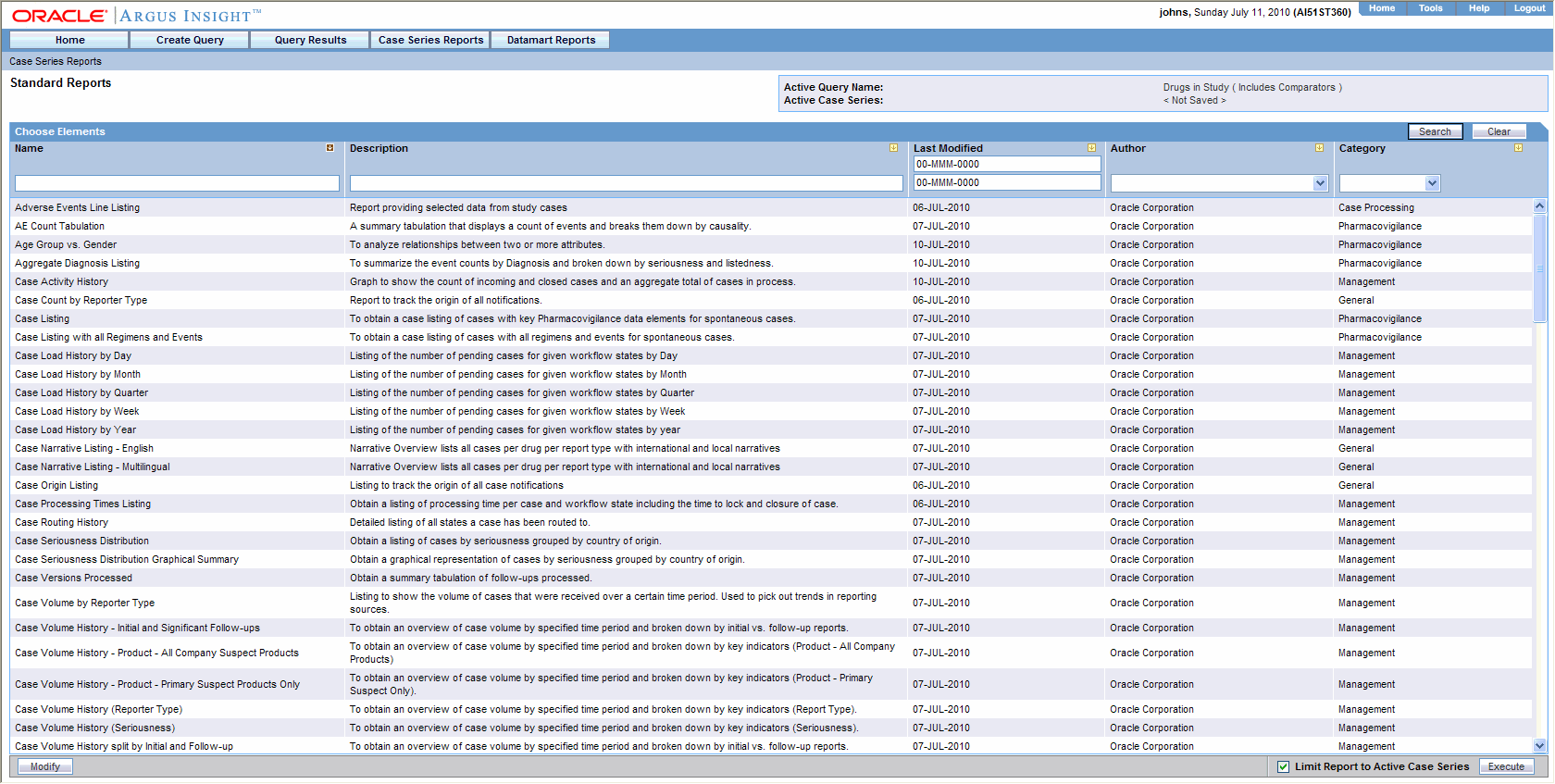

6.2 Standard Reports
The Standard Reports page displays a list of all the Standard Reports built into Argus Insight. Select Case Series Reports > Standard Reports > All to display the Standard Reports page. This page displays a list of the saved Standard Reports in a grid format. You can search for specific types of reports by specifying values for any of the columns as the search criteria and clicking Search.
Surrounding text describes stdreps.gif.
The descriptions of the grid columns follow.
Column Description
Name Displays the name of the Standard Report
Description Displays the Standard Report description
Last Modified Displays the date when the Standard Report was last modified
Author Displays the name of the Standard Report author
Category Displays the Standard Report Category
Standard Reports are grouped into six categories and can be accessed from the Argus Insight folder in the Installation CD. The following topics explain the various standard reports.

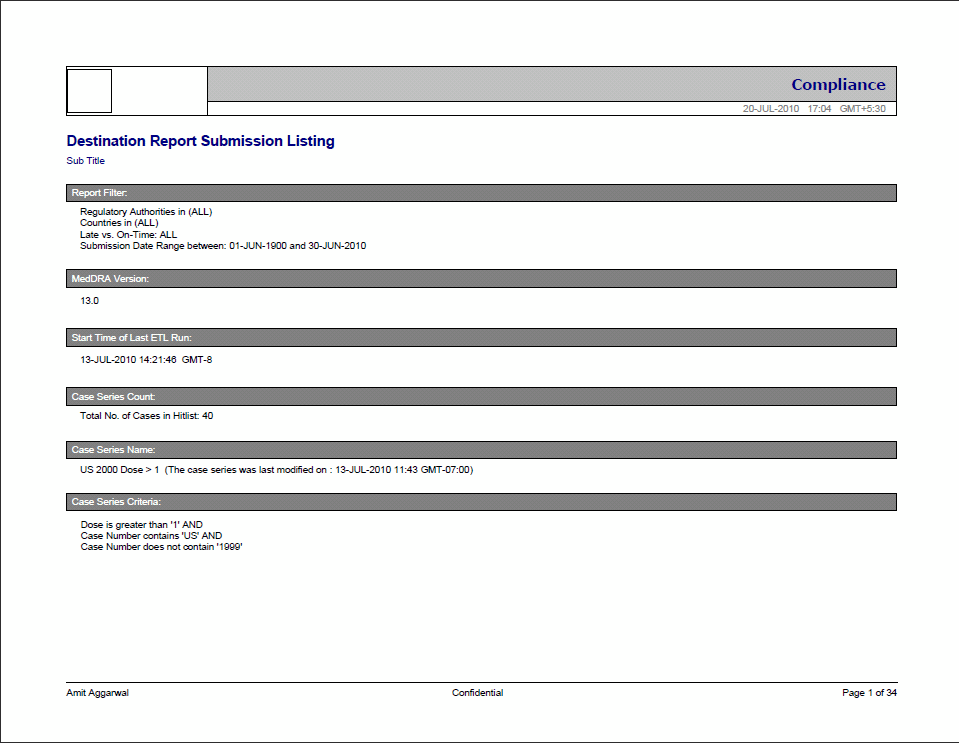

The following image displays the Cover page of the report when it is generated in PDF format.
Surrounding text describes coverpage.gif.
The following table describes each component of the cover page shown in the above image.
Cover Page Component Description
Company logo (upper-left box) Placeholder for a configurable logo. The image of the logo can be configured in the whitespace.
Report Category (upper-right box) The name of the category to which the selected report belongs.
Report Execution Date (under 'Report Category') Report Execution Time (in GMT).
Report Title (under the Heading of the Report) Title of the selected report, such as Serious Adverse Events Report.
Report Sub-Title (under 'Report Title') Configurable Sub-title of the selected report. You can enter a sub-title to further define the report. Example: 01-JAN-1900 to 31-DEC-2007.
Report Filter A selected value from the Report Prompt.
MedDRA Version The MedDRA Version for the selected report.
Start Time of Last ETL Run Start time of the last successful ETL run (in GMT).

Destination Report Submission Listing Use this report to view the submission details based on an on-line country.
