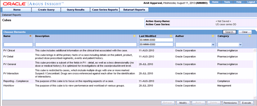

Use the following procedure to execute a Cube

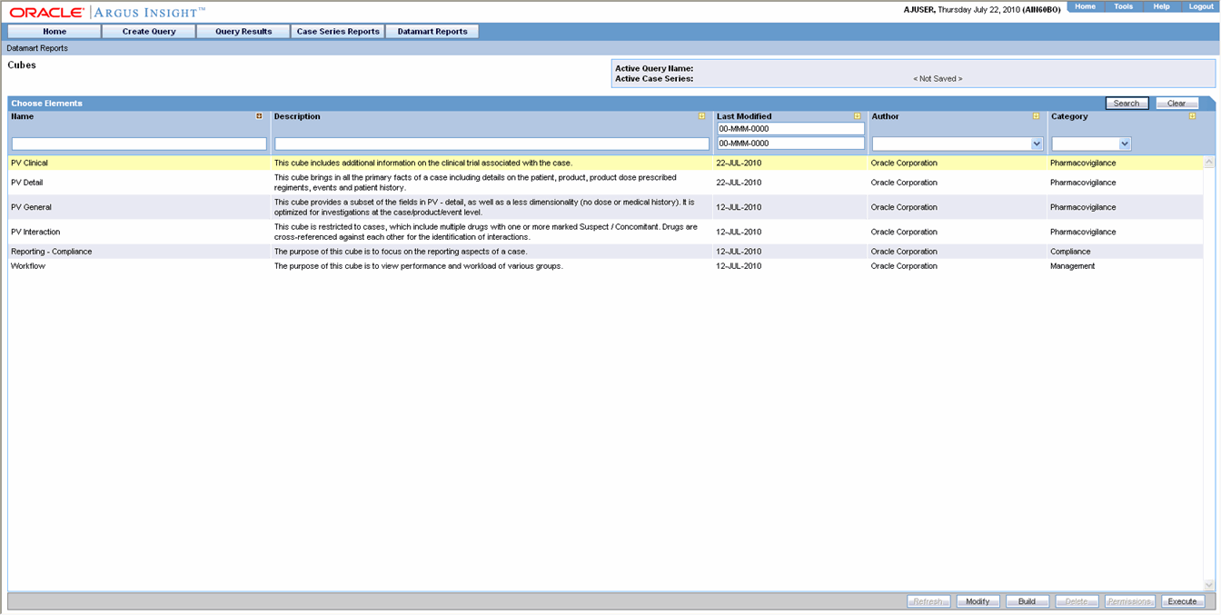

  1. In Argus Insight, select Datamart Reports >Cubes>All.The Cubes page displays all the built-in Cubes in Argus Insight. To view Cubes in a specific category, first select Datamart Reports > Cubes and then select a category name: Compliance, Management, or Pharmacovigilance.
    Surrounding text describes cubes1.gif.
  2. Select the Cube you wish to execute.

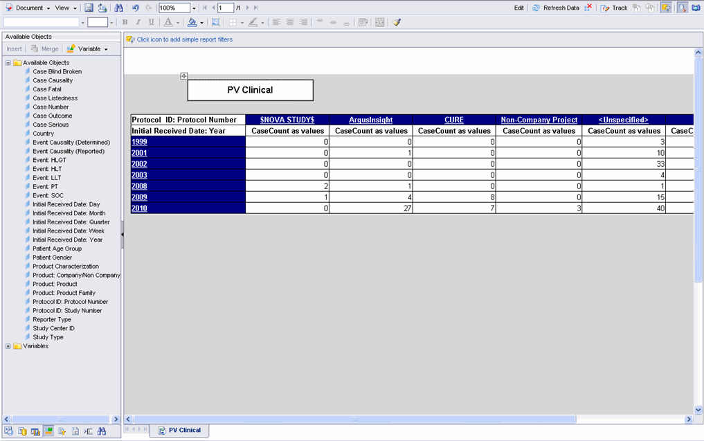

  3. Click Execute. A separate BOXI Web Explorer window displays the Cube in the interface similar to the one shown in the following figure.
    Surrounding text describes ao-a.gif.

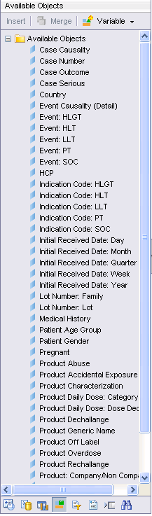

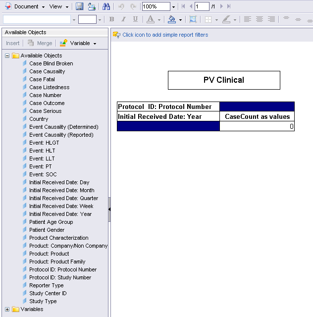

    The left frame of the BOXI Web Explorer window displays the available dimension categories (reporting aspects) in a tree hierarchy. The Variables folder in the tree structure contains the available measures for the Cube. The report output area in the right frame displays the Cube structure, which is similar to a crosstab report. The dimensions from the first two categories appear as rows and columns in the Cube, respectively. To explore dimensions from other available categories, you can replace the existing dimensions in the Cube or nest other dimensions with the existing dimensions. You can also filter the output or drill down the dimensions in the Cube to display specific data.
  4. Click Edit on the toolbar.
The following sections explain the basic BOXI Web Explorer options that let you work with Cubes.

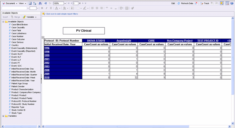

8.1.1.1.1 Filtering Data
You can select a dimension to filter a Cube in order to reduce the data displayed in the Cube output. Unlike the drill operation, filtering does not change the existing Cube layout. Instead, it changes the measure values displayed in the Cube output according to the dimension you select as the filter. An example follows.
In the PVClinical Cube, the default row dimensions are from the Protocol ID: Protocol Number category and the default column dimensions are from the Initial Received Date:Year category. At the intersection of each row and column dimension the Cube displays the total Case Count. However, instead of viewing the total Case Count for the existing dimensions, you may wish to view the Case Counts for a specific country of incidence. Use the following procedure to view Case Counts for a specific country of incidence.

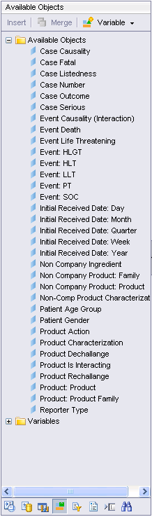

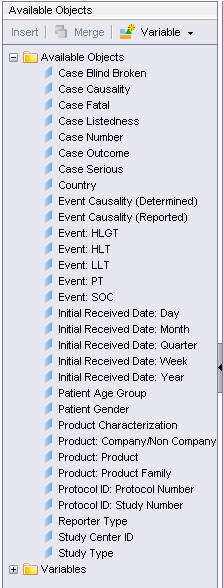

  1. While the PV Clinical Cube is open, select Available Objects from the drop down box in the upper-left corner of the BOXI Web Explorer page.The left pane displays all the dimension categories available for the PV Clinical cube
    Surrounding text describes ao-b.gif.

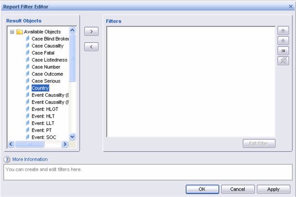

  2. In the right pane, right-click underneath the table to access the Add Filter icon from Filter text menu. The Report Filter Editor displays the various options you can use for filtering data.
    Surrounding text describes ao-c.gif.

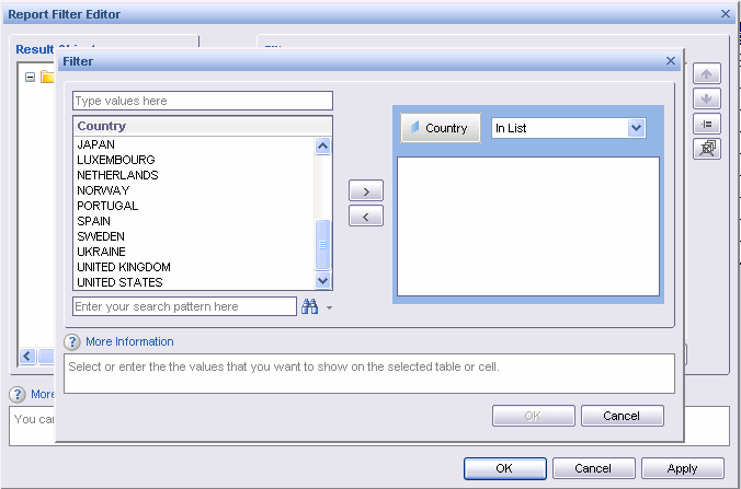

  3. Select Country from the Result Objects pane and click >. The Filter dialog appears.
    Surrounding text describes ao-d.gif.
  4. To define the country to be used as filter criteria, select the appropriate operator and value. In this example we have selected the In List operator to select from a list of countries.
  5. Select the country to be used as a filtering criteria. In this example, we have selected United States as the filtering criteria.

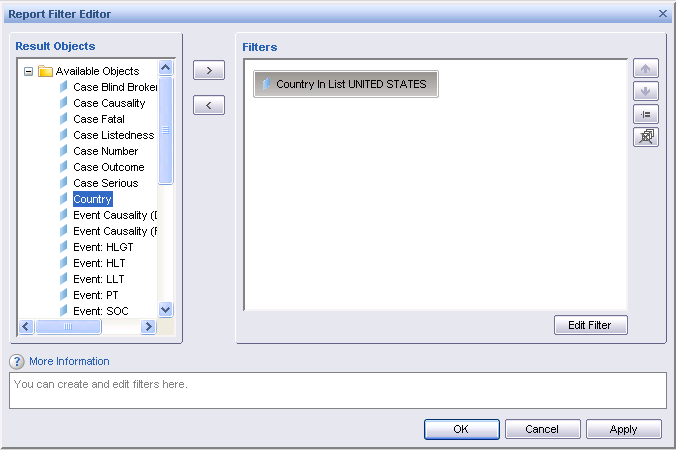

    Surrounding text describes ao-e.gif.
  6. While the layout of the PV Clinical Cube remains the same, the data in the Cube output changes to display the measure values specific to the selected country.
    Surrounding text describes ao-f.gif.
    You can filter the output further by selecting another dimension as the filtering criterion.

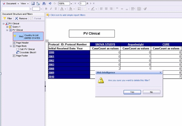

Use the following procedure to remove the filter.
  1. Select the Document Structures and Filters from the drop-down box in the upper-left corner of the BOXI Web Explorer page
  2. Select the filter to be removed.
  3. Click Remove.
For example, to remove the Country in List UNITED STATES filter described in the example above, select in the categories filter, and click Remove.
Surrounding text describes ao-g.gif.

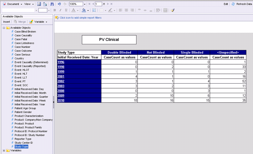

8.1.1.1.2 Replacing Rows and Columns
You may want to replace the existing row or column dimensions with dimensions from another category to observe the interaction between dimensions from different categories. To do this, you can drag a category or a dimension from the left dimensions pane of the BOXI Web Explorer window into the middle of any cell of the column or row you want to replace. An example follows.
Similarly you can replace the existing column dimensions with other dimensions. You can also replace the existing row/column dimensions with a single category from a dimension by dragging the category from the left pane into the middle of a row/column cell.
Use the following procedure to replace existing row dimensions with Study Type dimensions.
  1. Select the Study Type dimension from the left dimensions pane .and drag the dimension from the left frame to the middle of any row cell in the Cube.
    Drag and drop the dimension(s) into the middle of the cell row/column.
    Do not drop the dimension(s) onto the row/column header.
  2. The existing row dimensions in the Cube are replaced with the Study Type dimension.
    Surrounding text describes ao-h.gif.

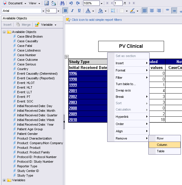

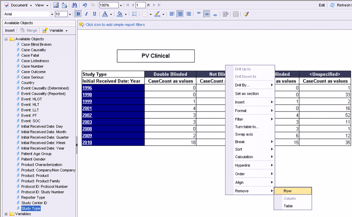

You can remove specific groupings from the Cube by deleting a dimension row or column from the Cube. The procedures follow.
  1. To remove a dimension row from the Cube, right click on the table as shown in the illustration.
    Surrounding text describes ao-i.gif.
  2. In the context menu that appears, click Remove > Row to delete the dimension row.
Use the following procedure to remove a dimension column from a Cube.
  1. To remove a dimension column from the Cube, right click on the table as shown in the illustration.
    Surrounding text describes ao-j.gif.
  2. In the context menu that appears, click Remove > Column to delete the dimension column.

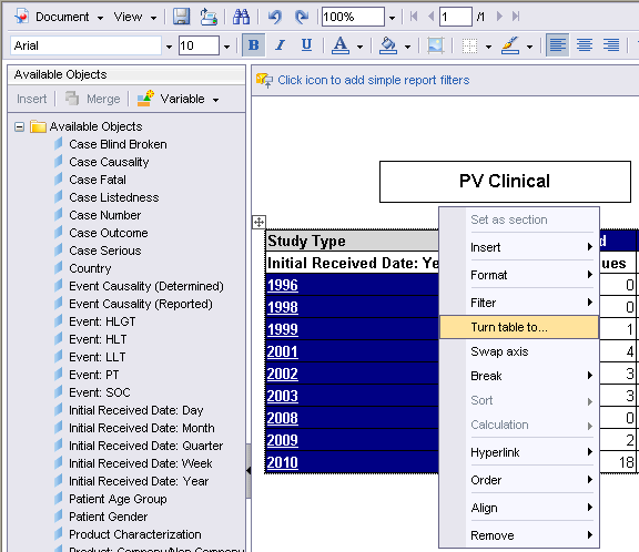

8.1.1.1.4 Creating Charts
You can display a Cube as a chart to graphically see patterns and trends in data.
  1. Perform the necessary operations on the Cube to get the desired reporting focus.
  2. Right click on the table, in the right panel of the BOXI web explorer. A context menu displays the Turn table to option.
    Surrounding text describes ao-k.gif.

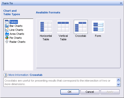

  3. Click the Turn Table to option. Select the required format from the Turn Table to dialog box.
    Surrounding text describes turnto.gif.
  4. The cube data is displayed in the selected format.

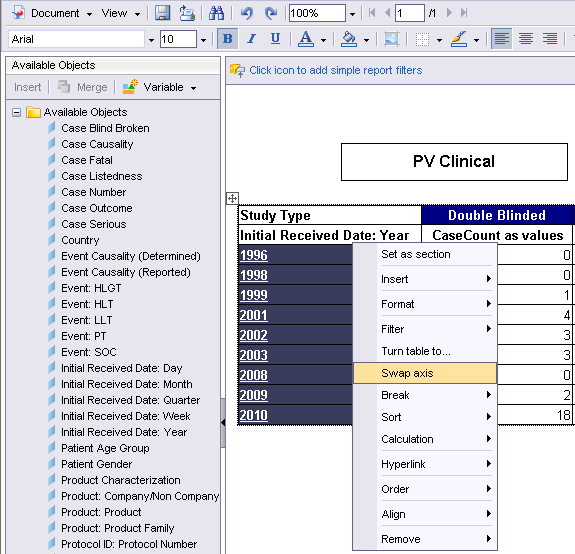

8.1.1.1.5 Swapping Rows with Columns
You may want to swap the rows with columns in a Cube that has few rows and many columns. This improves the readability of the Cube output.
To interchange rows and columns in a Cube, right click on the table and select the Swap axis in the context menu that appears as shown in the illustration.
Surrounding text describes swapaxis.gif.

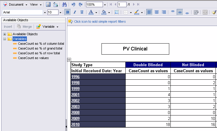

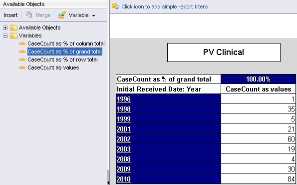

8.1.1.1.7 Changing Measures
The reporting focus of Cubes that have multiple dimensions available can be changed by replacing an existing measure within the Cube with another measure. For example, Pharmacovigilance Cubes have Case Count (row,column, grand or values) as available measures. While the default measure displayed in these Cubes is Case Count, you can replace it with the percentage total of (row,column, grand or values) to change the reporting focus.
Use the following procedure to change the measures.
  1. While the PV Clinical Cube is open, select Available Objects from the drop down box in the upper-left corner of the BOXI Web Explorer page. The left pane displays the Variables folder which consists of all the measure categories available for the PV Clinical cube.
  2. Select Variables. The measures available for the Cube are displayed.
    Surrounding text describes ao-l.gif.
  3. Click and drag the measure required, onto the data cell. The crosstab output is refreshed; Case Count as % of grand total is the new measure added to the Cube.
    Surrounding text describes ao-m.gif.
    Tip:
    Drag the measure and place the cursor after the data in the cell, to display the original data of the cell and it's percentage as per the measure
    If you simply drag the measure onto the cell data, the tabular data is displayed as per the measure percentage

  1. In Argus Insight, select Datamart Reports>Cubes>All. The Cubes page displays all the built-in Cubes in Argus Insight and the Demand Cubes which the group users have created.
    Surrounding text describes cubes.gif.
  2. Select the required Cube and click Modify.

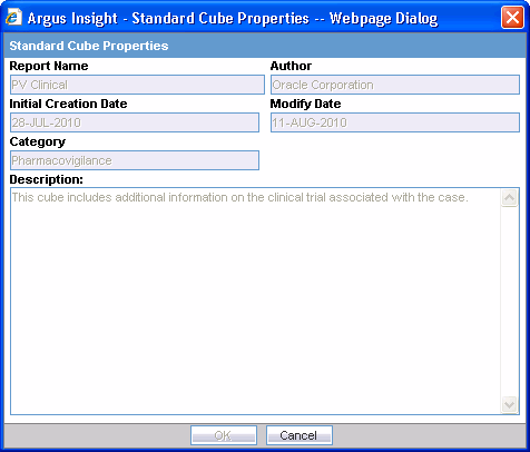

  3. The Modify cube interface appears. This interface helps you to capture information to modify the Cube.
    Surrounding text describes scp.gif.
    • Expiration Date informs you about the expiration date of the cube. You are notified when the expiry date is due and you can save or delete the existing cube as per preference. This field is visible only for Demand cubes.
    • Initial Creation Date captures the date when the Cube was loaded in the repository for the first time.
    • Modify Date captures the date when the Cube was last modified.
    • ETL Run captures the date of ETL run on which the case data is based. This field is visible only for demand cubes. This field is visible only for Demand cubes.
    • Case Series captures the name of the case series on which the cube was built. This field is visible only for Demand cubes.

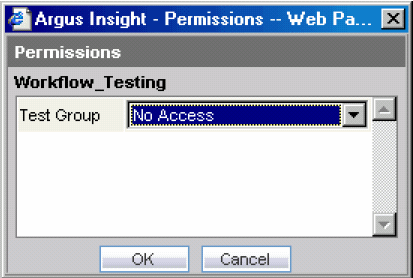

8.1.1.1.9 Setting Access Permissions
You can set group-level access permissions for the Demand Cubes. This determines which user groups can view, modify, or delete a Demand Cube.
You can set permissions only on Demand Cubes you have saved to the system.
Use the following procedure to set Demand Cube permissions.
  1. In the Argus Insight page, select the Datamart Reports > Cubes > All.
  2. Click Permissions. The Permissions dialog box appears. A list in this dialog box displays the names of all the groups (except the Administrator group) that the system administrator has created.
    Surrounding text describes perm-a.gif.
  3. Use the list box next to a group name to assign permissions to the group members on the Demand Cube you have selected. You can select from these options:
    Permission Description
    No Access (Default) No group members can access the Case Series
    Full Access You can modify/delete/view the Cube
  4. Click OK. The system saves the permission settings.

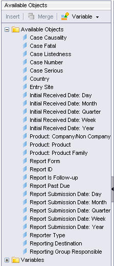

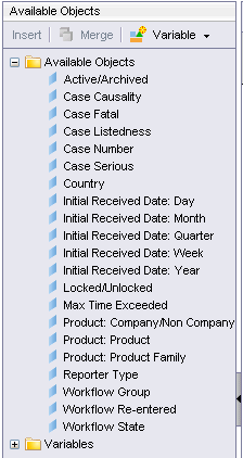

8.1.1.2 Cubes Available in Argus Insight
Argus Insight provides six different Standard Cubes grouped in categories to let you analyze your safety data from Compliance, Management and Pharmacovigilance perspectives.
Category Cube Name
Compliance Reporting Compliance
Management Workflow
Pharmacovigilance PV Clinical, PV Detail, PV General, PV Interaction
The dimensions available in a Cube depend on the type of analysis that the Cube lets you perform. The following types of measures are available.
Measures Available in
Case Count All Cubes in Pharmacovigilance, Management and Compliance categories.
The following sections describe the various Standard Cubes available in Argus Insight. For information on executing and working with Cubes, see the Working with Cubes topic.

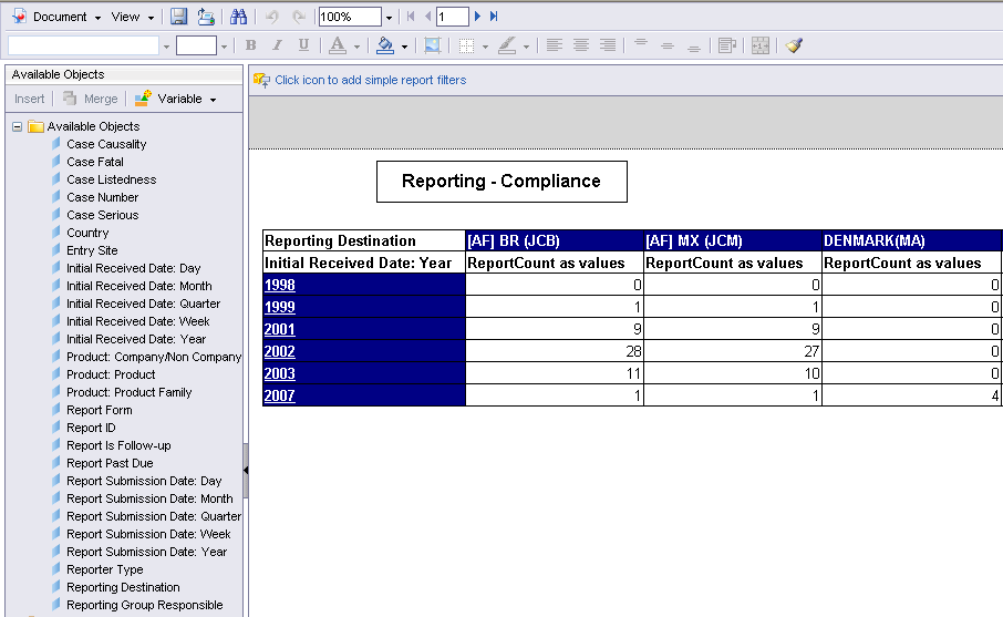

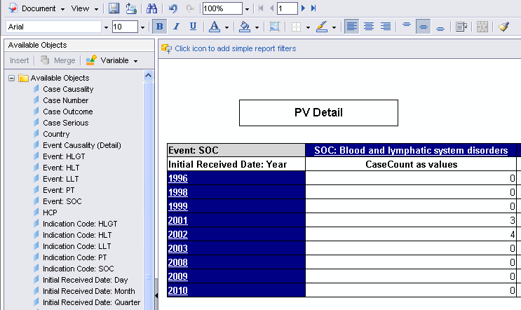

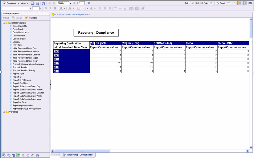

8.1.1.2.1 Compliance Cubes
The Compliance category consists of the Reporting Compliance Cube
Surrounding text describes rc-a.gif.
The Reporting Compliance cube lets you explore the following dimensions:
Surrounding text describes ao.gif.

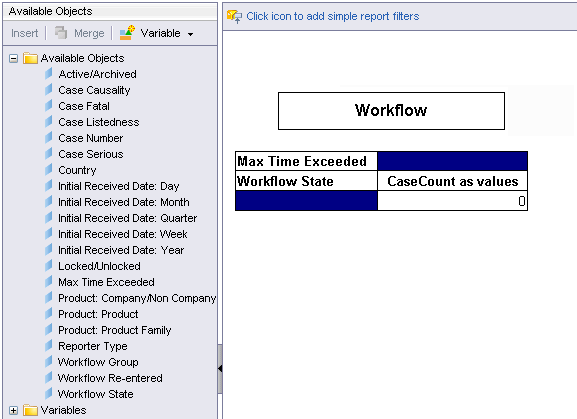

Surrounding text describes wo1.gif.
The Workflow cube lets you explore the following dimensions:
Surrounding text describes wo2.gif.

8.1.1.2.6 PV General Cube
The PV General Cube lets you explore the following dimensions
Surrounding text describes pvg1.gif.
Surrounding text describes pvg2.gif.

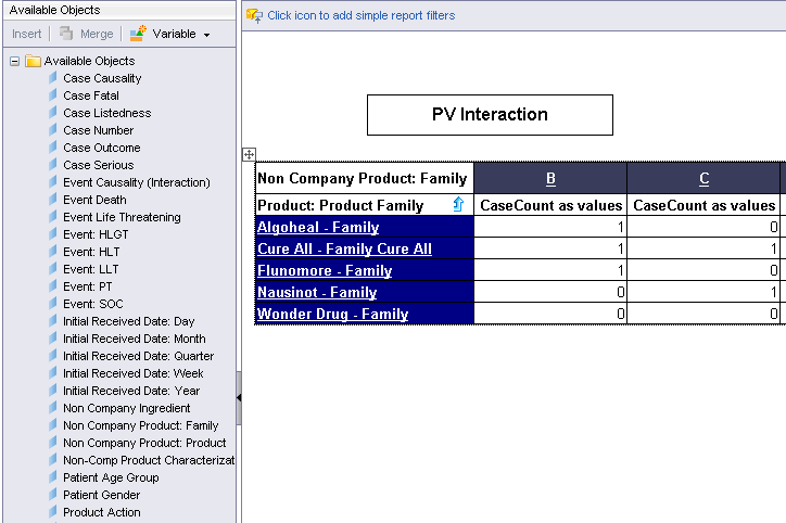

8.1.1.2.7 PV Interaction Cube
The PV Interaction Cube lets you explore the following dimensions
Surrounding text describes pvi1.gif.

  1. In Argus Insight, select Datamart Reports >Cubes>All. The Cubes page displays all the built-in Cubes in Argus Insight.
  2. Select the standard Cube using which you wish to create the demand Cube. The Cube name is highlighted; the Build button becomes active.

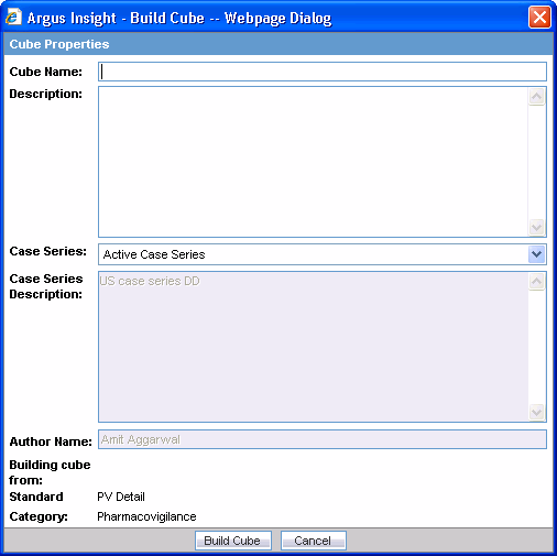

  3. Click Build. The Cube Properties dialog box appears.
    Surrounding text describes cp.gif.
  4. Enter the demand Cube name in the Cube Name text box.
  5. Enter the demand Cube description in the Description text area.
  6. Use the Case Series list box to select the Case Series on which you want to create the demand Cube. The description of the selected Case Series appears in the associated Description text area.
  7. Click Build Cube. The Cubes - Build dialog box notifies you that the Cube has been scheduled for generation on the BOXI server.

8.1.1.4 Drill Through Cubes
This section describes the procedure to drill through cubes for standard and demand cubes.
Use the following procedure to execute a Cube.
  1. In Argus Insight, select Datamart Reports >Cubes>All.The Cubes page displays all the built-in Cubes in Argus Insight and the Demand Cubes which the group users have created.
8.1.1.5 Performing Drill Through Operations
You can drill-down and drill-up hierarchical dimensions to explore different aspects of your work and to move between levels of information. You can drill-down and drill-up multiple levels at a time. When you drill-down on a dimension that groups other dimensions in a row or column, some information may be removed from the Cube.
An example to demonstrate the drill functionality for listing Case Numbers associated with the initial received date (in years) follows.
Use the following procedure to drill down to the next level in a hierarchical dimension, such as a Case Series.
  1. Drag and drop the Case Number dimension from the left pane into the right pane, underneath the table.
    Tip:
    If you cannot see the dimension list in the left pane, select Available Objects from the drop down list in the left pane.
  2. The Cube output changes to display the data for all the Case Number dimensions.
    Surrounding text describes dt1.gif.
  3. While the preceding steps let you display the data for all the lower levels for all the products, you may change the reporting focus by only displaying the lower-level data for a specific product. To do this, simply click on the dimension in the Cube output.

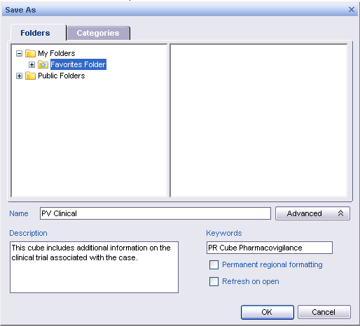

  5. Click Document > Save As in the menu bar. The options for saving the report appear.
    Surrounding text describes sa.gif.
    Tip:
    You can access Document > Save to my computer as to save the cube on your system in Excel, PDF or CSV (with options) format.
  6. Enter and save the Title, Description and Keywords.
  7. Select the location at which the cube view should be saved. Public Folder > Argus Insight > Standard Cube Category > Analysis
    You cannot save Cube views in the Demand Cubes folder. You must save the Cube view in the Analysis folder within any Standard Cube category.
  8. Click OK to save the cube view.

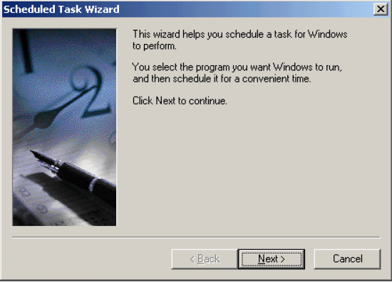

8.1.1.7.1 Setting up Batch Generation through Task Manager:

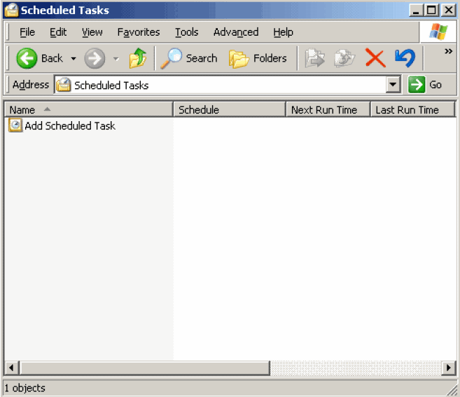

This section explains the procedure for scheduling batch generation by using Windows Task Manager. You need to perform this procedure for each of the six Cubes. The steps follow:
  1. Select Start > Settings > Control Panel > Scheduled Tasks. Double-click the Add a Scheduled Task item.
    Surrounding text describes st1.gif.
  2. Click Next in the Schedule Task Wizard window.

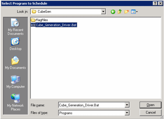

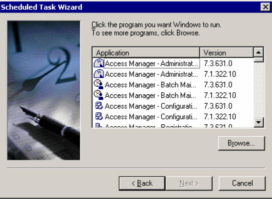

  3. Click Browse to navigate to another folder location.
    Surrounding text describes st3.gif.
  4. Navigate to the following location: <Argus Insight Installation Folder>\PowerReports\CubeGenThis is the path of the folder where the Argus Insight application is installed on the system drive. For example D:\Relsys\PowerReports\CubeGen.
  5. Select the Cube_Generation_Driver.bat file.
  6. Click Open to select the Cube_Generation_Driver.bat file

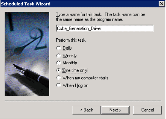

  7. In the text box for entering the task name, type Cube Generate 1.The task name should be entered in the format Cube Generate <Cube ID>. The Cube IDs are listed in the table below.
    Surrounding text describes st5.gif.

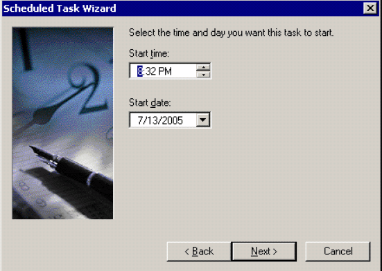

  10. Set the Start Time and Start Date.
    Surrounding text describes st6.gif.

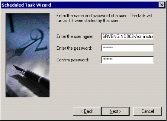

  12. Enter the user name and password of the user authorized to run this task
    Surrounding text describes st7.gif.

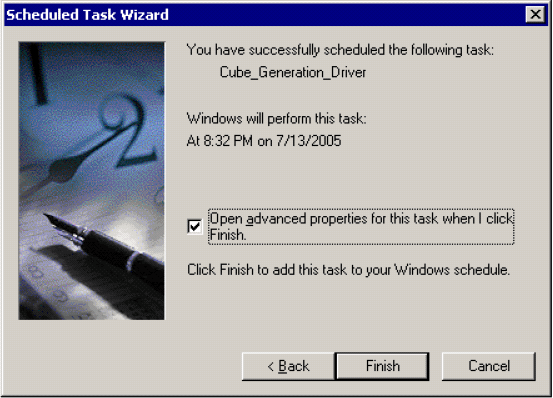

  14. Check the Open advanced properties for this task when I click finish checkbox
    Surrounding text describes st8.gif.

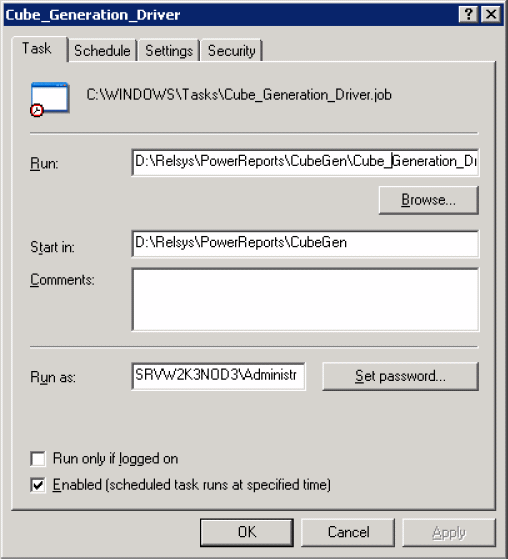

  15. Click Finish. The dialog box for setting advanced properties for the task appears
    Surrounding text describes st9.gif.
  16. In the Run text box within the Task tab, enter the run-time parameter for this task in the following format:<Argus Insight Installation Folder>\PowerReports\CubeGen\Cube_Generation_Driver.bat" <Cube ID>where CubeID is the ID of the Cube for which you are scheduling the batch generation.Include the double quotation marks (" ") while entering the runtime parameter. The table below lists the Cube ID for each cube and provides examples of the run-time parameter to be entered.

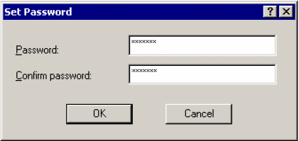

  17. Click Set Password to set the password.
  18. Enter the password for the BOXI Server admin user. Click OK.
    Surrounding text describes st10.gif.

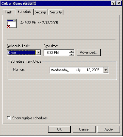

  19. Select the Schedule tab to set the schedule options, as appropriate.
    Surrounding text describes st11.gif.

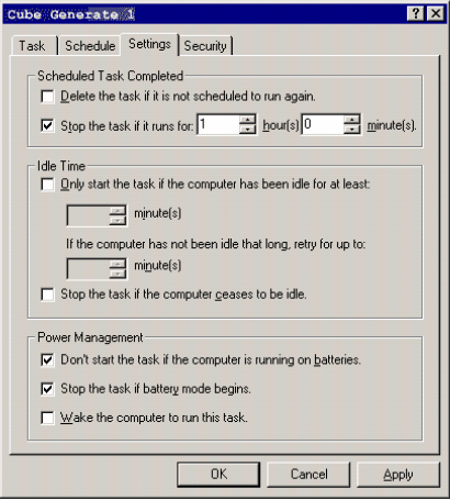

  20. Select the Settings tab.
    Surrounding text describes st12.gif.
  21. In the Scheduled Task Completed and Power Management sections, set the options as shown in the illustration above.

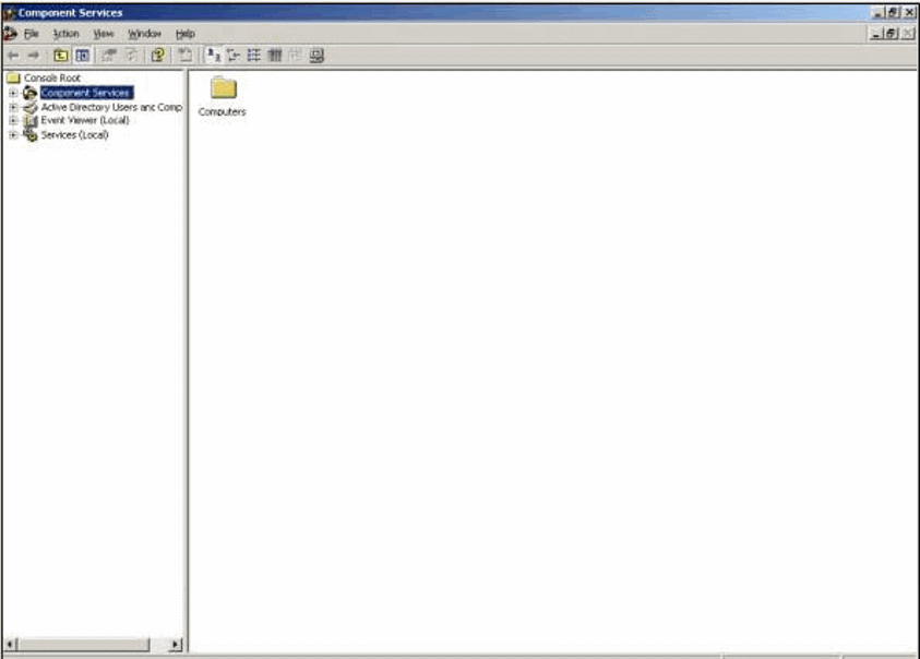

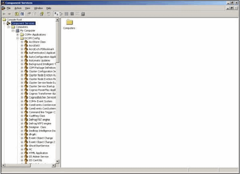

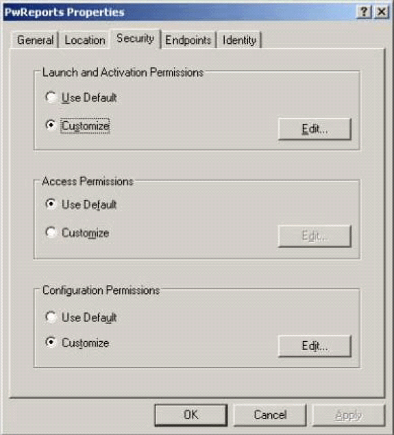

  1. Go to Start > Run and type dcomcnfg and press Enter.
  2. In the tree under Console root > Component Services > Computer > My Computer > DCOM Config.

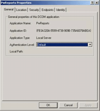

  3. Right click on the PwReports in the list and click Properties.
    Surrounding text describes pwp1.gif.
    Surrounding text describes pwp2.gif.
    Surrounding text describes pwp3.gif.
  4. Click the Security tab.
    Surrounding text describes pwp4.gif.

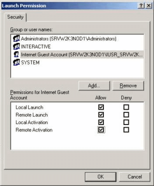

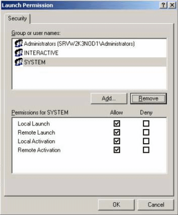

  5. In the Launch and Activation Permissions Mark Customize and click Edit.
    Surrounding text describes pwp5.gif.
  6. ClickAdd.
    Surrounding text describes pwp6.gif.

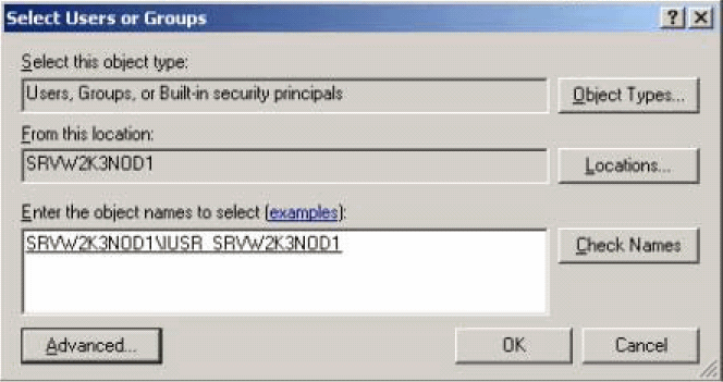

  7. Under the Enter the object names to select (examples) add <machine_name>/IUSR_<machine_name> and click OK
    Surrounding text describes pwp7.gif.
  8. Select the newly created Internet Guest Account and check all the permissions.
  9. Click Ok.
  10. Exit the Component Services program.
