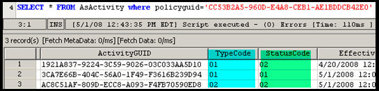

The lightning bolt was selected for the CoverageCalculation activity. The activity processed and the values were displayed for the activity on the Activity Details screen. The activity is in active status because the lightning bolt was selected. The activity record has TypeCode 01 because it was manually entered. The StatusCode has changed from 02 (pending status) to 01(active status).
Database record showing active status
Activity in Database in Active Status

The CoverageCalculation activity was entered manually by selecting it from the activity drop-down box and then selecting the OK button. The activity displays on the Activity screen in a pending status. The activity record in AsActivity table stored the TypeCode 01 because it was manually entered and the StatusCode 02 because it is pending. Remember if the activity was spawned it will have type code 01 as well.
Database record showing pending status
Activity in Database in Pending Status

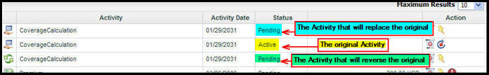

Selecting the Recycle button associated with an activity creates two additional activities to be processed. The first is a reversal activity that has green reversal arrows for its Activity Detail icon. The second activity replaces the original activity. The reversal activity must be processed prior to the new activity that will replace the original.
Step 1: Select the recycle button for an activity.
Two pending activities are generated in OIPA for the reversal and new activity.
Activity screen with two new activities created from the reversal
Two Pending Activities Generated For Recycle

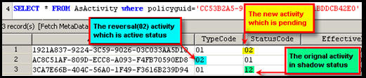

Step 2: Select the Process button for the reversal activity.
The status of the original activity is updated to shadow and the reversal activity status is updated to active.
Reversal activity in active status
Active Reversal Activity
The status of the original activity’s record changes from 01(active) to 12(shadowed). The reversal activity changes from 02(pending) to 01(active).
Database record showing new actiivity as pending, reversal activity as active and old activity as shadowed.
Reversal Activity in the Database

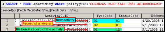

Step 3: Select the pending activity that has the correct information.
The activity’s status changes from pending to active. The new activity’s status changed from 02(pending) to 01(active).
New activity with active status
Explanation of Reversal Records in Database

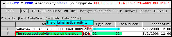

Selecting the delete button associated with an activity generates a reversal activity. The reversal activity is in pending status and must be processed in order to delete the activity and place it in a shadowed status.
Step 1: Select the delete button associated with an activity.
A reversal activity is generated with a pending status.
Reversal activity in pending status
Reversal Activity in Pending Status
There are now two records, one for the original activity and one for the reversal activity.
Database records for original activity and reversal activity
Two Reversal Activities in Database
