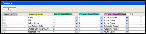

Currency File in Admin Explorer
Open the Admin Explorer window.
Double-click the Currency folder. It will open in the Configuration Area.
Right-click on the currency XML file and select Check-out.
Click Add at the bottom of the Configuration Area window. If the Add button is not visible, grab the bottom of the window and pull it down until the Add button is visible.
Select a Currency code from the drop down menu. The corresponding Currency Name will display.
Select the number of decimal places to round the currency for display purposes.
Select the number of digits to the right of the decimal place to keep after a currency calculation is performed.
Select the rounding method to employ once a calculation is performed.
Arithmetic Round: Increases the last digit by one if the next digit is five or greater.
Round Down: Leaves the last digit the same, regardless of the next digit.
Round to Even: Increases the last digit by one if the next digit is six or more, or a five followed by one or more non-zero digits. Also will increase the last digit by one if the next digit is five followed by zeros when the last digit is odd.
Check-in the XML file to save the changes to the database.
Note: The currency rounding is applied first based on the currency round places determined in step 7. Then, the result is truncated based on the display rounding places defined in step 6.

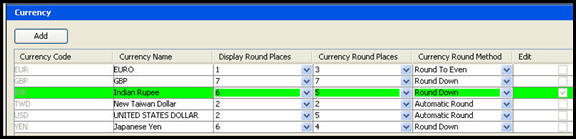

Find the name of the currency for update in the Currency Name column. The currency attributes that can be changed are in the columns to the right and are accompanied by a drop-down list.
Click the down arrow next to the attribute to change. The currency’s row will appear highlighted in green.
Make the necessary currency rounding adjustments.
Check-in the file to save the changes to the database.
