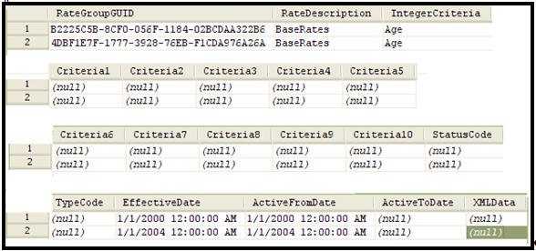

In the database, two entries will exist in AsRateGroup. Both are called BaseRates but with different EffectiveDates, which are also known as Rate Activation Dates.
The second set of rates will follow the same Rate Upload procedure as above. The RateDescription used for the second set of rates will be BaseRates, the same name as the original set of rates, but will be loaded with a different Rate Activation Date and a different ActiveFromDate.
After entering the Rate Group information, AsRateGroup would hold the following information. For this example, no criteria is used other than IntegerCriteria. If additional criteria were used, all criteria names must match between the old and new rates.
Mapping it Out
Line one is used for RateDescription=BaseRates where policies have an EffectiveDate from 1/1/2000 (inclusive) to 1/1/2004 (exclusive).
Line two is used for RateDescription=BaseRates where policies have an EffectiveDate from 1/1/2004 (inclusive) forward.

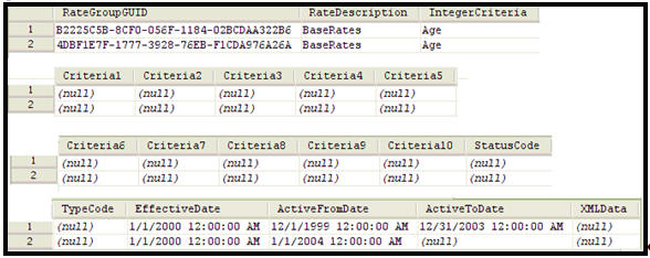

Should backdating of activities be allowed, then the ActiveFromDate would not match the EffectiveDate/RateActivationDate. An example where three months of backdating is allowed would look like this:
Sample of Rate Backdating

In the database, there will exist two entries in AsRateGroup, both called BaseRates but with different EffectiveDates. In addition, the rates that will no longer be in affect will have the ActiveToDate filled in.
After entering the Rate Group information, AsRateGroup will hold the following information. For this example, no criteria is used other than IntegerCriteria. If criteria were used, all criteria names must match between the old and new rates.
Mapping it Out
Line one is used from RateDescription=BaseRates where policies have an EffectiveDate from 1/1/2000 (inclusive) forward but only for activities with effective dates between 1/1/2000 (inclusive) and 12/31/2003 (inclusive).
Line two is used from RateDescription=BaseRates where policies have an EffectiveDate from 1/1/2000 (inclusive) forward but only for activities with effective dates on or after 1/1/2004.
