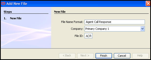

  5. Enter a File Name Format.  This allows you to name the new interface, similar to the naming of a business rule or transaction.
  6. Select the Company from the drop down box.
  7. Enter a File ID, which allows the caller to specify the file to use to process the request. A File ID is limited to three characters and should be an acronym or abbreviation for the calling or process.
  8. Click Finish.
New File Wizard
New File Wizard
