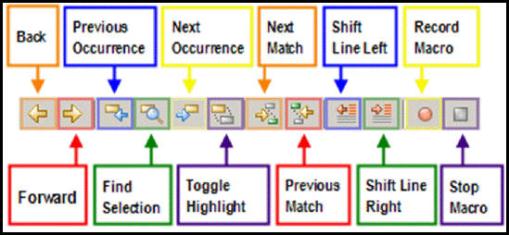

The XML Editor tools are available to aid configuration. An explanation of each tool is provided below.
Back: This moves to the last step that was performed.
Forward: This moves forward from previous steps taken.
Previous Occurrence: This finds the previous occurrence of the highlighted text.
Find Selection: This finds each selection of the occurrence of the highlighted text.
Next Occurrence: This finds the next occurrence of the highlighted text.
Toggle Search Highlight: This turns on and off all highlighted instances of searched text.
Next Match: This inserts the next word.
Previous Match: This inserts the previous word.
Shift Line Left: This shifts highlighted text to the left.
Shift Line Right: This shifts highlighted text to the right.
Record Macro: This begins macro recording.
Stop Recording Macro: This stops macro recording.
