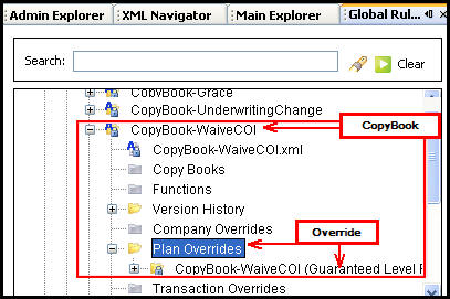

When a CopyBook needs to be updated to make it more specific for a particular plan, a CopyBook override can be created. From the Global Rules Explorer tab, open the Business Rules | CopyBooks folder. Right-click on any CopyBook to create the override. Once the override is created, it will reside in the Plan Overrides folder. It will retain the original name of the CopyBook with the override level in parenthesis. So, an override for the WaiveCOI transaction for the Guaranteed Level Premium Term plan would be named CopyBook-WaiveCOI (Guaranteed Level Premium Term).
The system will look for overrides at the lowest level starting with the most specific and moving up to global.
WaiveCOI copybook override in global rules explorer
CopyBook and CopyBook Override

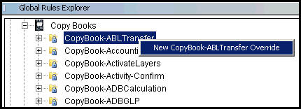

  1. Go to Global Rules Explorer tab.
  2. Locate the CopyBook and right-click on the CopyBooks folder.
  3. Select New CopyBook Override.
CopyBook Override right-click option
CopyBook Right-Click Option

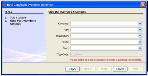

  1. Select Next. The name is already provided.
  2. Select the appropriate override level and then select Finish.
Select override levels for new copybook
Step Two of the CopyBook Override Wizard
