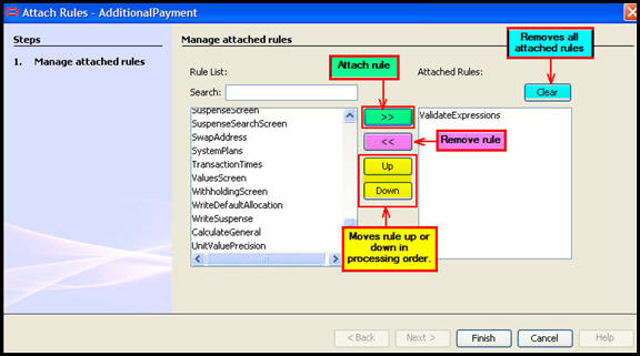

  4. Select the rule to attach from the Rule List.
  5. Use the Button to attach rule to transaction button to attach the rule. Or use the button to remove a rule button to remove a rule.
  6. Repeat as necessary.
  7. Select Finish.
Attach Rules Manager
Attach Rules Window
