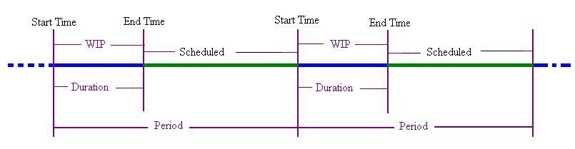

Example of Simple Recurring CM ticket
The figure below illustrates an example of a recurring CM ticket given the following parameters: Recurring= Yes | Start time =10am | Duration =1 day | No end date
The expected outcome, once these parameters are set, is for the CM ticket to recur every day and indefinitely during the same two hour time frame.
Surrounding text describes Duration-Period.JPG.
