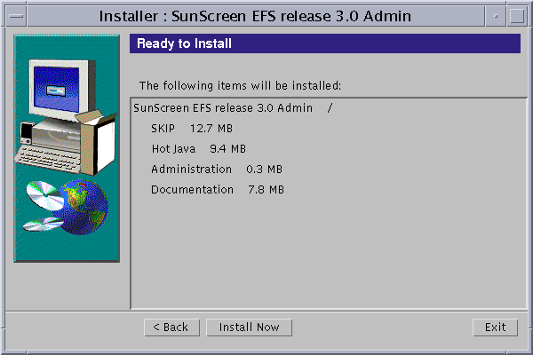

The Ready to Install window appears, as shown in Figure 4-2. The size of the packages to be installed is confirmed.
Click Install Now to continue the installation process.

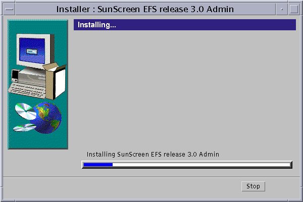

The Installing window appears, as shown in Figure 4-3. The status bar shows the progress of the installation.
Click Next to complete the installation process.

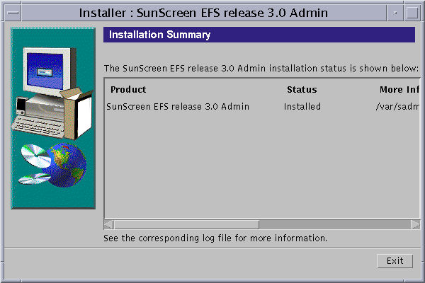

An Installation Summary appears, as shown in Figure 4-4.
Select Exit to complete the installation process using the installation wizard.

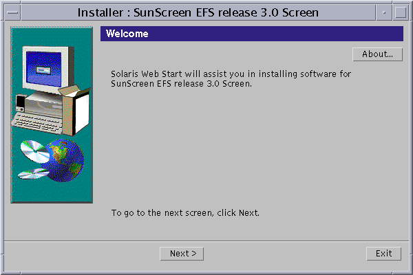

The Screen Install wizard's Welcome window appears, as shown in Figure 4-6.
Click Next to continue the installation process.

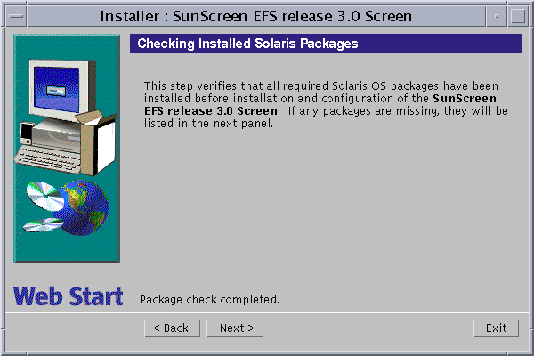

The Check Installed Solaris Packages window appears, as shown in Figure 4-7. Prior to installation of the SunScreen EFS 3.0 software, a check is performed to verify that the prerequisite Solaris packages are installed on your machine.
If there are missing required packages, a list will be displayed. You must exit the installation wizard at this point and install the required Solaris packages from your Solaris CD.

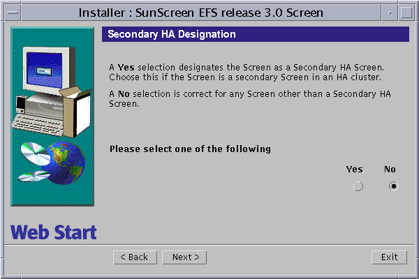

The Secondary HA Designation window appears, as shown in Figure 4-8. No is the default.
Choose Yes if you are configuring an HA cluster and are installing the Secondary SunScreen of that cluster. If this is what you want to do, exit the installation wizard and see the SunScreen EFS 3.0 Administration Guide for instructions on how to set-up an HA cluster.
Accept the default, No, and Click Next.

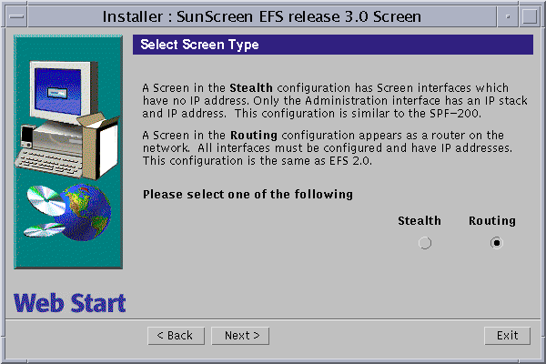

The Select Screen Type window appears, as shown in Figure 4-9. You are given two types of installations to choose from: Stealth or Routing. Routing mode is the default.
Accept the default, Routing mode, and Click Next.

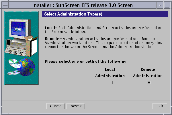

The Select Administration Type window appears, as shown in Figure 4-10. You are given the choice of Local Administration or Remote Administration. Local Administration is the default.
Select Remote Administration and Click Next.

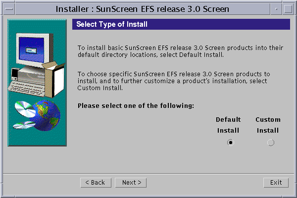

The Select Type of Install window appears, as shown in Figure 4-11. You are given two choices: Default Install and Custom Install.
The HotJava browser, version 1.1.5, is packaged on the SunScreen EFS 3.0 CD-ROM and is installed as part of the Default Install. If you do not want this installed, select Custom install and deselect package SUNWdthj.
Select the type of install desired, and Click Next.

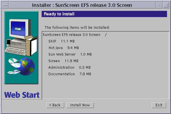

The Ready to Install window appears, as shown in Figure 4-12. The size of the packages to be installed is confirmed.

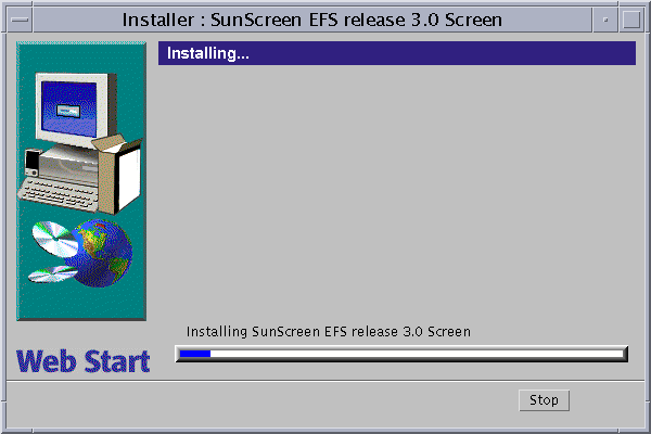

The Installing Window appears, as is shown in Figure 4-13. The status bar shows the progress of the installation.

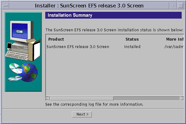

Once completed, the Installation Summary window appears, as shown in Figure 4-14. You can resize this window as needed.

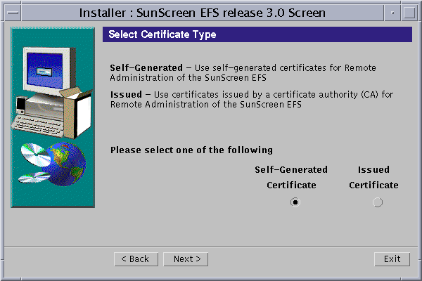

The Select Certificate Type window appears, as shown in Figure 4-15. Self-Generated Certificate is the default.
If you are using Issued Certificates, you must now turn to the following procedure, "Option 2: To Install the Software on the Screen When Using Issued Certificates". Follow the instructions to install your Issued Certificates. Once completed, return to this procedure and resume with Step 17.
Accept the default, Self-Generated Certificate, and Click Next.

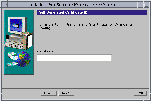

The Self-Generated Certificate ID window appears, as shown in Figure 4-16.
Enter the Administration Station's 32-character certificate ID (MKID), obtained in the previous procedure, and Click Next. Do not enter the leading two characters: 0x.

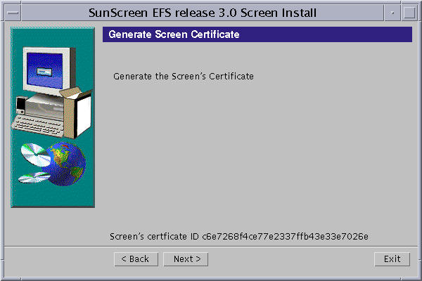

The Generate Screen Certificate window appears. Wait while the Screen's certificate ID is generated. When completed, the Screen's 32-character certificate ID appears at the bottom of the window, as shown in Figure 4-17.
Write down the Screen's 32-character certificate ID (MKID) that appears at the bottom of the window.

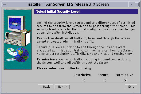

The Select Initial Security Level window appears.
Select the level of security you want: Restrictive, Secure, or Permissive. Permissive is the default.
When in doubt, select Permissive as your initial security level, as shown in Figure 4-18. You can change this later if you need to.

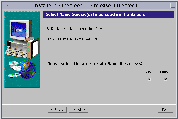

The Select Name Service(s) window appears, as shown in Figure 4-19. You must select the name service that will be used on the Screen. Your choices are both NIS and DNS, either NIS or DNS, or None. The default has both NIS and DNS selected. To select just one, deselect the one you do not want. For None, deselect both.
Select the appropriate Name Service(s), and Click Next.

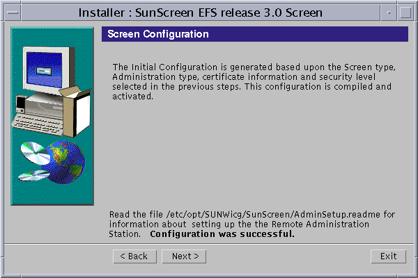

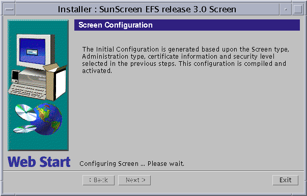

The Screen Configuration window appears with the message: Configuring Screen as shown in Figure 4-20. Figure 4-21 shows the message that appears once the Screen is successfully configured.

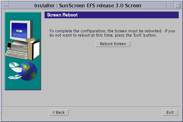

The Screen Reboot window appears, as shown in Figure 4-22.
To reboot the machine, click the Screen Reboot button.
The installation wizard disappears.
You must reboot the machine at this time in order to complete the installation process.

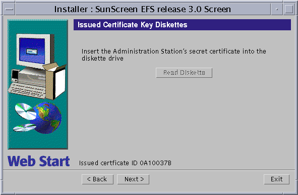

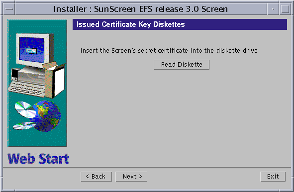

To do this procedure, you will need the Key and Certificate diskette.
From the Select Certificate Type window, select Issued Certificate and Click Next.

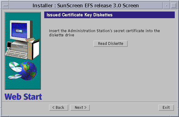

The Select Certificate Window is shown in Figure 4-23. The Issued Certificate Key Diskettes window next appears, as shown in Figure 4-24.
Insert the Administration Station's Key and Certificate diskette and Click Read Diskette.
Wait until The Issued Certificate ID appears at the bottom of the window, as shown in Figure 4-25.
Write down the certificate ID, which is eight characters long, and Click Next.
The Issued Certificate Key Diskettes window appears, as shown in Figure 4-26.
Insert the Screen's Certificate ID diskette into the floppy drive and Click Read Diskette button.
The Issued Certificate ID appears at the bottom of the window.
Write down the Screen's certificate ID, which is eight characters long, and Click Next.

# more /etc/opt/SUNWicg/SunScreen/AdminSetup.readme |
The AdminSetup.readme file contains the Screen's certificate ID as well as the command you run in order to give the Administration Station the Screen's certificate ID, as shown in Figure 4-27. Write the command down for later use, which begins with skiphost -a.
If you trust that the network between the Screen and the Administration Station is secure, you can ftp the AdminSetup.readme file from the Screen to the Administration Station. This saves you the task of writing down the information which is required in the next procedure.

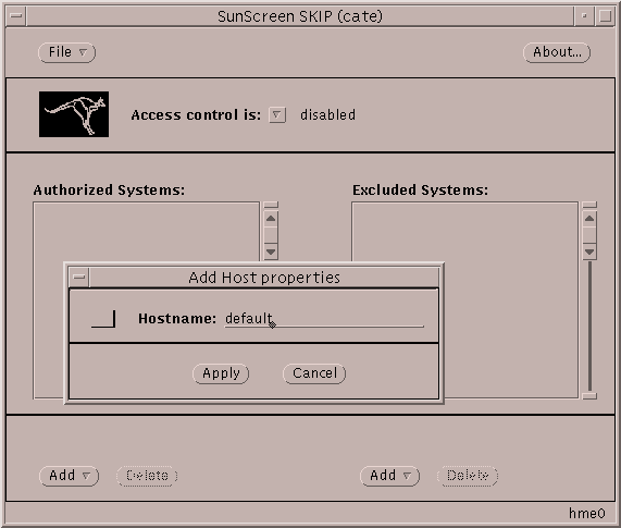

Open a terminal window and become root, if not already.
Launch the skiptool GUI by typing:
# skiptool |
You may need to use skiptool -i name_of_interface (such as qe3) if you wish to set SKIP parameters on a network interface other than the default interface.
The main window of the skiptool GUI appears, as shown in Figure 4-28.
You next add a default ACL to talk to unencrypted to all hosts.
Click the Add button, and under Host, choose the Off security option.
The Add Host properties window opens.
Type `default' as the Hostname and Click Apply.
This is shown in Figure 4-29.

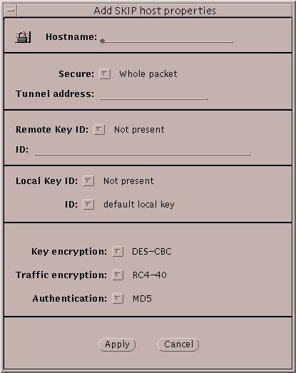

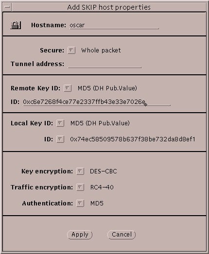

You next add an ACL so the Administration Station and Screen can use encrypted communication.
Click the Add button, and under Host, choose the SKIP security option.
The Add Skip host properties window appears, as shown in Figure 4-30.
Use the information contained in the AdminSetup.readme file, obtained in the preceding procedure, and complete the fields.
Type Name_of_Screen in the Hostname field.
In the Secure field, select Whole Packet from the drop-down list.
In the Remote Key ID, make the appropriate selection from the drop-down list.
Refer to the AdminSetup.readme file to select the correct Remote Key ID. For self-generated certificates on the Administration Station, select MD5 (DH Public Value). For issued certificates, select IPv4. See Figure 4-31 for a sample of the Add SKIP Host Properties window completed.
In the Local Key ID, make the appropriate selection from the drop-down list.
Refer to the AdminSetup.readme file to select the correct Local Key ID. For self-generated certificates on the Administration Station, select MD5 (DH Public Value). For issued certificates, select IPv4. The ID value is filled in automatically.
Turn SKIP on. From the pulldown menu for "Access control is:", located at the top of the skiptool window, select `enabled'.
When you select enabled from the pulldown menu, a window appears when you save the configuration. Click Cancel to prevent these required systems, which are part of the default configuration, from showing up in the Authorized Systems window.
Select Save from the File pulldown menu.

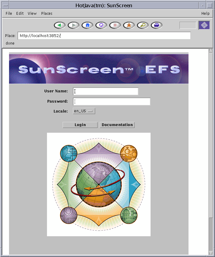

To configure and manage your SunScreen from your Administration Station, run a Java-enabled Web browser compliant with JDK 1.1.3 or later, and launch the Administration GUI by typing the following URL:
http://Name_of_Screen:3852/ |
The Administration GUI appears, as shown in Figure 4-32.
To login, type the following and Click Login:
User Name: admin Password: admin |
You next configure and manage your SunScreen with the Administration GUI. See the SunScreen EFS 3.0 Administration Guide for further instructions.
