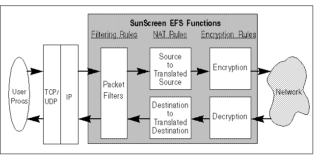

The sequence in which a Screen performs packet filtering, network address translation, and encryption and decryption depends on the direction in which the packets are moving, as shown in the following figure.
When a host on a private (internal) network sends a packet addressed to an outside host through a Screen, the Screen does the following:
The Screen applies its packet filter rules to the packet to determine whether the packet meets the criteria of an ALLOW or DENY rule. If the packet meets the criteria of a DENY rule, then the packet is denied and, if so specified, can make a log entry identifying the circumstances.
If the packet meets the criteria of an ALLOW rule, the Screen determines whether it should use NAT to convert the source IP address information in the packet. If NAT is being used, the source address information in the packet is modified. Depending on the type of packet, the Screen may also modify address information in the data portion of the packet or modify packet checksums.
The Screen determines if the packet should be encrypted based upon the information in the rule that matched. If the packet should be encrypted, the Screen calls the SKIP key manager, which identifies the appropriate encryption keys and algorithms and encrypts the packet. The SKIP key manager passes the encrypted packet back to the Screen, which then forwards the packet to the public network.
When a Screen receives a packet addressed to an internal host from a host on the public network, it performs a similar sequence of actions:
If the incoming packet has been encrypted with the Screen's public key, the Screen calls the SKIP key manager, which identifies the appropriate keys and decrypts the packet. The SKIP key manager passes the decrypted packet back to the Screen.
The Screen determines whether it should use NAT to convert the packet's destination IP address to an internal IP address. If NAT is being used, the address information in the packet is modified.
The Screen applies its filtering rules to the packet to determine whether the packet meets the criteria of an ALLOW or DENY rule. If the packet meets the criteria of an ALLOW rule, the Screen forwards the packet to the internal network. If the packet meets the criteria of a DENY rule, then the packet is denied.

SunScreen EFS 3.0 uses the SunScreen Simple Key-Management for Internet Protocols (SKIP) as the basis for its encryption technology. SKIP provides secure, encrypted communication between a remote Administration Station and the Screen and between a Screen and a remote SKIP host.
For detailed information on how SKIP encryption works, refer to the SunScreen SKIP 1.5 User's Guide.

Policy rules are based on sets of ordered policy rules. You set up these rules to reflect the security policy for your site. These rules specify the action to be taken for services between two addresses that are on different interfaces of the Screen.
When you install the SunScreen EFS 3.0 software, you start with a policy object called Initial that establishes access rules for basic TCP/IP services. You then define policy rules to allow clear or encrypted communication between hosts that meet your criteria.
Each rule must specify all three selection criteria: source address, destination address, and type of service. Each rule can also specify what action to take if a packet meets those criteria. For example, different rules will specify whether the Screen should forward or drop the packet; encrypt or decrypt the packet; record the packet in the Screen logs; and issue ICMP messages or SNMP traps concerning the packet. The default rule is to drop any packet that does not have a specific Encryption or Allow action.
The sequence in which rules are ordered is critically important. When the Screen processes packets, it compares the packet information to each rule in the order it occurs in the Screen's active policy. When a packet meets the criteria of a rule, the Screen applies the actions specified for that rule and disregards the following rules.
You can use the administration GUI or the command line (see Appendix B) to set up the table of ordered rules for a policy, which allows you to edit rule components, such as source and destination addresses, directly. You can change the order of the rules by dragging and dropping them through the configuration editor.
The basic syntax for a rule is:
Service Source_address Destination_address optional_Time optional_Encryption "action" optional_Proxy |
