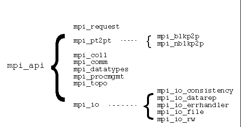

Every TNF probe for MPI is associated with the mpi_api group, so choosing that group allows Prism to probe all the MPI routines for which probes exist (including the I/O routines). Additional groups exist to probe subsets of the MPI routines, as well. Some routines are associated with more than one group. The ten groups for MPI routine probes are these:
mpi_api - All the TNF probes for MPI routines
mpi_blkp2p - Probes for blocking point-to-point routines
mpi_coll - Probes for collective routines
mpi_comm - Probes for communicator-related routines
mpi_datatypes - Probes for data type-related routines
mpi_nblkp2p - Probes for nonblocking point-to-point routines
mpi_procmgmt - Probes for process-management routines
mpi_pt2pt - Probes for all point-to-point routines (blocking and nonblocking)
mpi_request - Probes for functions producing or acting on request(s)
mpi_topo - Probes for topology-related routines

Like the MPI routines, each MPI I/O routine is associated with two TNF probes: one ending in _start, and one ending in _end. Probes are also included for some specific arguments, most of which are defined in the MPI standard and described in the man pages included with Sun MPI 4.0. The ctxt argument for the context id assigned to a particular communicator, however, is not mentioned in the standard or man pages. It is described in "TNF Probes for MPI".
Every TNF probe for MPI I/O is associated with both the mpi_api and the mpi_io groups. Choosing mpi_api allows Prism to probe all the MPI routines for which probes exist, whereas choosing mpi_io allows you to focus on the I/O routines. Additional groups exist to probe subsets of the I/O routines, as well. The seven groups for MPI I/O routine probes are these:
mpi_io - MPI I/O routines only
mpi_io_consistency - Atomicity and synchronization routines
mpi_io_datarep - Data representation routines
mpi_io_errhandler - Error-handling routines
mpi_io_file - Group(s), in addition to mpi_api and mpi_io
mpi_io_rw - Read/write routines
