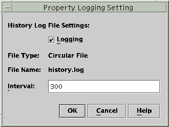

After you install the Performance Reporting Manager software, the Manage Jobs features of Sun Management Center 3.5 are enhanced, and a new option appears in the New Task dialog box. This new option is Data Logging. Data Logging appears in the Show Task Type and Task Type drop-down menus. When Data Logging is selected as the Task Type, the Logging Setting button appears next to the Data Properties table. The logging of data properties is enabled with the Property Logging Setting dialog box. You access the Property Logging Setting dialog box from the Logging Setting button. You can also change the interval time properties are logged at the same time. The default logging interval is 300 seconds. For more information about the Manage Jobs features, see “Managing Group-related Jobs” in Sun Management Center 3.5 User's Guide.

The Property Logging Setting dialog box launches.
Select the checkbox next to Logging if it is not already selected.
The data property is now being logged.
Type the desired time interval, in seconds, in the Interval text field.
The default is 300 seconds. The data property is logged at the interval specified.
Click OK to save your changes.
The Property Setting Dialog box is dismissed.

From the New Task dialog box, select the row that contains the data property.
If you added more than one data property to the task, you must do this one row at a time. The Logging Setting button is enabled.
Click Logging Setting.
Remove the check in the box next to Logging by deselecting it.
In the New Task dialog box, click Add Task to save.
Click Close to dismiss the New Task dialog box when finished.
