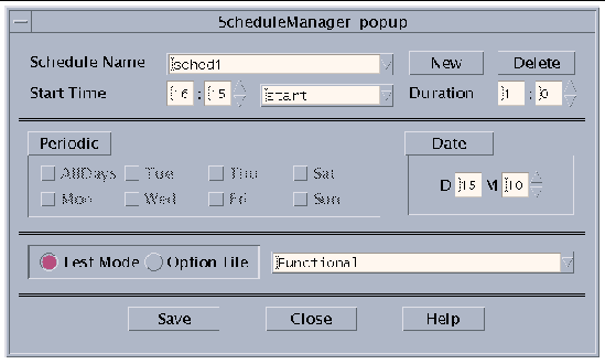

The Schedule Manager allows you to create, edit, and delete schedules. Creating a new schedule requires selecting standard options or an option file. You must save schedules with a unique name. None and Untitled cannot be used as schedule names. If you try to save a new schedule or modify an existing one with a name already in use, the Schedule Manager will prompt you before overwriting. You can also view the details of all of the schedules in the SunVTS graphical interface.
From the main SunVTS Diagnostic window, select SchedulerSchedule ManagerCreate Schedule to bring up the Schedule Manager dialog box for creating, editing, or deleting schedules. Only one schedule can be run at a time. You can remove the currently running schedule and all schedules in the scheduler queue by selecting SchedulerÆSchedule ManagerClean All from the main window. The main SunVTS Diagnostic window indicates the currently running schedule.
To reach the Schedule Manager dialog box below, select SchedulerSchedule ManagerCreate Schedule from the main SunVTS Diagnostic window. A list of the existing schedules and the standard options are displayed.
The following table describes the options listed in the Schedule Manager dialog box:
To bring up an existing schedule for viewing or editing, select a schedule in the Schedule Name drop-down menu, or enter the name of a schedule in the field.
