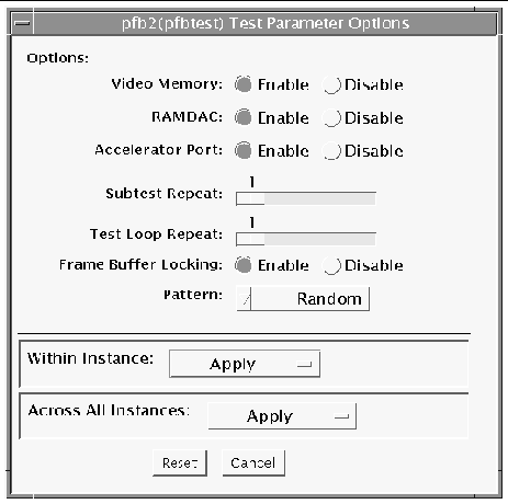

To reach the dialog box below, right-click on the test name in the System Map and select Test Parameter Options. If you do not see this test in the System Map, you might need to expand the collapsed groups, or your system may not include the device appropriate to this test. Refer to the SunVTS User's Guide for more details.
By default, all options are enabled except frame buffer locking.
Screenshot of the m64test Test Parameter Options dialog box.
FIGURE 8-1 pfbtest Test Parameter Options Dialog Box
