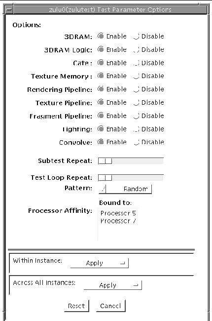

To reach the dialog box below, right-click on the test name in the System Map and select Test Parameter Options. If you do not see this test in the System Map, you might need to expand the collapsed groups, or your system may not include the device appropriate to this test. Refer to the SunVTS User's Guide for more details.
By default, all zulutest options are enabled except for the Stereo test.
Screenshot of the afbtest Test Parameter Options dialog box.
FIGURE 10-1 	 zulutest  Test Parameter Options Dialog Box
