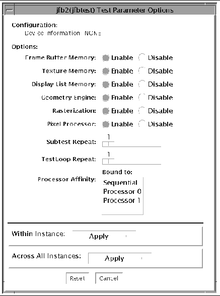

To reach the following dialog box, right-click on the test name in the System Map and select Test Parameter Options. If you do not see this test in the System Map, you might need to expand the collapsed groups, or your system might not include the device appropriate to this test. Refer to the SunVTS User's Guide for more details.
By default, all jfbtest options are enabled.
Screenshot of the ifbtest Test Parameter Options dialog box.
FIGURE 12-1 jfbtest Test Parameter Options Dialog Box
TABLE 12-1 jfbtest Options
jfbtest Options
Description
