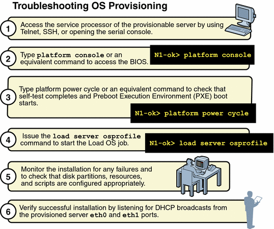

Use the following graphic as a guide to troubleshooting best practices. The graphic describes steps to take when you initiate provisioning operations. Taking these steps will help you troubleshoot deployments with greater efficiency.
This graphic illustrates
troubleshooting steps to take when initiating
deployments.
