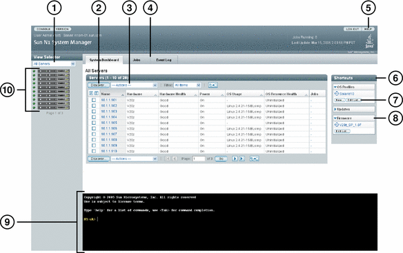

The following figure provides a quick reference overview of the browser interface.
Use the View Selector menu to change between viewing all of the servers, the servers by health state, or the servers by group in the N1 System Manager.
Click the Discover button to launch a wizard that enables you to add servers to the N1 System Manager. Click the System Dashboard tab to view all discovered servers in the All Servers table.
Use the Actions menu to perform operations on servers selected in the table, such as loading (installing) software, enabling monitoring, and managing power.
Click the Jobs or Event Log tabs to see a listing of jobs or events in the N1 System Manager, respectively. The Jobs tab enables you to track the status of the operations and commands being performed on the system.
Click the Help button to launch a searchable help system that includes instructions for browser interface tasks and corresponding command line examples.
Drag-and-drop the software icons onto a server or server group in the table to begin the installation.
Click the Edit List button to change the list of software icons that appear in the Shortcuts pane.
Click the arrows to expand or collapse the Shortcut lists.
Use the command line pane to issue commands provided by the N1-ok> shell. Use this integrated shell to issue commands or to view the command output of operations initiated from the Actions menu or wizards.
You can type help topic in the command line pane to display help for a command, where topic is the command for which you want more information.
You can also type a command and then press the Tab key to display completion information. For example:
N1-ok> create os [press the Tab key]
Potential matches (create os):
os Create (copy) an OS distribution
osprofile Create or copy an OS profile
N1-ok>
Use the server icons to view power status and running jobs. Click a server icon to view the Server Details page.
