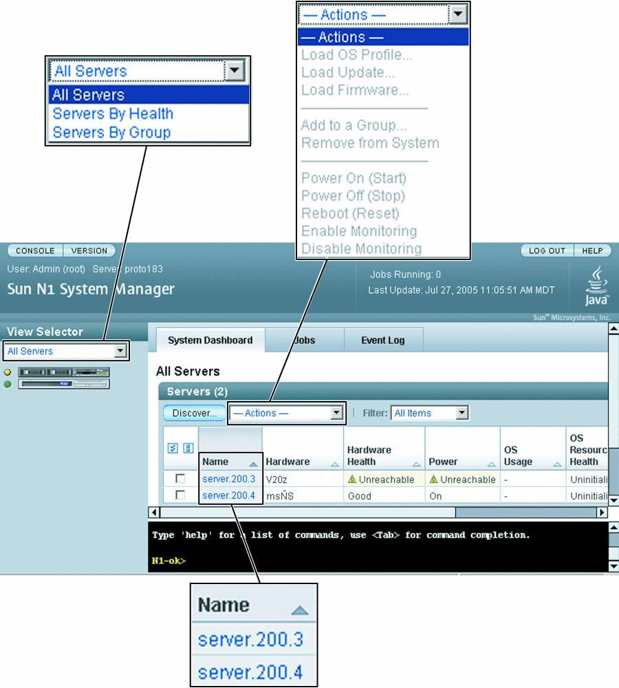

The following graphic shows the View Selector menu, the Actions menu, and the server name links.

The following aggregate server actions are supported:
Starting, stopping, and resetting server power.
Listing and refreshing server data.
Loading servers with OS profiles, updates, and firmware. See Chapter 3, Provisioning Operating Systems, OS Updates, and Firmware Updates.
Enabling and disabling server monitoring. See Chapter 5, Monitoring Your Servers.
Adding servers to server groups. SeeCreating and Maintaining Server Groups.
Removing servers from the N1 System Manager.

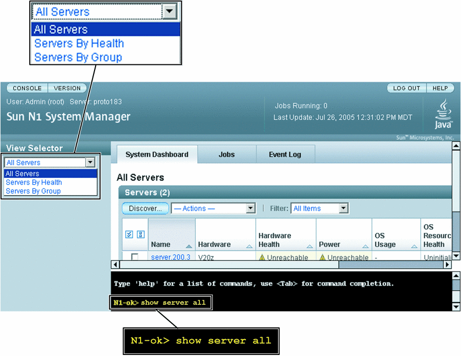

To list servers, use the View Selector menu. Alternatively, use the show command with the server keyword and the all subcommand to list all servers in the N1 System Manager.
As the following graphic shows, you can use the View Selector menu or the show server command to list servers.

The following example shows how to view all servers in the system by using the show command.
N1-ok> show server all |
A list of all servers in the system appears. See show server in Sun N1 System Manager 1.2 Command Line Reference Manual for details.

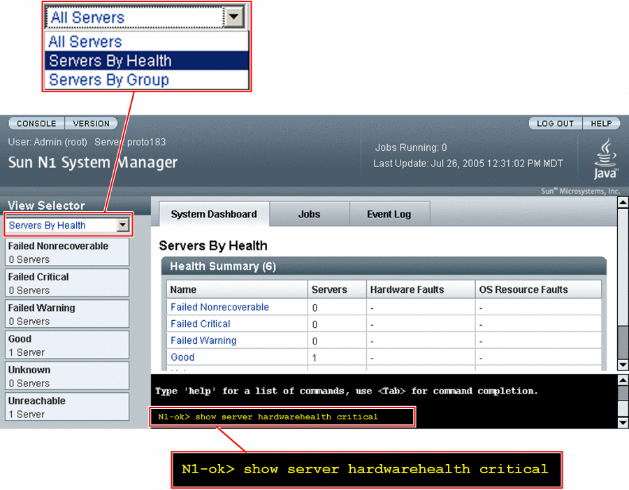

This procedure describes how to view failed servers using the browser interface. The example following the procedure provides a command-line equivalent.
The following graphic shows how to use the View Selector menu to list servers by heath state. Alternatively, use the hardwarehealth or oshealth subcommands and an appropriate health state to filter the list of servers by health state. For example:
N1-ok> show server hardwarehealth nonrecoverable |

The following example shows how to view servers that have a health status of critical.
N1-ok> show server hardwarehealth critical Name Hardware Hardware Health Power OS Usage OS Resource Health 10.0.0.26 V20z Failed Critical On Solaris Unknown |

The following graphic shows how to stop a group by using the Actions menu on the Servers By Group page, or by issuing the stop group command.
For syntax and parameter details, type help stop server or help stop group at the N1–ok command line.
