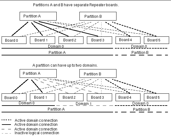

The Sun Fire system can be divided into partitions and domains. A single physical system can have multiple independent logical systems, each running its own operating system, by using partitions and domains. Partitions and domains differ only in terms of their flexibility and isolation.
A single physical Sun Fire 6800 system can be divided into two partitions. All connections between boards of one partition and boards of the other partition are disabled. The system logically behaves as two separate systems.
If the partitions are assigned to the physical half of the Sun Fire 6800 system, then the power planes associated with each partition are also isolated. A Sun Fire 6800 system can be divided into two partitions by logically isolating one set of Repeater boards for each partition. The Sun Fire 4810/4800/3800 systems also support two partitions.
Each partition on the Sun Fire 6800 system can have up to two domains, allowing for up to four domains total. For the Sun Fire 4810/4800/3800 systems, if a single partition is established, it can support two domains; if two partitions are established, however, each partition will support only one domain.
The Sun Fire system can be logically divided into multiple domains. Since each domain is comprised of one or more system boards, a domain can have between one and 24 processors. Each domain runs its own instance of the operating system and has its own peripherals and network connections. You can configure domains without interrupting the operation of other domains on the same system.
While production work continues on the remaining (and usually larger) domain, there will not be any adverse interaction between any of the domains. You can gain confidence in the correctness of applications without disturbing production work. When the testing work is complete, the system can be rejoined logically without rebooting (there are no physical changes when you use domains). Thus, if problems occur, the rest of your system is not affected.
The Sun Fire 6800 system can have up to four domains. The Sun Fire 4810/4800/3800 systems can each have up to two domains. Each instance of the Solaris Operating Environment runs in its own domain. Domains do not depend on each other and do not interact with each other.
A single partition on a Sun Fire 6800 system can be divided into two domains. Unlike partitions, domains share the Repeater boards. Each domain gets half the address bandwidth of a full system bus.
