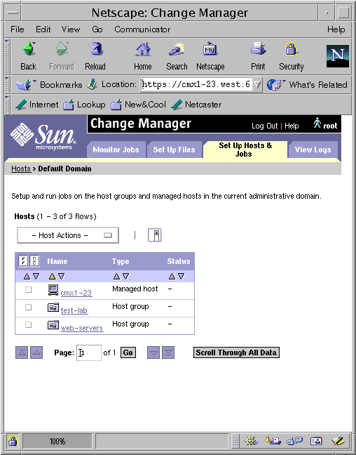

Manage host groups and managed hosts. You can arrange managed hosts in a hierarchy of host groups. This hierarchy can be in an administrative domain that you create by using Sun Management Center.
You can perform the following actions in the Set Up Hosts & Jobs section:
Optionally, select an administrative domain.
Administrative domains are created and managed by the Sun Management Center application. When using Change Manager, you can only select from existing administrative domains.
Create host groups.
Add managed hosts with specific properties.
Import one or more hosts simultaneously by means of a file that contains host names and host property values.
Rename a managed host or host group.
Copy a managed host to another host group.
Move managed hosts and host groups to another host group.
Remove managed hosts and host groups.
View and modify managed host properties and property values.
View host group contents.
Run deployment commands and audit commands on host groups and managed hosts from the Set Up Hosts & Jobs section. Long-running operations, such as updates, imports, and exports, become jobs.
Perform an initial installation of managed hosts.
Update managed hosts.
Reinstall managed hosts.
Fall back to the previous boot environment.
Build manifests for managed hosts.
Audit managed hosts by comparing their manifests against a baseline manifest.
Get the software status of managed hosts.
Reboot managed hosts.
Halt the operating system of managed hosts.

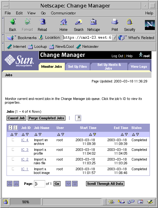

View the status of current jobs and recent jobs in the job queue. A job is a task running on a managed host or on the Change Manager server. A job is initiated from the Set Up Files section or Set Up Hosts & Jobs section of the browser interface. The queue shows the status of current jobs and recent jobs that have been submitted to run on managed hosts.
You can perform the following actions in the Monitor Jobs section:
Cancel pending jobs or running jobs.
Purge completed jobs from the job queue.

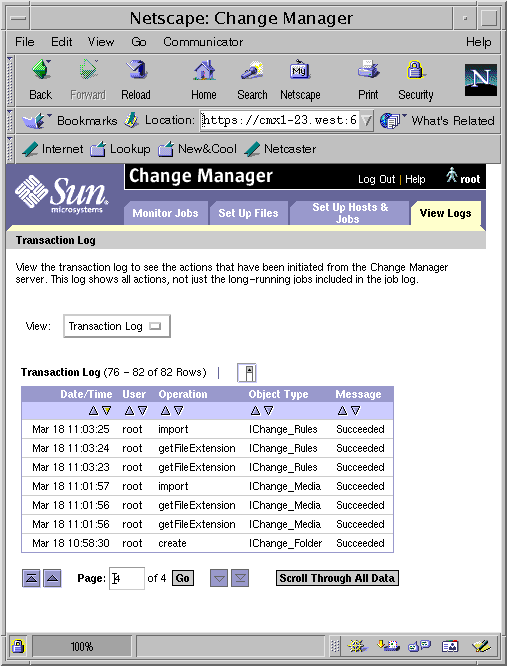

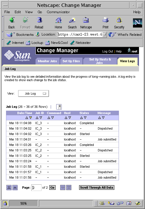

View the job log and transaction log to diagnose failures. The log entries detail Change Manager operations. The job log shows jobs started, such as import, update, and audit. The transaction log shows all actions initiated by Change Manager.
