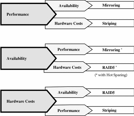

Use the following high-level decision tree to determine the best fit for DiskSuite in your environment.
Step 1. |
Step 2. |
Step 3. |
Choose the factor most important to you. |
Choose the next most important factor. |
For your needs, the best DiskSuite feature is ... |
Example: If your most important factor is lower hardware costs, followed by availability, your needs would be best served by using RAID5 metadevices.
For a complete discussion of how to plan for DiskSuite, refer to Solstice DiskSuite 4.2 Reference Guide.
