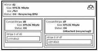

A Mirror object has two Status fields: one for the mirror device itself, and individual Status fields for each submirror. The Status field for a mirror, as explained in Table 3-3, gives a high-level status.
Table 3-3 Mirror Status Keywords|
Keyword |
Meaning |
OK |
The mirror has no errors and is functioning correctly. |
Attention |
A submirror has a problem, but there is no immediate danger of losing data. There are still two copies of the data (the mirror is three-way mirror and only one submirror failed), or a hot spare has kicked in. |
Urgent |
The mirror contains only a single good submirror, providing only one copy of the data. The mirror is only one failure away from losing data. |
Critical |
All submirrors have errors and data has potentially been corrupted. |
Table 3-4 shows the Status fields of submirrors, and possible actions to take.
Table 3-4 Submirror Status Keywords|
Keyword |
Meaning |
Action |
OK |
The submirror has no errors and is functioning correctly. |
None. |
Resyncing |
The submirror is actively being resynced. |
None. An error has occurred and been corrected, the submirror has just been brought back online, or a new submirror has been added. |
Component Resyncing |
A slice in the submirror is actively being resynced. |
None. Either a hot spare slice or another slice has replaced an errored slice in the submirror. |
Attaching |
The submirror is being attached. |
None. |
Attached (resyncing) |
The entire submirror is being resynced after the attach occurred. |
None. |
Online (scheduled) |
The submirror will be brought online the next time you click Commit. |
Click the Commit button to enable the submirror. |
Offline (scheduled) |
The submirror will be brought offline the next time you click Commit. |
Click the Commit button to offline the submirror. |
Offlined |
The submirror is offline. |
When appropriate, bring the submirror back online, for example, after performing maintenance. See "How to Place a Submirror Offline and Online (DiskSuite Tool)". |
Maintenance |
The submirror has an error. |
Repair the submirror. You can fix submirrors in the "Errored" state in any order. See "How to Enable a Slice in a Submirror (DiskSuite Tool)", or "How to Replace a Slice in a Submirror (DiskSuite Tool)". |
Last Erred |
The submirror has errors, and data for the mirror has potentially been corrupted. |
Fix submirrors in the "Maintenance" state first, then fix the submirror in the "Last Erred" state. See "How to Enable a Slice in a Submirror (DiskSuite Tool)", or "How to Replace a Slice in a Submirror (DiskSuite Tool)". After fixing the error, validate the data. |

In the Stripe Info window, select the slice with the "Critical" status and click Enable. Then click Close.
The slice status changes from Critical to Enabled. The submirror status changes from Critical (Errored) to Critical (Uncommitted).
Click inside the Mirror object. Then click Commit.
A mirror resync begins. The submirror status changes to "Component Resyncing."
When the resync is done, verify that the status of the mirror is OK.

Click the top rectangle of the Mirror object then click Commit.
DiskSuite starts a resync of the replaced submirror.

Use this task to expand a mirror's submirrors. You need to expand each submirror. You can expand a submirror while it is in use, without having to take it offline.
Make sure you have met the prerequisites ("Prerequisites for Maintaining DiskSuite Objects") and have read the preliminary information ("Preliminary Information for Expanding Slices and Metadevices").
Double-click an existing Mirror object in the Objects list.
The object appears on the canvas.
To add a slice to the submirror, click Slices to open the Slice Browser. To add a Concat/Stripe object, select one from the Objects list.
Select and drag a slice from the Slice Browser, or a Concat/Stripe object from the Objects list, to the top of one of the submirror rectangles in the Mirror object.
Select a slice or concat/stripe of the appropriate size. Use Control-click to select multiple slices.
When you drag the slice or Concat/Stripe object to the Mirror object, a Warning dialog box appears because the submirror will be a different size after the addition. Click Continue.
The slice or concat/stripe object is added to the bottom of the submirror rectangle.
Select and drag a slice or Concat/Stripe object to the top of one of the second submirror rectangles in the Mirror object.
A Validation dialog box appears. Click OK.
If you have a third submirror, repeat this step.
Click the top of the Mirror object then click Commit.
Mounted file system only: A GrowFS dialog box appears. Click Grow Now to begin running the growfs(1M) command. A GrowFS Running message appears. If you click Terminate GrowFS, the command is aborted. Otherwise, when the growfs(1M) command finishes, you are returned to the DiskSuite Tool window.
Application using the raw device: Such applications must have their own method, outside of DiskSuite, to recognize the expanded space.
To verify that the mirror was committed, display the Configuration Log.

Before starting, identify the concatenation or stripe to be used as the submirror. It must be the same size (or larger) as the existing submirror in the mirror. If you have not yet created either, refer "Creating Stripes and Concatenations".
Make sure you have met the prerequisites ("Prerequisites for Maintaining DiskSuite Objects"), and have read the preliminary information ("Preliminary Information for Mirrors").
Double-click an existing Mirror object in the Objects list and verify that its status is "OK."
Drag the Concat/Stripe object to be attached to the mirror to the top of the Mirror object.
A resync of the new submirror is initiated.
This example shows a a mirror, d2, to which a submirror, d7 has been attached. The mirror automatically syncs the data on new submirror.
