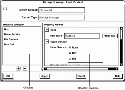

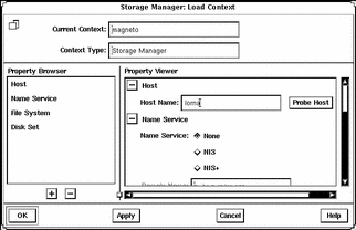

Storage Manager's Load Context Property Book
Storage Manager introduces the concept of a property book. A property book is the mechanism by which you identify, view, and modify the properties of editable objects, such as disks or file systems. A property book, using a book metaphor, contains a list of chapters that represent properties for the object. You can expand each chapter to view or modify the properties.
The purpose of the Load Context Property Book is for you to set the context in which Storage Manager will operate. Generally, a context is the way to manage the properties of an object. In the case of File System Manager, the context includes which host to manage, what name service to modify or how to view and modify the file systems on a server. In the case of Disk Manager, the context includes what diskset (a logical grouping of disks) to modify if you have DiskSuite software installed.
The Load Context Property Book is displayed when you start Storage Manager from the Solstice Launcher. If you start either Disk Manager or File System Manager from the DiskSuite Tool Tools menu, you can also display this window by choosing Load from the File menu, or by clicking on the Load Context icon in either tool bar. Figure A-1 shows the Storage Manager's Load Context Property Book.
Figure A-1 Storage Manager's Load Context Property Book
Graphic
Here are some brief descriptions of the areas within Storage Manager's Load Context Property Book:
For more reference information on the chapters that are available from the Load Context Property Book (Host, Name Service, File System, Disk Set), refer to online help.
How to Load an Initial Context
This procedure assumes that the Load Context window is displayed as a result of clicking on the Storage Manager icon in the Solstice Launcher, or by choosing Load from the File menu in either File System Manager or Disk Manager.
  1. If you want to view or modify the context of the system where you started the Solstice Launcher and Storage Manager, make needed changes to the Name Service, File System, and Disk Set chapters, if any. Skip to Step 5.
  2. If you want to view or modify the context of a system other than the one where you started the Solstice Launcher and Storage Manager, delete the existing name in the Host Name field and type the name of the host whose context you want to view or modify.
  3. Click Probe Host.
    A System Discovery window is displayed, indicating that information is being updated from the specified host.
  4. If desired, make changes to the Name Service, File System, and Disk Set chapters.
  5. Click OK.
    A System Discovery window is displayed, indicating that Storage Manager is validating context parameters as well as discovering devices, directories, and mount points on the specified host.

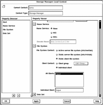

How to Load a Different Context
This procedure assumes that Storage Manager has an active current context (that is, the File System Manager main window or Disk Manager main window is open).
  1. Choose Load from the File menu, or click the Load Context icon in the tool bar.
    The Load Context window is displayed, with the current context's host name displayed in the Host chapter.
  2. Delete the existing name in the Host Name field and type the name of the host whose context you want to view or modify.
  5. Click OK.

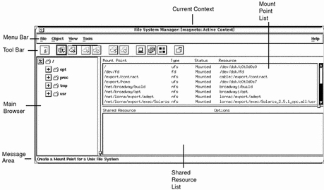

File System Manager's Main Window
Figure A-2 shows the important areas of the File System Manager's main window.
Figure A-2 File System Manager's Main Window
Graphic
Here are some brief descriptions of the areas within File System Manager's main window:

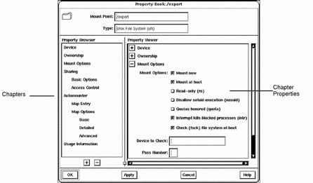

File System Manager Property Book
There are three ways to open the File System Manager Property Book.
Figure A-3 shows the important features of the File System Manager Property Book.
Figure A-3 File System Manager Property Book
Graphic
For more reference information on the chapters that are available from the File System Manager Property Book, refer to the online help.

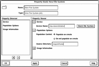

How to Create a UFS File System
  1. Choose Create File System from the Object Menu.
    The New File System property book is displayed.
  2. Open the Device chapter.
  3. Enter the device name of an unused slice or metadevice on which to create the UFS file system.
    You can either type the name of a device, or drag and drop a slice from Disk Manager or a metadevice from DiskSuite Tool.
  4. If you want to verify that the specified device is currently available, click the Check File System button.
  5. If you want to copy the contents of an existing directory into the new file system, open the Population Options chapter and select Populate on Create. Enter the Source Directory from which to copy the contents into the new file system.
  6. Click OK.
Example -- Creating a UFS File System

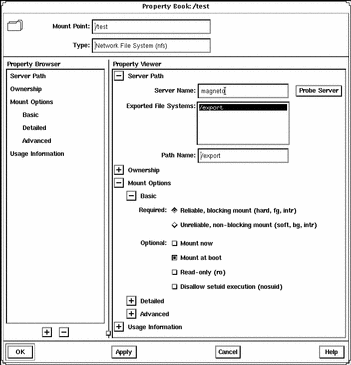

  3. If you are creating a UFS mount point, skip to Step 6. If you are creating an NFS mount point, open the Server Path chapter.
  4. Type the name of a server and click Probe Server.
    A list of exported file systems is displayed in the Exported File Systems list.
  5. Click the desired file system name or type a name in the Path Name field. Skip to Step 9.
  6. Open the Device chapter.
  7. Enter the device name of an unused slice or metadevice on which to create the UFS mount point.
    You can either type the name of a device or drag and drop a slice from Disk Manager.
  8. If you want to verify that the specified device is currently available, click the Check File System button.
  9. Make modifications to the other chapters, if needed.
    For example, in the Mount Options chapter you can choose to mount now and/or mount at boot time.
  10. Click OK.
    The mount point appears in the Mount Point list.

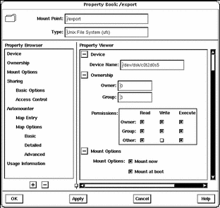

How to Modify the Properties of a Mount Point or Directory
  1. Select a directory or mount point from the main window.
    You can select a directory or mount point from the main browser, the Mount Point list, or the Shared Resource list.
    Note -
    Once you select a mount point or directory, the Object menu may allow you to automatically mount a file system, unmount a file system, share a directory, or unshare a directory. If you want to complete one of these tasks, it is faster to use the Object menu rather than make the change using the Property Book.
  2. Choose Properties from the Object menu.
    The property book for the file system or directory is displayed.
  3. Open the available chapters to modify the properties for the mount point or directory.
    Click Help in the property book to see detailed information about each chapter.
  4. Click OK.
Example -- File System Manager Property Book
Graphic

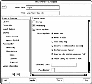

How to Mount or Unmount a File System
  1. Select a mount point from the main browser, Mount Point list, or Shared Resource list.
    Note -
    Once you select a mount point, the Object menu may allow you to automatically mount or unmount a file system. This method is faster than making the change using the Property Book.
    The property book for the file system is displayed.
  3. Open the Mount Options chapter to modify the mount options (for example, mount or unmount the file system).
  4. Click OK.
Example -- Mounting a File System

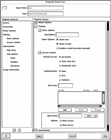

How to Share or Unshare a Directory
  1. Select a directory or UFS mount point from the main browser, Mount Point list, or Shared Resource list.
    Note -
    Once you select a directory or mount point, the Object menu may allow you to automatically share or unshare it. This method is faster than making the change using the Property Book.
  3. Open the Sharing chapter to modify the share options (for example, share or unshare the file system).
  4. Click OK.
Example -- Sharing a Directory

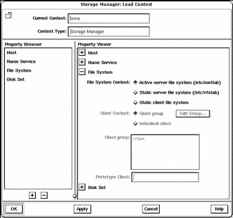

Active server file systems are the file systems on a server that are currently mounted or shared. This is the same information as contained in the /etc/mnttab file.
  1. Click the Load Context icon or choose Load from the File menu.
    The Load Context property book is displayed.
  2. Open the File System chapter, if not done already.
  3. Click the Active Server File System button.
  4. Click OK.
    The file systems that are currently mounted on the server are displayed in the Mount Point list on the main window.
    The directories that are currently shared on the server are displayed in the Shared Resources list on the main window.
Example -- Viewing Active Server File Systems

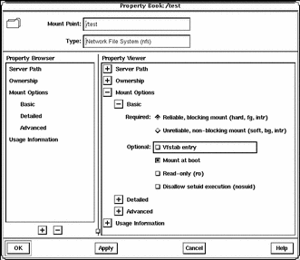

How to Remove a Mount Point From the /etc/vfstab File
  1. Perform the procedures in "How to View Static Server File Systems".
  2. Select a mount point from the main browser, Mount Point list, or Shared Resource list.
  3. Choose Properties from the Object menu.
  4. Open the Mount Options chapter.
  5. Open the Basic subchapter.
  6. Click Vfstab Entry.
    You are toggling (deselecting) this property.
  7. Click OK.
    The mount point no longer appears in the Mount Point list.
Example -- Removing a Mount Point Entry From the /etc/vfstab File

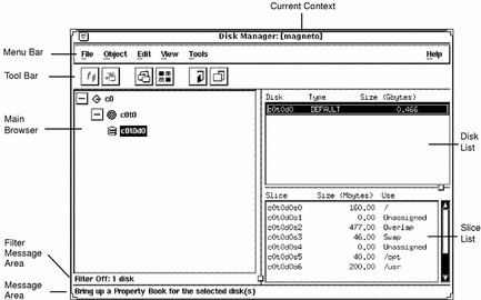

Disk Manager's Main Window
Figure A-4 shows the important areas of the Disk Manager's main window.
Figure A-4 Disk Manager's Main Window
Graphic
Here are some brief descriptions of the areas within Disk Manager's main window:

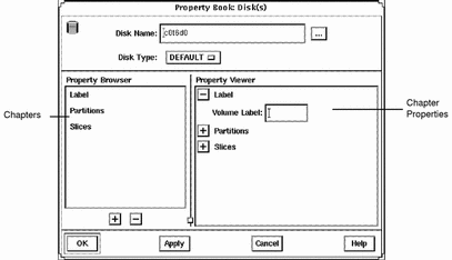

Disk Manager Property Book
There are three ways to open the Disk Manager Property Book.
Figure A-5 Disk Manager Property Book
Graphic

How to Specify a Volume Label
  1. Select the disk that you want to modify in the Disk Manager main browser.
  2. Open the Property Book for the selected disk.
    For more information see "Disk Manager Property Book".
    The Property Book window appears.
  3. Open the Label chapter.
  4. Delete the existing name in the Volume Label field, if applicable.
  5. Enter the name of the volume label, which must be an alphanumeric string of 8 or fewer characters.
  6. Click OK.
Example -- Specifying a Volume Label
Graphic

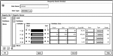

How to Modify fdisk Partitions
  3. Open the Partitions chapter.
    Size the Property Book window so that the entire partition layout is visible.
  4. Click the select box in the Editable column that corresponds to the fdisk partition you want to edit.
  5. Modify the size of an fdisk partition(s) by clicking on the arrows in the Slider portion of the window, or click the appropriate Start or End field in the Partition Data portion of the window, type in a value, and press Return.
    For reference information, see online help.
    Note -
    For x86 platforms, fdisk Solaris partitions must start at cylinder 1 or higher and they may not overlap.
  6. If desired, select the button in the Boot column to make the fdisk partition active (the one whose operating system will be used at system start-up).
  7. Choose the type of the fdisk partition.
    Choose the appropriate type using the menus in the Type column.
  8. Click OK.
Example -- Modifying fdisk Partitions
Graphic

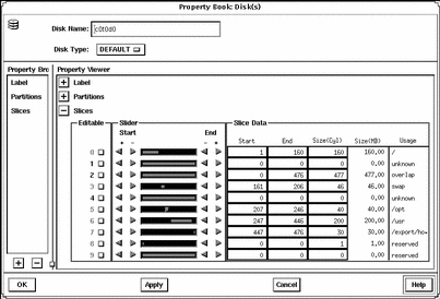

How to Modify Slice Geometry
  3. Open the Slices chapter.
    Size the Property Book window so that the entire slice layout is visible.
  4. Click the select box in the Editable column that corresponds to the slice you want to edit.
  5. Modify the size of a slice(s) by clicking on the arrows in the Slider portion of the window, dragging the bar indicators, or typing values in the Start and End fields.
    Note -
    For x86 platforms, slices must start at cylinder 1 or higher and may not overlap.
  6. Click OK.
Example -- Modifying Slice Geometry
Graphic
