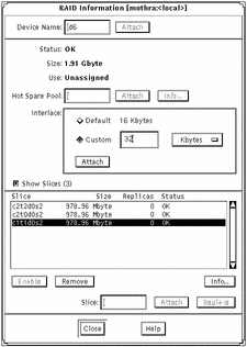

[Optional] To change the default interlace value of 16 Kbytes, point the cursor inside the rectangle where "stripe 0 of dx" is displayed, and display the pop-up Stripe Information window for this striped metadevice.
To change the interlace value, click Custom and type the new value in the field next to the Custom button. This value can be in Kbytes, Mbytes, or sectors. You can configure it by using the drop-down menu beside this field. Click Attach to set the value, then click Close.
For more information on setting the interlace value, refer to Solstice DiskSuite 4.2.1 Reference Guide.
The interlace value cannot be changed after committing the metadevice.

Click the RAID5 template.
An unassigned and uncommitted RAID5 object appears on the canvas. The metadevice name is automatically assigned.
[Optional] Change the default metadevice name.
[Optional] Change the default interlace size of 16 Kbytes.
Display the object's pop-up menu and choose Info. The RAID Information window for this RAID5 metadevice appears.
To change the interlace value, click Custom and type the new value in the field next to Custom. This value can be in Kbytes, Mbytes, or sectors, and is configurable via the drop-down menu beside this field. Click Attach to set the value, then click Close.
See Solstice DiskSuite 4.2.1 Reference Guide for more information on setting the interlace value.
Click Slices to open the Slice Browser.
Select the slices and drag them to the top of the RAID5 object.
Use Control-click to select multiple slices. You need at least three slices.
Click the top rectangle of the RAID5 object then click Commit.
DiskSuite starts initializing the RAID5 metadevice.
To verify that the RAID5 metadevice was committed, display the Configuration Log.
You must wait for the initialization to finish before you can use the RAID5 metadevice.
This example shows a RAID5 metadevice. Notice that the size displayed is 1.95 Gbytes even though the metadevice is made of three 999.63 Mbyte slices. (One slice's worth of storage capacity is used for parity.)
