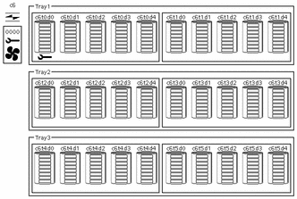

DiskSuite Tool's Disk View window presents a graphical view of the SPARCstorage Array. When you display the Disk View window, the icon for a SPARCstorage Array controller resembles a fibre channel icon, both on the Disk View canvas and in the Controllers window.
Each tray within the SPARCstorage Array is represented by an "etched-in" frame, with a title showing the tray number. Differences between the SPARCstorage Array 100 and 200 are:
SPARCstorage Array 100 - Each SCSI bus within the tray (up to two) is shown by a second etched-in frame within the frame showing the tray number. The disks attached to each SCSI bus within the SSA100 tray appear sequentially within the SCSI frame, with no lines connecting them.
Figure 6-1 shows how the SPARCstorage Array 100 appears in the Disk View window.
If one or both of the busses on the tray has no disks, the bus is "stubbed-out" by showing an empty frame. If one or more of the trays have no disks, DiskSuite Tool does not stub-out the tray(s).
SPARCstorage Array 200 - Just the disks that are within the tray frame are shown, as there is no SCSI bus within the tray. The disks appear sequentially with no lines connecting them.
Figure 6-2 shows how the SPARCstorage Array 200 appears in the Disk View window.
You can also use the Disk View window to display the SPARCstorage Array's unique 12-digit identification number, known as the World Wide Name. The last four digits appear just below the controller icon on the canvas (and on the LCD panel on the SPARCstorage Array itself). You can see the entire number by displaying a controller's Information window.
The Disk View window enables you to check at a glance the status of SPARCstorage Array components, including the battery and fan, and to see if a disk is spun up or down.

Figure 6-3 shows a controller that has the wrench and battery icons displayed.
One or more failures can occur simultaneously. In this case, multiple icons can appear. The Controller Information window will also contain information on the failures, as will the Problem Log.

In the Disk View window, display the controller. Display the controller's Info window and select Device Mappings to view which objects (metadevices, hot spares, state database replicas) might be using the physical device(s).
Stop all access to the disk.
For example, unmount any file systems associated with the disk, or stop all I/O to a database using the disk.
In the Disk View window, select a controller, tray, or single disk and choose Stop Disks from the Object menu.
A Stop Disk dialog box appears, reminding you that all I/O to the disk should be stopped. Click Continue.
The system notifies you when the disk is stopped. Click OK.
For a SPARCstorage Array, a down arrow appears beneath each disk that is stopped, indicating that the disk is spun down. If you stop a SCSI disk, no down arrow appears.

The Disk View window appears. SPARCstorage Array disks that are spun down appear on the canvas with a down arrow beneath the disk.
Select a controller, to start all disks connected to it, or select individual disks using Control-click.
You can also select multiple controllers using Control-click.
Choose Start Disks from the Object menu.
The system notifies you when the disk is started. Click OK.
For a SPARCstorage Array disk, the down arrow disappears from beneath the disk, indicating it has spun up. There is no indication for a SCSI disk.
