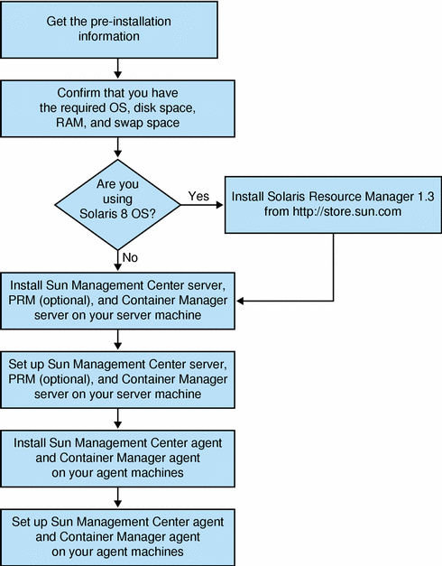

The following flowchart depicts the stages required to install and set up Solaris Container Manager.
Figure 1–1 Stages in Installation
Stages in Installation Process

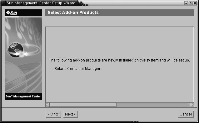

  5. Install Solaris Container Manager and other appropriate add-ons.
    1. Select Solaris Container Manager 1.1 and any other add-ons.
      Figure 1–2 Add-on Products Screen
      Select add-on products to install
    2. If you selected add-on products that have optional components, select the appropriate optional components and click Next.
    3. Review the add-on products binary license and use the scrollbar to scroll down to the end of the text.
    4. To agree to the terms of the license, select I Agree and click Next.
      The Checking Disk Space progress bar appears. If the machine does not have enough disk space, you are asked to provide an alternate file system.

    3. The Select Add-on Products dialog box appears.
      Figure 1–3 Add-on Products Screen
      Select add-on products to set up
      Click Next. The progress bar appears.
      The Add-on Products Setup dialog box appears, informing you that Solaris Container Manager 1.1 has been set up.
