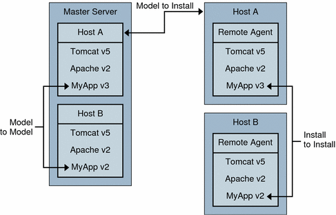

Comparisons are used to validate an installation or system configuration. By comparing the configuration of a host against its original configuration, you can tell if anything has changed. You can also compare one or more hosts against a reference host to ensure that all hosts are configured the same.
Illustration is described in the contexts.
With the provisioning system you can compare one or more hosts against another host, one or more hosts against a model in the Master Server, or a host against its original configuration. The provisioning software allows you to check the entire configuration of a host or limit what is checked to a single directory.
N1 Service Provisioning System software allows you to perform three types of comparisons.
Time Synchronization for Comparisons
Because the time stamp for a comparison is based on the clock in the Master Server, you should run some kind of synchronization utility on all your N1 Service Provisioning System software machines so that all system clocks are synchronized on the same time.
Model to Model Comparisons

Model to Install Comparisons
Unlike Model to Model comparisons, which compare one ideal installation to another, Model to Install comparisons compare the actual state of the installed component or components at deployment time against their current state. You can specify that this comparison compares the model to hosts, host sets, or to component level.
A Model to Install comparison uses snapshot information to compare a component's just-installed state with its current state. A snapshot is a record of the state of an installed component immediately after it has been deployed to a host. The component's XML model includes parameters that control the scope of this snapshot. For example, the XML model can list files, such as log files, that should be ignored during a comparison.
When the provisioning software performs a Model to Install comparison, the Master Server looks up the list of snapshots for all the components being compared. It sends this list to the Remote Agent on the host where the components are installed. The snapshot information includes rules for any files and directories that should be ignored during the comparison. The Remote Agent then processes these rules. Both Master Server and Remote Agents must be using the same locale for the Model to Install comparison to function properly.
