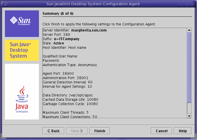

The wizard can also be started without launching the graphical interface. For example, execute /usr/bin/apoc-config -nodisplay to start the wizard in console mode.

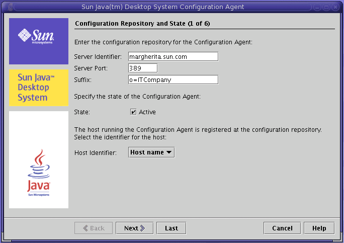

Server Identifier (Server): host name of the LDAP server.
Server Port (Port): port number of the LDAP server.
Suffix (BaseDn): base DN of the LDAP repository.
State: The status of the Configuration Agent. The checkbox can be used to either activate or deactivate the Configuration Agent. To make use of the configuration repository, the Configuration Agent must be active. The activation automatically includes the necessary registration with inetd.
To manually enable or disable the Configuration Agent, log in as root and type the command /usr/lib/apocd enable or /usr/lib/apocd disable, respectively.
Host Identifier (HostIdentifier): can be "HostName" or "IPAddress". The identifier must be set to match the contents of the LDAP attribute that is used to identify hosts. This attribute is defined in the mapping files as Host/UniqueIdAttribute.

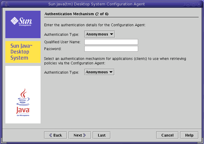

Authentication Type for the Configuration Agent: can be "Anonymous" or "Simple". If "Anonymous" is selected, the Qualified User Name and Password fields are automatically disabled.
Qualified User Name (AuthDn): full DN of a user with read and search access rights on the repository.
If anonymous access is enabled in the directory, this setting can be left blank.
Password (Password): password of a registered LDAP user
Authentication Type for applications (AuthType): can be Anonymous or GSSAPI, depending on how the LDAP server authenticates users.

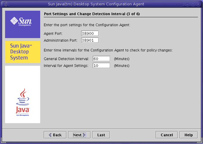

The Configuration Agent uses two ports:
Agent Port (DaemonPort): used by the agent to communicate with client applications (default is 38900).
Administration Port (DaemonAdminPort): used by the agent controller program, apocdct1, when communicating with the agent (default is 38901).
The Configuration Agent periodically checks for any changes in the configuration data using the following two intervals:
General Detection Interval (ChangeDetectionInterval): interval in minutes between the change detection cycles for the desktop application's (client's) configuration data.
Specifying -1 turns off change detection.
Interval for Agent Settings (DaemonChangeDetectionInterval): interval in minutes between the change detection cycles for the agent-specific configuration settings.
You can use the general detection interval to tune the propagation of remote configuration data changes to client side applications. The value provided for this setting is the maximum length of time in minutes that elapses before remotely made changes are reflected in the client applications.
Smaller values result in increased Configuration Agent and LDAP server activity. As a result, use caution when you adjust the value of the settings. For example, in an initial deployment phase, you can set the value to one minute so that you can easily test the impact of remote configuration on client applications. After you complete the testing, return this setting to the initial value.

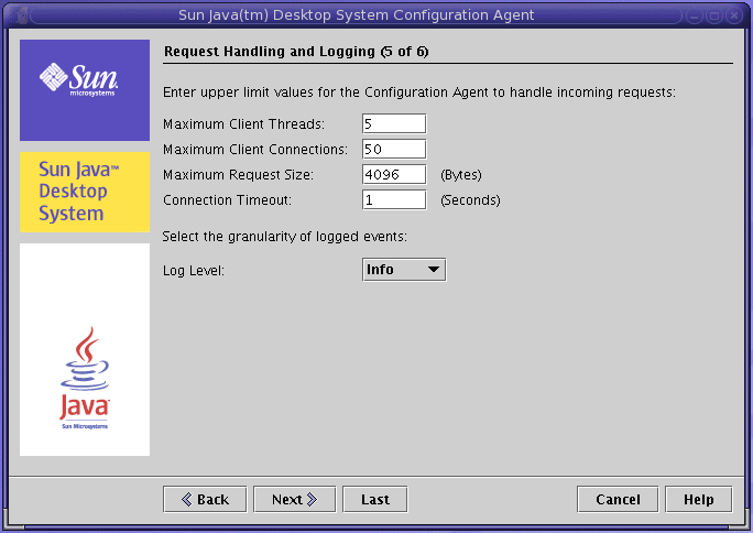

Maximum Client Threads (MaxClientThreads): maximum number of client requests that can be processed simultaneously.
Maximum Client Connections (MaxClientConnections): maximum number of client connections.
Maximum Request Size (MaxRequestSize): maximum size of client requests.
Connection Timeout (ConnectTimeout): denotes the allowed interval of the LDAP server to answer a connection request. The default is one second.
Log Level (LogLevel): level of detail in the agent log files. The logging level is consistent with the Java Logger levels. In order of decreasing severity, these levels are:
