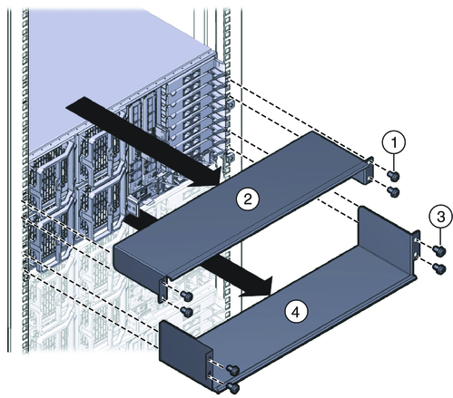

The shipping bracket kit consists of a front bracket, a rear bottom bracket, a rear top bracket, screws to connect them to the rack, and cage nuts to be used with the rear brackets on racks with square holes. These appear in How to Install the Shipping Brackets.
There might be two sets of screws stored on the front of the shipping bracket. Use the set that matches the threading on your rack.
They will be stored there in case you need to reinstall the shipping bracket.
