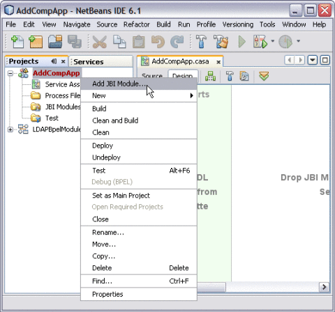

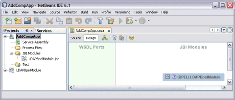

Create a Composite Application project.
Add the BPEL Module project (*.jar) as a JBI Module to the Composite Application project.
Build the Composite Application project. Ensure that the Application Server is started.
Deploy the Composite Application project to the Application Server.

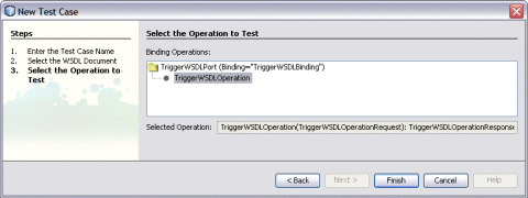

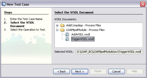

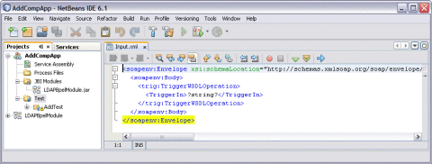

Create a Test Case.
Run the Test Case.

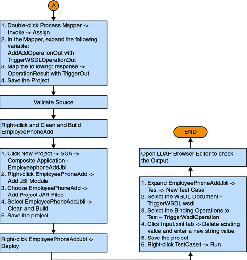

The following illustration explains the procedure of creating the LDAP BC tutorial project.
Flowchart 1
Flowchart 1 (Continued)

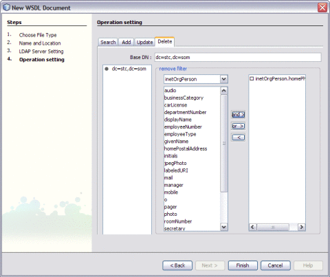

You can perform any one of following operations.
Search
Add
Update
Delete

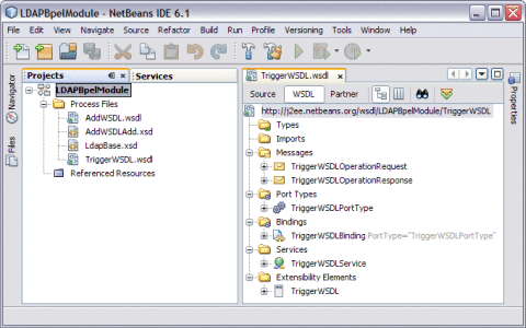

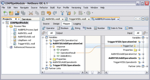

In this section, add a WSDL document, for example, TriggerWsdl.wsdl to the BPEL Module project. The Partner view of the WSDL editor to configure the components of the WSDL document.
Expand the project node in the Projects window. Right-click the BPEL Module node or Process Files node. Choose New —> WSDL Document...
For example, LDAPBpelModule
This opens the New WSDL Document wizard.
Type the File Name in the File Name field.
For example, TriggerWSDL.wsdl
Select Concrete WSDL Document.
binding
Defines the message format and protocol details for a port type.

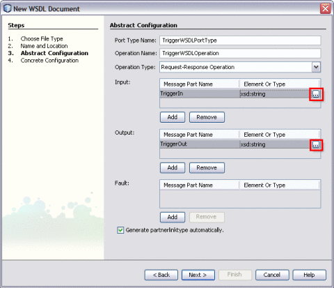

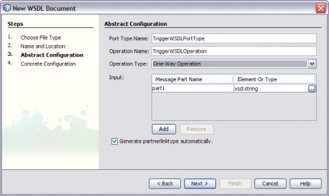

Choose the Operation Type from the drop-down list.
The WSDL Editor is used to create, edit, and delete port types.
The WSDL Editor supports the following operation types. There are two Operation Types.
Request-Response Operation: The operation receives a message as input, and sends a message as output.
One-Way Operation: The operation receives a message as input.
Each message contains one or more logical parts. Specify the name and the type of content for each part.
If you change the name of a port type or operation, then the WSDL Editor renames all occurrences in the same file. Right-click the component node to rename all occurrences in the associated XSD, WSDL, and BPEL files. Choose Refactor —> Rename.
When Operation Type is One-Way Operation. The following illustration demonstrates when the operation type is chosen as One-Way Operation.
Click the ellipses (...) button to select an Element or Type.
Enter both the Input and Output Message Part Names for the Request-Response Operation.
The default value of the Input and Output Message Part Names is set as xsd:string.
Click Add to another Message Part Name as the Input.
This selects the checkbox Generate partnerlinktype automatically.
Click Remove to delete the Message Part Name as the Input.
Select Operation Type : Request-Response Operation from the drop-down list.
Port Type Name and Operation Name are populated from the previous wizard.
Click the ellipses (...) to select the Element or Type.
Enter a Message Part Name for both Input and Output — TriggerIn and TriggerOut, respectively.
This action displays the Select Element or Type dialog box.
Retain the same values for Element or Type both for Input and Output as xsd:string.

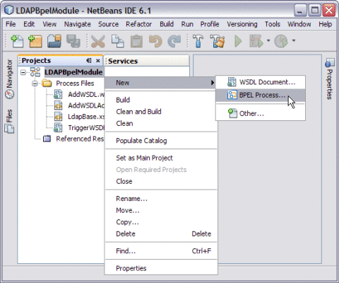

In this section, add a BPEL process file. For example, AddBPEL.bpel. You will also learn to add a partner link and associate three activities to the BPEL process file. Create a BPEL Module project to orchestrate.
Expand the project node in the Projects window. Right-click the node or Process Files node. Choose New —> BPEL Process...
This opens the New BPEL Process wizard.
Type the Filename in the File Name field.
For example, AddBPELProcess
Click Finish.

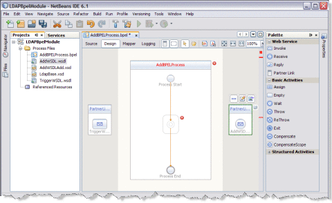

In the Projects window, the IDE adds a AddBPELProcess.bpel node under the Process Files node.

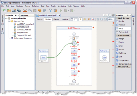

The AddBPELProcess.bpel file is open in the BPEL Designer.
The BPEL Designer has two views: Source and Design.
The Properties window is open.
Choose Window —> Properties if the Properties window is not visible.
The Navigator window shows the BPEL Logical View of the BPEL Process document.

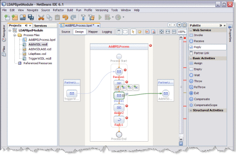

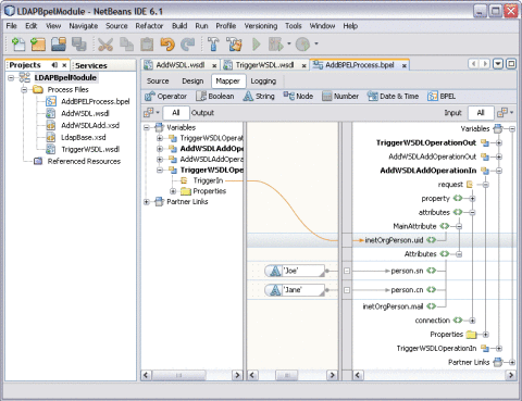

Select the Partner Link from the Projects tab. Drag and drop it to the left panel of the design area.
This is the Input WSDL.
Select the Partner Link from the Projects tab. Drag and drop it to the right panel of the design area.
For example, AddWSDL.wsdl
This is the Output WSDL.
Drag and Drop the following Web Services:
Receive
Invoke
Reply
Drag and Drop the Basic Activities : Assign.

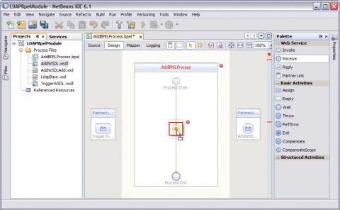

Select the Web Service : Receive in the Web Service section of the Palette.
Drag the selection to the box in the design area between the Process Start and the Process End activities.
For example, BPEL Process box : AddBPELProcess
The IDE provides the visual clues to show an appropriate location to drop the selection.
This action places a Web Service Receive called Receive1 in the Design view.

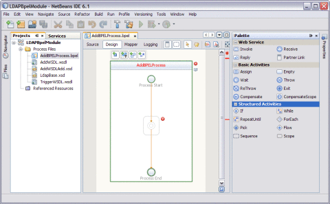

Select the Basic Activities. Choose Assign in the Basic Activities section of the Palette.
This action places a Assign activity called Assign1 in the Design view.
Drag the selection to the AddBPELProcess box in the design area, between the Process Start and the Process End activities.

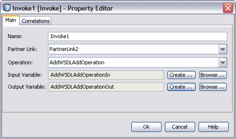

Repeat steps 1 through 4 to select Invoke1, Assign2, and Reply1.
Choose the following:
Select the Web Service : Invoke and Basic Activities : Assign.
Select the Web Service : Reply.

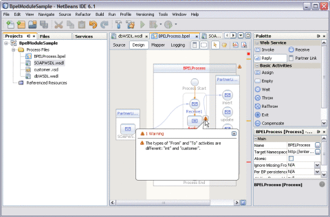

The icon symbolizes that the Web Services can be edited.

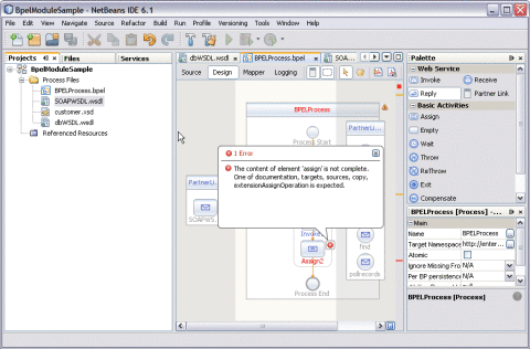

In the diagram, a red cross next to an element means that the element has not passed validation and the output contains errors. Edit each Sequence to pass validation.
Click Web Service — Receive1 and click Edit.
This opens the Receive1 [Receive] - Property Editor.
Select the properties of this service from the Main tab. Select PartnerLink1.
The Operation drop-down list refreshes to display TriggerWSDLOperation.

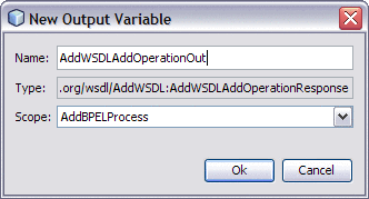

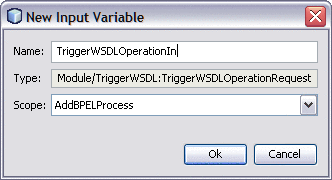

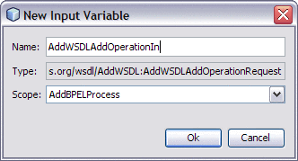

Create a new input variable.
Perform the following:
Click the Create button next to the Input Variable field.
This opens the New Input Variable dialog box.
The Name, Type, and Scope variable fields are refreshed with their default values.

Click Web Service — Invoke1 and click Edit.
This opens the Invoke1 [Invoke] - Property Editor.
Select the properties from the Main tab. Select PartnerLink2 from the drop-down list.
The Operation drop-down list refreshes to display AddWSDLAddOperation.
Follow these steps to create a new input and an output variable.
You can also change the value in the Name field.
Click OK to close the New Input Variable dialog box.
Click the Create button next to the Output Variable field.
This opens the New Output Variable dialog box.
Click OK to close the New Output Variable dialog box.
All the fields are populated with the assigned values.
Select the following Variables:
Input Variable : AddWSDLAddOperationIn
Output Variable : AddWSDLAddOperationOut
Click OK to close the Invoke1 [Invoke] - Property Editor.
Save the project.
Click Web Service : Reply1. Click Edit.
This opens the Reply1 [Reply] - Property Editor.
Select the properties from the Main tab. Select PartnerLink1 from the drop-down list.
Follow the steps to create a New Output Variable.
Click OK to close the Reply1 [Reply] - Property Editor.
Double-click the Basic Activity : Assign1.
This displays the BPEL Mapper window.
Choose Window —> Other —> BPEL Mapper from the main menu if the BPEL Mapper window is not visible.
Expand the node in the Source tree pane (the left pane) of the BPEL Mapper under Output —> Variables.
For example, TriggerWSDLOperationIn
A Trigger1n node appears under the TriggerWSDLOperationIn node.
Expand the node in the Destination tree pane (the right pane) of the BPEL Mapper under Input —> Variables.
For example, AddWSDLAddOperationIn
A request node appears under the AddWSDLAddOperationIn node.
Select the node in the Source tree pane. Drag the selection and map it to the node in the Destination tree pane.
For example,
Source tree pane: TriggerWSDLOperationIn — Trigger1n
Destination tree node: AddAddOperationIn — request — attributes — MainAttribute — inetOrgPerson.uid
Map the following:
TriggerIn — inetOrgPerson.uid
Click Save All.
Select request — attributes — Attributes
Select person.sn.
Click String and select String Literal from the drop-down list.
Enter the values in the String Literal and map the String Literal with person.sn.
For example, person.sn = Joe, where sn = surname and person.cn = Jane where cn = common name
Similarly, select person.cn and follow steps b and c.
Click Save All.
Click the Design tab.
A red icon marked against Basic Activities — Assign1 is not shown.
Double-click the Basic Activity : Assign2.
Expand the node in the Source tree pane (the left pane) of the BPEL Mapper under Output — Variables.
For example, AddWSDLAddOperationOut
Expand response — OperationResult.
Expand the node in the Source tree pane (the right pane) of the BPEL Mapper under Input — Variables.
For example, TriggerWSDLOperationOut
Map the following variables
For example, OperationResult — TriggerOut
Click Save All.
The final output is as shown in the illustration.
Right-click the BPEL Module and select Clean and Build.
The following message is displayed.
BUILD SUCCESSFUL (total time: 3 seconds). |
Click Save All.
Add the JBI module to the deployment project before deploying the BPEL Module project. Deploying the project makes the service assembly available to the application server. This allows its service units to execute their functionality.
Choose File —> New Project.
This opens the New Project wizard.
Select the SOA node from the Categories list.
Select the Composite Application node from the Projects list.
Click Next.
Type the Project Name in the Project Name field.
For example, AddCompApp
Click Finish.
The Projects window now contains a project node for a Composite Application project named AddCompApp.
Click the Validate XML button.
This action invokes an XML check and displays the following message in the XML check console.
XML validation finished. |
Right-click either the Composite Application or the JBI Modules.
For example, AddComositeApp
Select Add JBI Module.
Select the BPEL Module Project. Click Add Project JAR Files.
In the current example, the Project JAR file is build/SEDeployment.jar.
The JAR file is added and is as shown in the illustration.
Click Save All.
Ensure to following services are started.
GlassFish Application Server
JBI Binding Component (sun-ldap-binding)
Right-click the Composite Application node. Select Clean and Build.
The CASA Editor displays the build associated with AddCompApp.
A success message is displayed in the Output window:
BUILD SUCCESSFUL (total time: 3 seconds) |
Click Save All.
This section lists the procedure to deploy the composite application.
Start the Sun Java System Application Server before deploying the project.
Right—click Composite Application project node from the Projects tab.
For example, AddCompAppl
Select Deploy.
After successful deployment of the project the Output window displays the following message:
BUILD SUCCESSFUL (total time: 13 seconds). |
This section lists the procedure to test the deployed application.
Expand the Composite Application project. Click Test.
Right-click to select New Test Case.
Enter the Test Case Name.
For example, AddTest
Click Next.
Select the WSDL Document.
Select one WSDL Document from the BPEL Module.
In the current example, the WSDL Document is TriggerWSDL.wsdl and the BPEL Module is LDAPBpelModule — Process Files.
Select one WSDL Document.
Click Next.
Select one Operation to text file from the Process Files.
In the current example, the Operation to Text file is TriggerWSDLOperation and the Process File is TriggerWSDLPort (Binding=”TriggerWSDLBinding”).
Select one Operation to Text file.
Click Finish.
This displays the Source code.
Enter the string value.
string = Jane
The Output console displays Retrieve.xml when you enter a string value in the input.xml window.
Right-click the Test Case and click Run.
A confirmation dialog box prompts to overwrite an existing Output.
Click Yes.
The Output is as shown in the illustration.

The Design view displays the results of both real-time and explicit validation in callout windows on the diagram and the error stripe.
In the illustration,
A red cross next to an element on the diagram means that the element has not passed validation and the output contains errors.
A yellow triangle with an exclamation mark means that the element has not passed validation and the output contains warnings.
A red cross in the Design view means there are both errors and warnings.
If you click the cross or the triangle, a callout window lists errors and warnings.
The callout window displays messages related to validation in accordance with the criteria listed above. Messages related to real-time validation are constantly updated.
In the Design view, the error stripe displays the validation results. The error stripe is a strip to the right of the scroll bar that contains red marks if some elements have not passed validation. The error stripe represents the entire diagram, not just the portion that is currently displayed. This stripe helps users to immediately detect any errors in the BPEL process without having to scroll through the entire diagram. Click a red mark to jump to the element that causes problems. If no errors are detected, the small square in the error stripe is green.

In this section, the user sets the Delete feature.
For steps, see the following links:
Create a WSDL Document For Type : SOAP.
Click the Delete tab.
In the current example, the selected Object Class is inetOtgPerson.
Remove Filter
Select Remove Filter — inetOrgPerson from the drop-down list.
Select the entry from the Remove Filter list.
For example, uid
Click the > arrow.
inetOrgPerson.uid = is moved to the right pane.
Click Finish.
