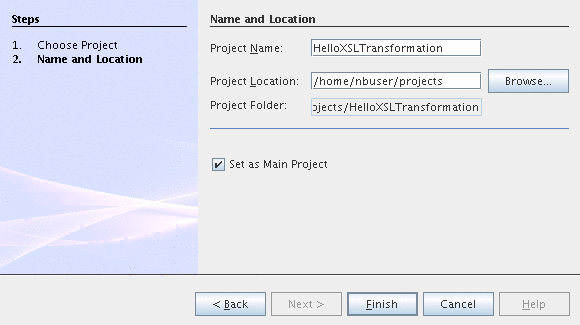

In the Project Name field, type HelloXSLTransformation .
Modify the project location, or accept the default.
Click Finish.
