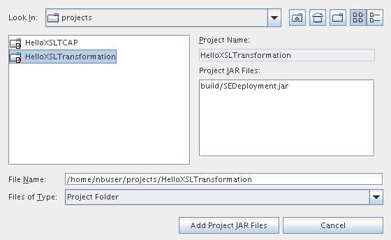

Right-click the HelloXSLTCAP node and choose Add JBI Module from the pop-up menu.
Select the HelloXSLTransformation project and click Add Project Jar Files.
To verify that the JBI module has been added, expand HelloXSLTCAP > JBI Modules.

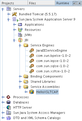

To verify that the project has been deployed, expand Sun Java System Application Server 9 > JBI > Service Assemblies in the Runtime window. You should see the HelloXSLTCAP node.
