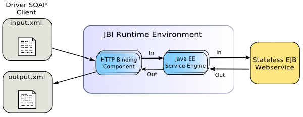

This tutorial is designed to showcase the Java EE Service Engine's functionality. This example is designed to show how the Java EE Service Engine implements a Web Service from a WSDL file accessing it through the HTTP Binding Component.
We will create a Composite Application so that Java EE SE will be used in the service and we will then run a test case to test our service. This tutorial also uses the features of the HTTP Binding Component.

The following sample illustrates how Java EE Service Engine implements a Web Service from WSDL.

In the Output.xml tab, according to this tutorial example, the result should have a string as shown in the figure below.
