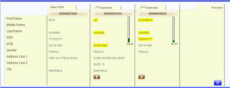

Figure 47 Potential Duplicate Comparison Page
Figure shows two potential duplicate profiles displayed
in a side-by-side comparison.

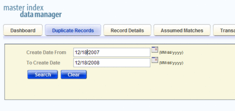

  3. Do one of the following:
    1. To search by date range only, enter the date range in the basic search fields and then click Search.
    2. To use additional criteria for the search, select Advanced Search from the Search Type field, enter your search criteria, and then click Search.

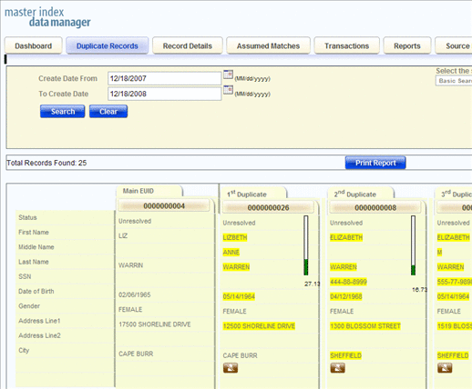

    Figure 49 Potential Duplicate Search Results List
    Figure shows the results of a Potential Duplicate search.

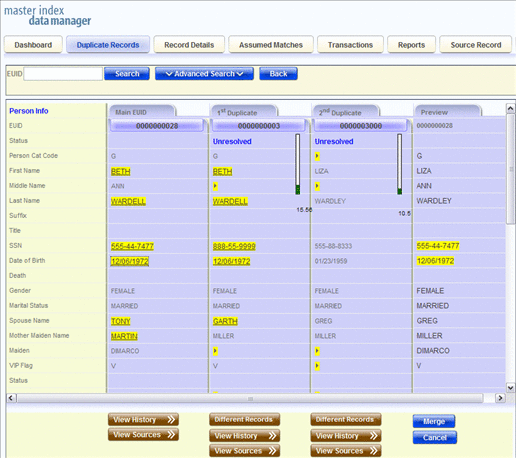

  3. On the Duplicate Records comparison page, determine which of the displayed profiles you want to keep and then click the EUID of that profile.
  4. Click the EUIDs of any other associated profile you want to merge into the profile you selected above.
    Each profile changes color to indicate it is selected.
    Figure 50 Duplicate Records – Selecting Profiles to Merge
    Figure shows two potential duplicate records selected
for a merge.
  5. Under the far right column, click Preview.
    The merge preview profile appears, allowing you to view the profile as it will appear after the merge.
    Figure 51 Duplicate Records – Merge Preview Profile
    Figure shows the merge preview profile for two potential
duplicate profiles.
  6. Compare the field values in the profiles to be merged to determine which values to populate into the kept profile. Click any values you want to keep.
    Note –
    Selecting a value to keep in the merge result profile creates a link from the SBR to the source record field that populated the field. For example, if the first name field from Record A is populated from Source Record 1, and you merge Record A into Record B and select the first name value from Record A, alink is created from the first name field in the resulting SBR to the first name field in Source Record 1. For more information on linking SBR fields to source record fields, see Overriding the Survivor Calculator's SBR.
  7. Review the merge preview profile, and then click Merge to finalize the merge.

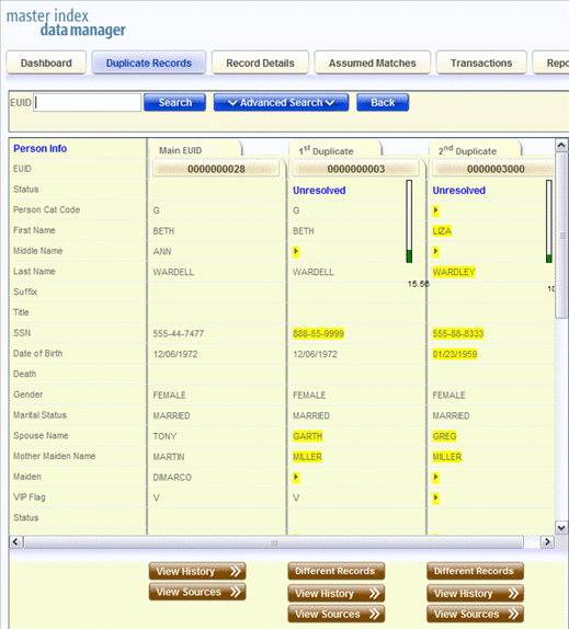

    The results list displays key identification fields that might provide enough information for you to determine whether the profiles should be resolved.
    Figure 52 Duplicate Records Search Result Entry
    Figure shows an entry in the results of a Duplicate Records
search.
  2. Scroll through the results until you see the profiles you want to resolve.
  3. Beneath the duplicate profile you want to resolve from the Main EUID (the profile in the far left column), click Different Records.
    Tip –
    The Different Records icon is the brown icon beneath each profile.

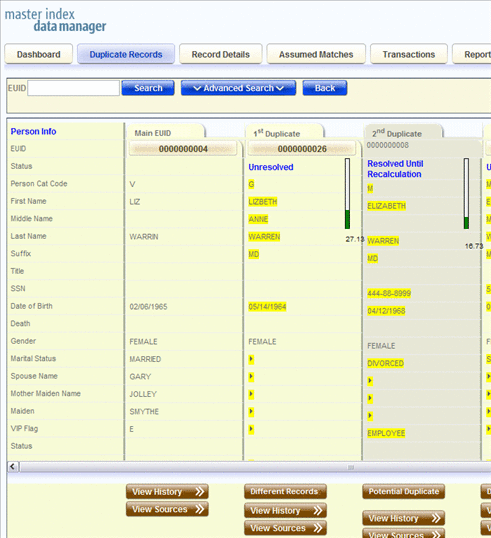

  2. Beneath the duplicate profile you want to resolve from the Main EUID (the profile in the far left column), click Different Records.
    A confirmation dialog box appears.
  3. On the confirmation dialog box that appears, do one of the following:
    • To flag the potential duplicate profiles as resolved but still allow the potential duplicate listing to be reinstated in the future, select Resolve Until Recalculation.
    • To flag the potential duplicate profiles as resolved and never allow the potential duplicate listing to be reinstated, click Resolve Permanently.
  4. On the confirmation dialog box, click OK.
    The status of the potential duplicate entry is changed to Resolved and the profiles are no longer regarded as possible duplicates of one another.
