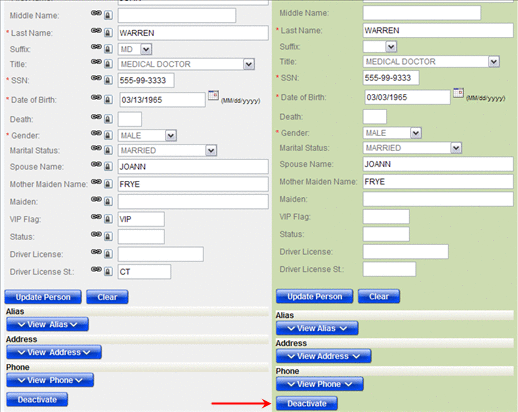

If an existing local ID for an object becomes obsolete, you can deactivate the source record with that local ID for the object profile. An object profile must have at least one active local ID; if you deactivate an object’s last active source record, the entire profile is deactivated. When you deactivate a source record from an object profile, the survivor calculator determines what changes, if any, should be made to the SBR.
You can deactivate a source record from the Record Details page, where you can view the source record within the context of its profile.
Figure shows a source record to be deactivated.
ProcedureTo Deactivate a Source Record (by EUID)
  1. Using one of the search methods described in Searching for Object Profiles on the MIDM, display the object profile containing the source record you want to deactivate on the Record Details page.
  2. At the bottom of the page, click Edit.
  3. Below the source record you want to deactivate, click Deactivate.
  4. Click OK on the information dialog box that appears.
    The page refreshes and the SBR for the object profile containing the source record is recalculated based on the new information.
