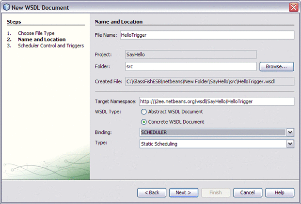

  1. From the Project tree, right-click the SayHello node and select New -> WSDL Document.
    The WSDL Document Wizard appears.
  2. Enter HelloTriggers as the file name.
  3. Select Concrete WSDL Document as the WSDL type, and select SCHEDULER as the binding.
    Image shows the WSDL Document Wizard with settings to
create a SCHEDULER Binding.
  4. Click Next.

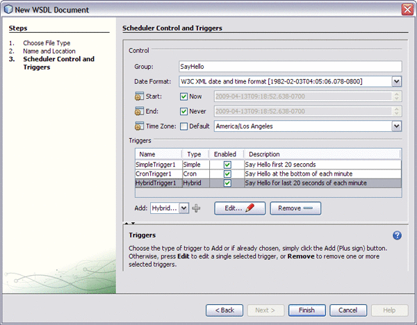

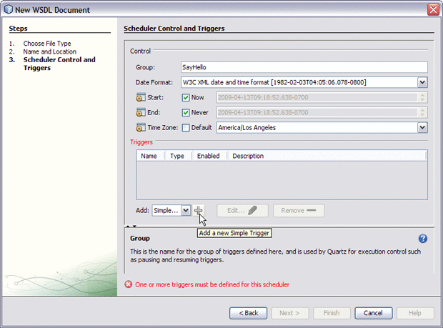

    The Scheduler Control and Triggers Wizard appears.
  5. From the Scheduler wizard's Add field, select Simple. Click the plus sign next to the Add field to open the Add New Simple Trigger dialog box.
    Image displays the Scheduler Control and Triggers Wizard
  6. From the Add New Simple Trigger dialog box, add the following values:
    • Name: SimpleTrigger1
    • Description: Say Hello first 20 seconds
    • Repeat: 4
    • Interval: 5
    • Message: Hello first 20 seconds
    Image shows the Add New Simple Trigger dialog
box as described in context
    This creates a trigger that sends the message “Hello first 20 seconds” and repeats it four times in five second intervals for a total of five messages.
  7. Click Add Simple Trigger.
    SimpleTrigger1 is added to the Triggers field.

  11. Now create a Hybrid trigger. Change the Add field value to Hybrid and click the plus sign next to the Add field.
    The Add New Hybrid Trigger dialog box appears.
  12. From the Add New Hybrid Trigger dialog box, add the following values:
    • Name: HybridTrigger1
    • Description: Say Hello for the last 20 seconds of each minute
    • From the Second (1) tab, select Just on Second: and select 40 as the value. Leave remaining tabs at their default values.
    • Duration: 20 Seconds
    • Repeat: Indefinite
    • Interval: 5
    • Message: Hello for the last 20 seconds of each minute
    Image shows the Add New Hybrid Trigger dialog box as
    This creates a trigger that sends the message “Hello for the last 20 seconds of each minute” every five seconds, from second 40 through 59 of each minute, indefinitely.
  13. Click Add Hybrid Trigger.
    HybridTrigger1 is added to the Triggers field.
  14. Click Finish to create the new WSDL document.
    Image shows the New WSDL Document Wizard containing three
triggers
    The HelloTriggers WSDL document is added to the SayHello Project's process files.

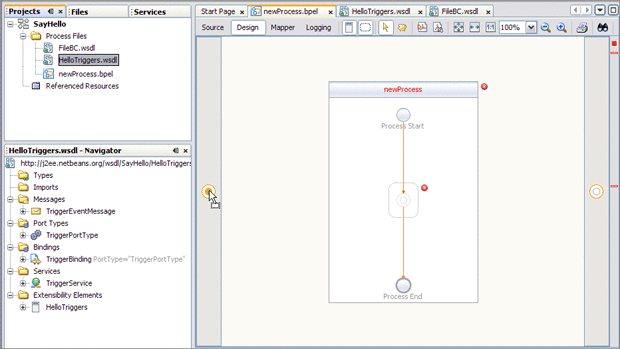

  1. From the Projects window, double-click newProcess.bpel under your projects Process Files.
    The BPEL Designer opens to the new file.
  2. From the projects tree, drag and drop HelloTriggers.wsdl to the middle of the Ports column on the left side of the BPEL Designer. A “drop-zone” appears, as a prompt.
    Image displays the BPEL Designer as described in context
    A Partner Link is created.
  3. In the same way, drag and drop the FileBC.wsdl file to the drop-zone in the right column of the BPEL Designer.
    Another Partner Link is created.

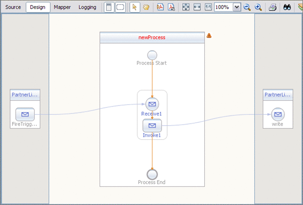

  4. Create a Receive web service.
    1. From the BPEL Designer Palette, drag and drop a Receive web service to the drop-zone between Process Start and Process End in the middle of the BPEL Designer.

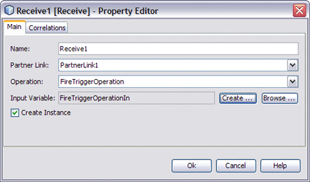

    2. Click the Receive activity's Edit icon.
      The Receive1 Property Editor appears.
      Image shows the Receive1 Property Editor
    3. Select PartnerLink1 as the Partner Link value.
    4. For Input Variable, click the create button. The New Input Variable dialog box appears. Click OK to accept the current values.
    5. Click OK. The BPEL Designer now displays the Receive activity associated with PartnerLink1
  5. Create an Invoke web service.
    1. From the BPEL Designer Palette, drag and drop an Invoke web service to the drop-zone just below the Receive Activity in the middle of the BPEL Designer.

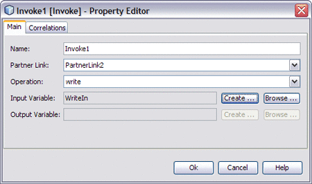

    2. Click the Invoke activity's Edit icon.
      The Invoke1 Property Editor appears.
      Image shows the Invoke1 Property Editor
    3. Select PartnerLink2 as the Partner Link value.
    5. Click OK. The BPEL Designer now displays the Invoke activity associated with PartnerLink2
      Image shows the BPEL Designer as described in context

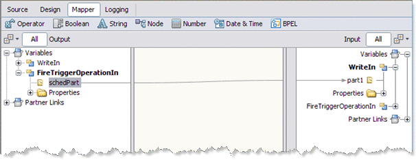

  6. Drag and drop an Assign activity to the drop-zone between the Receive activity and Invoke activity.
  7. Double-click the Assign activity to open the BPEL Mapper.
  8. Map SchedPart, under FireTriggerOperationIn in the Output pane of the Mapper, to part1, under WriteIn in the Input pane of the Mapper. To do this, click the SchedPart node in the left pane of the Mapper, and drag it to WriteIn in the right pane of the Mapper. A line now associates the two nodes.
    Image shows the BPEL Mapper as described in context
  9. Click Save All.

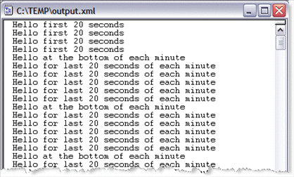

  3. Open your project's output file, for this example C:\TEMP\output.xml. The output appears similar to the image below, depending on when the project is started.
    Images shows the SayHelloCA Project's output as described
in context
    As you can see from the output, the Simple trigger fired for 20 seconds only, producing the first messages, the Cron trigger fires once at the bottom of each minute, and the Hybrid trigger fires the last 20 seconds of each minute.
