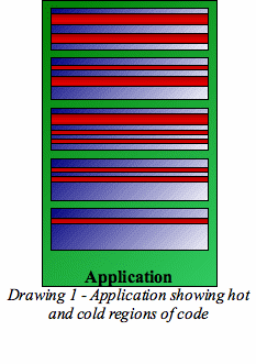

An application will have many instructions, code has to be written to cover all eventualities - even those that rarely (and perhaps never) happen. A consequence of this is that most applications end up with a set of instructions that do the work, and a lot of other instructions which have to be there, but are never used. The drawing 1 shows a way of visualising this. The green rectangle represents the whole application, within this application there are a number of routines. Within each routines there are instructions which are frequently executed, these are coloured red, and instructions that are rarely executed, these are coloured blue.
The rarely executed instructions take up space in memory, and also in the caches, and often on the on-chip memory. For example a single cacheline may contain a mix of hot and cold instructions, the cold instructions will just take up space, and consequently the application will have to use more cachelines to hold the code. It is also possible that due to the layout of the code in memory, some of the useful code may try to occupy the same place in the cache as some other useful code - this is known as thrashing in the cache; this results in only a limited set of the critical instructions being available at any one time.

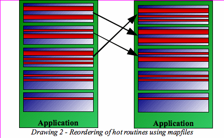

One approach to improve the situation is to use mapfiles. Mapfiles are a facility that tell the linker how to layout routines in memory. To use these to improve the layout of the code it is necessary to order the routines from the most frequently used to the least
frequently used. The drawing 2 shows our original program from drawing 1 laid out from hot routines to cold using a mapfile.

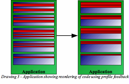

The drawing 3 shows how profile feedback can rearrange code within a routine to put the frequently executed code together.

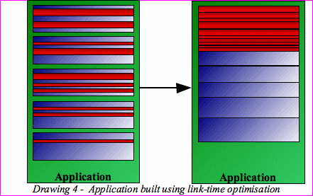

The principal of link-time optimisation is that the compiler has done its work, the code exists, and all that is necessary is to lay it out appropriately. In laying the code out appropriately, the link-time optimiser will sort the routines so that hot routines are placed together (in a similar way to mapfiles), and also lay out the code within those routines so that hot instructions are placed together. However, it is possible at link-time to go beyond this:
Since the hot code has been identified, it is possible to place all the hot-code together, and then place all the cold code together. The idea being to remove all cold code from the hot region – placing code from different routines into the same region of memory.
It is also possible to do further optimisations since the addresses of variables and routines can be calculated exactly. Hence the link-time optimiser can simplify expressions which calculate the address of variables or routines -- this further reduces the instruction count.
Drawing 4 shows what an application will look like after it has been link-time optimised. The hot code will have been grouped together in one part of the binary, and the cold code in a separate part.
