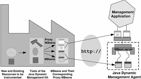

Figure 3–1 summarizes these tasks, from crafting MBeans in your factory to deploying them through the web.
